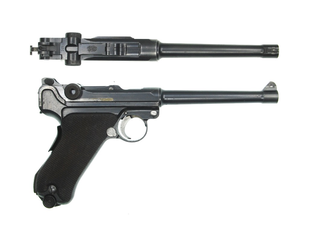

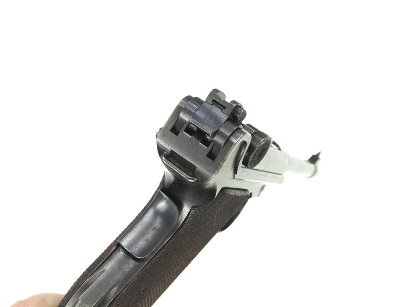

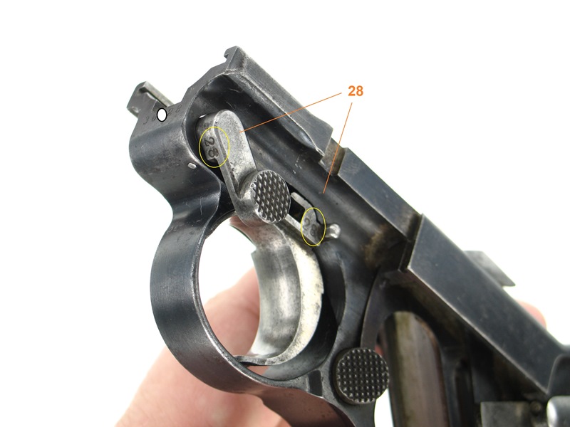

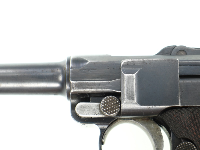

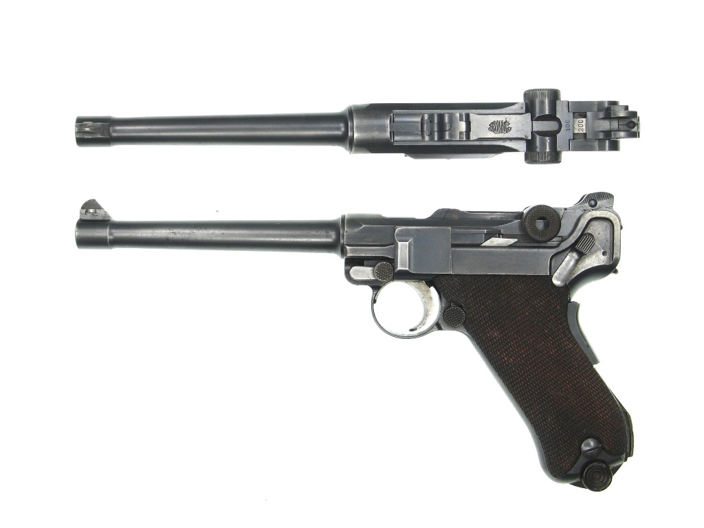

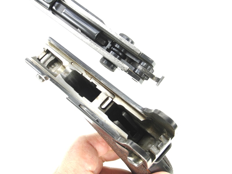

I request an expert opinion
on this luger, which has a handle lock (type 1906)
but it has a short frame
I think it's commercial ... his number is 36XXX
what do you think?
can it be have a piece of great value ???
oddly matched, safety handle with short frame.
I cannot insert an image ... I can send images by e-mail ... tell me an e-mail by private message, I send the images and I authorize you to put them in this message.
Thank you

Navy marked Lugers are renowned for being faked. You'll need to provide sharp well lit photos (shaded natural light, camera that can focus) including closeups of markings.
Our FAQ document may be useful.
Perhaps one of the Navy experts can help with your photos. You should be able to upload pictures using the advanced version of the editor. Just size them to about 1024 pixels on the longest axis.

Thank you very much for placing the photographs
It is absolutely original, it has no parts replaced ... I have enough experience in detecting tampering.
Excuse me for not putting a full number image in front of the frame, and under the barrel (it is for privacy requested by the owner)
But they are original, same typeface, ect …
Could it be a commercial Navy exported to Uruguay?
look

Hi Antonio,
Welcome to the forum! I think you're right, it sure looks like a Uruguayan contract gun or one produced at about the same time. This link might be of interest.
https://luger.gunboards.com/showthre...t=uruguay+navy
Regards, Norm

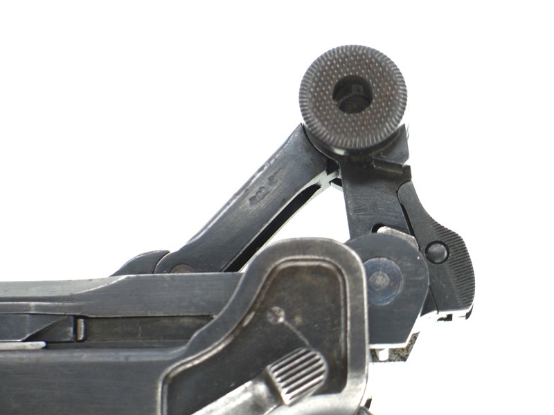

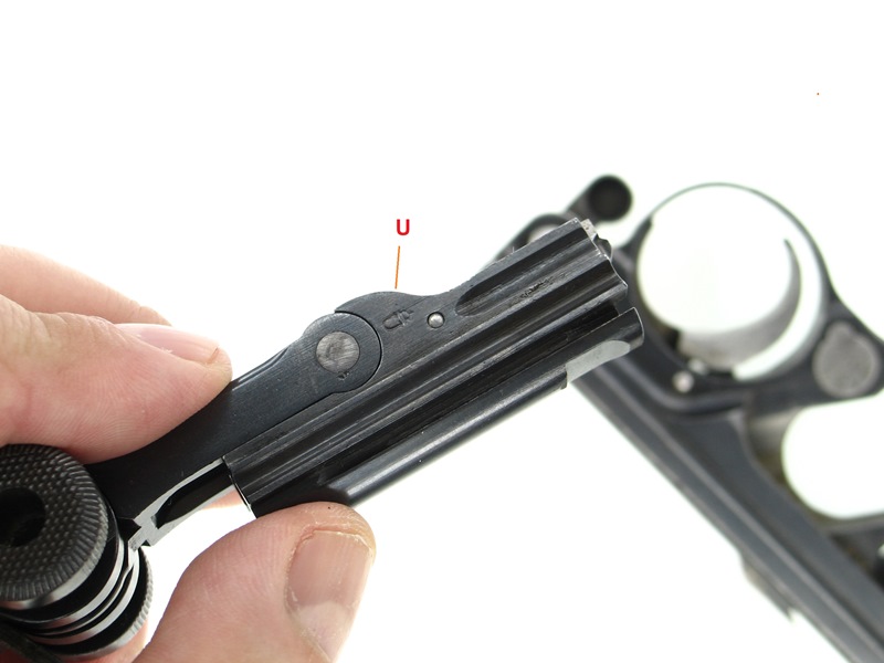

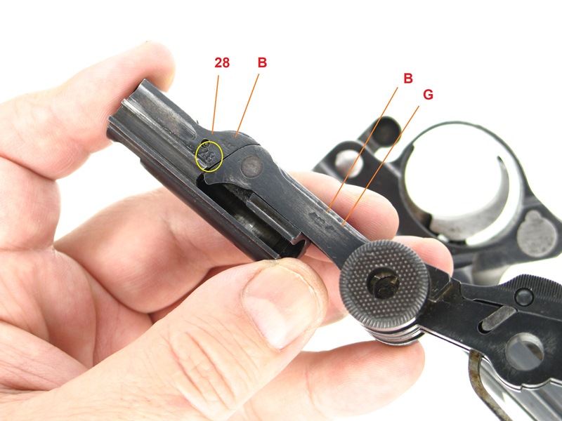

I'm not a Navy expert.
Why is there a Crown/B Crown/V on the rear toggle/sight?
Were those Uruguay acceptance markings; Imperial German acceptance markings on parts that were diverted to a commercial contract; or something else?

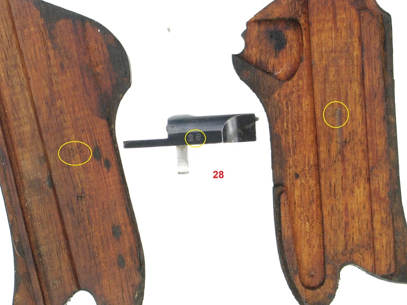

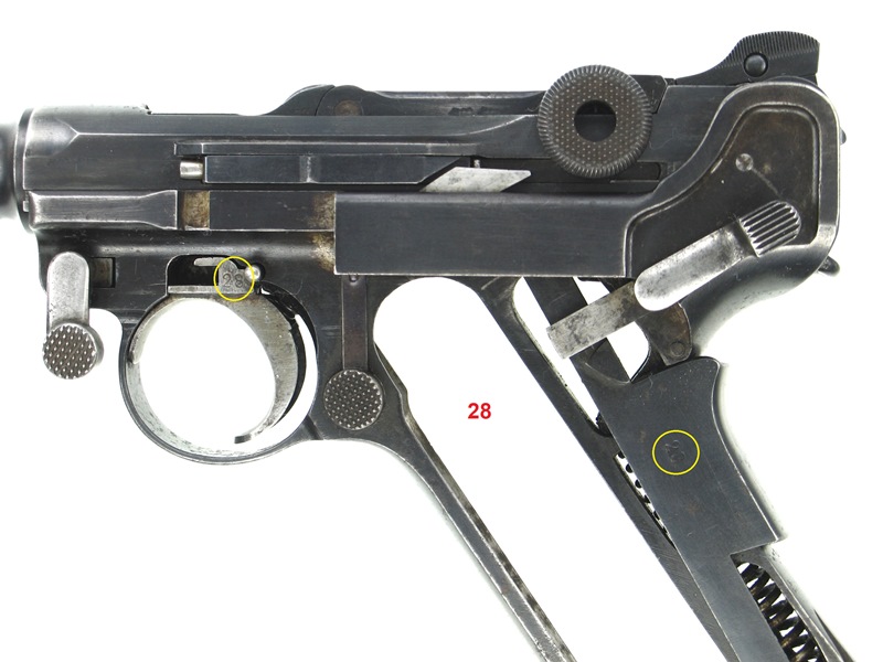

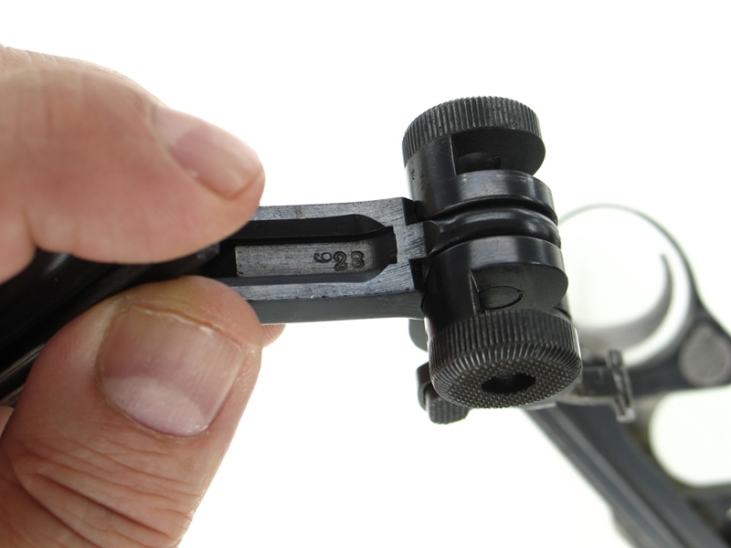

Is it numbered in the commercial pattern (digits on bottom of trigger plate, etc...)?
Thanks for posting an interesting Luger.
Unread 03-28-2020, 09:01 PM   #7
Marc,

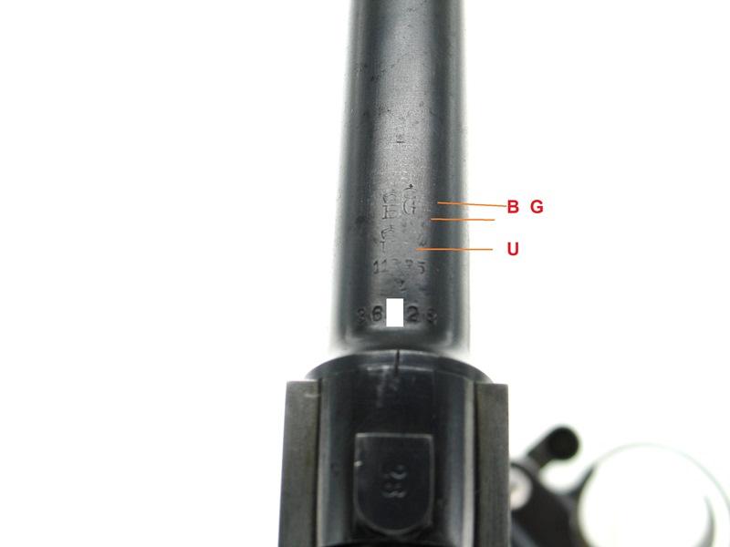

I think they are C/B and a worn C/U (not V); and are commercial German proofs not Imperial military.

new images on the way
B G U ….. 118,35
German commercial barrel proof. Found (with proof 3) on some 9 m/m 1902 thru 1908.
definitely
It is a DWM 1906 URUGUAY NAVY COMMERCIAL LUGER
