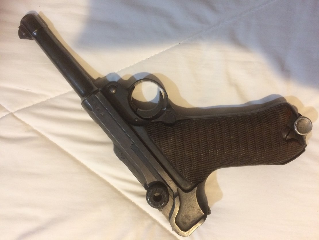

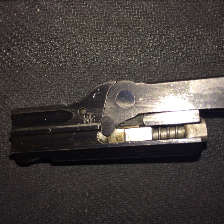

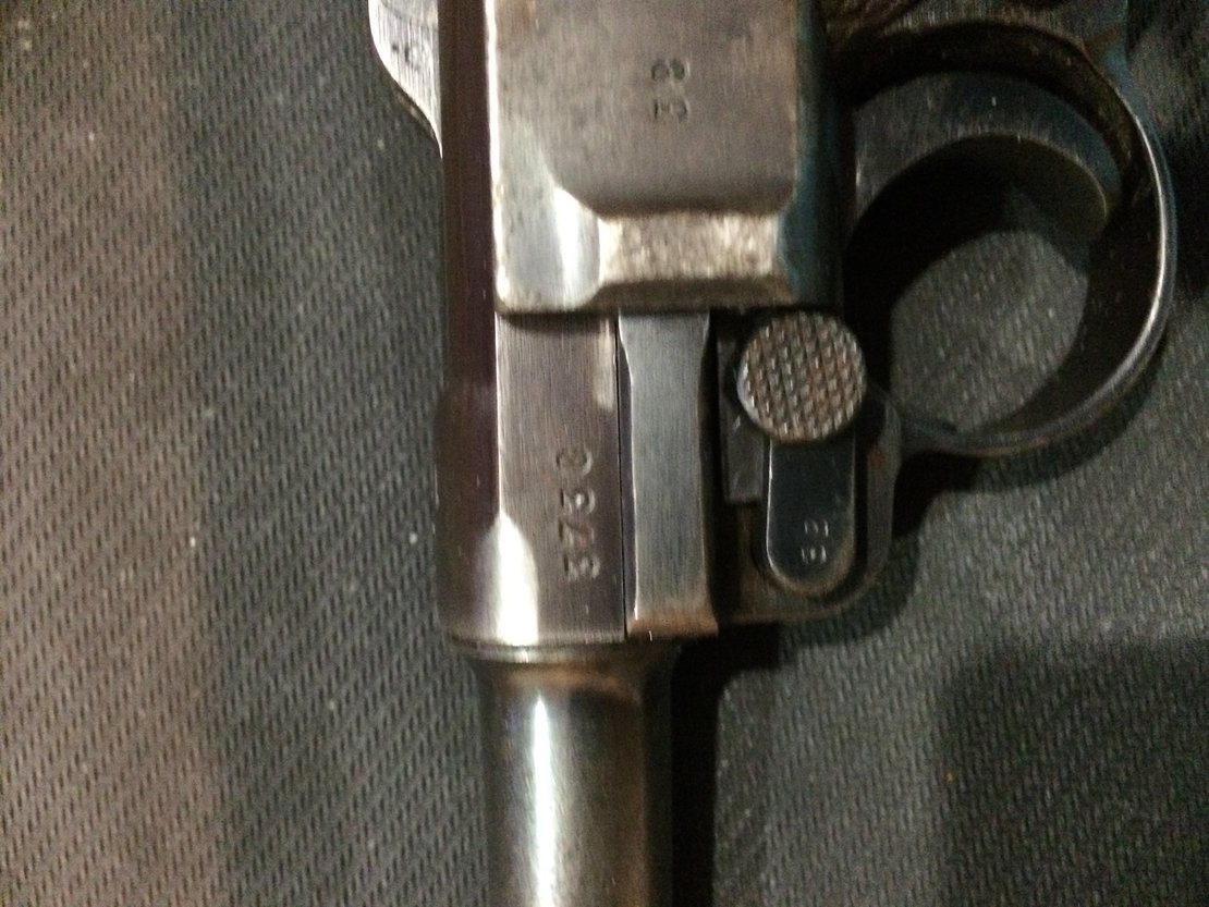

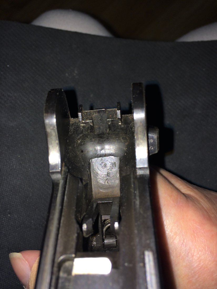

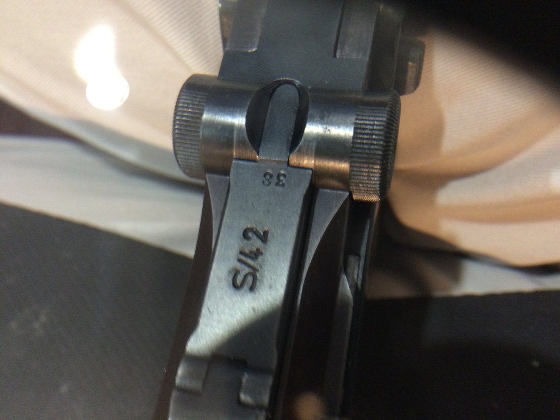

I am now the proud owner of a P08 that belonged to my wife's uncle who served during WW2 in Germany and brought this back with him at war's end.
As you will see from the pictures shown here all parts (with the exception of the magazine) are unique to this weapon.
Since I am new to this forum I would like to know the possible value (although I doubt I'll be selling anytime soon) and also why it is so difficult to pull the toggle all the way back to the full open position.

Welcome aboard, and that is a very nice Luger that you have inherited. The photos are a bit dark to see much detail, but everything looks good from what I can see.
A ballpark WAG for a 1938 Luger, average to maybe a bit better than average, matching except the magazine, would be around $1500.
Nothing is jumping out at me as far as why it may be unusually difficult to cycle at the rear. Make certain that the safety is off and try it without the magazine just to eliminate drag as the culprit. (I would ask others to look closely at the breechblock in the last photo.) Does it otherwise function correctly, dry fire, live fire, etc?

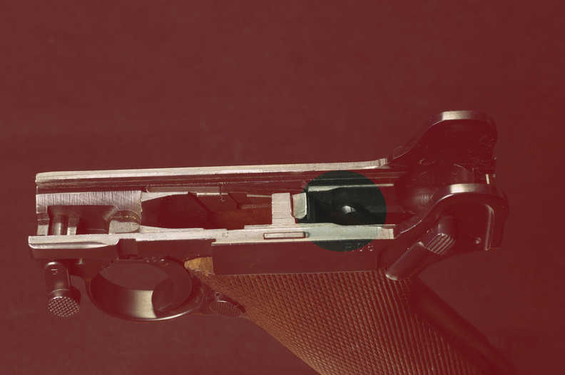

Double check that the little hooks on the lever that attaches to the recoil spring have properly engaged with the "S" shaped linkage on the toggle train in the receiver. if this misses the hooks, things can go wrong.
On first glance, your Luger looks to be all matching and in original finish. If this is true it would be considered collectible. Look at the inside of the trigger plate for the numbers "37" or "38". That plus the last digits of the serial on the outside confirms it's original to the pistol.
Be sure that the dissassembly locking bolt at the front of the frame is properly installed, and not binding or blocked when in it's horizontal position. There is a little flat slightly "L" shaped spring that holds it in the operate position.

dju - I tried cycling the toggle with and without the magazine (safety off). Same amount of effort. I haven't live fired it yet and maybe not ever. I have dry fired it multiple times and it fires OK.
gunbug - I cleaned and oiled it but didn't feel any difference cycling the toggle. When I had it stripped down I tried to actuate the recoil spring by hand and found it hard to move upward.
mrerick - the little hooks appear to engage properly. you mentioned the "disassembly locking bolt at the front of the frame is properly installed, and not binding or blocked when in it's horizontal position.
There is a little flat slightly "L" shaped spring that holds it in the operate position. I'm not sure what you mean by this could you sent me a pic?

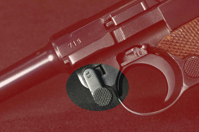

Only the end of the little "L" shaped spring is externally visible. The other end is below the serial number around the curve on the frame.
This is the locking bolt I'm talking about:

The pistol is probably operating normally. A lot of folks are not used to the toggle action and find it awkward to hand cycle. The recoil spring is somewhat stiff, and needs to be.

I concur with the above statements about how tight they are. When I first got mine it seemed so heavy at first. So long as you don’t feel or hear metal grinding I wouldn’t worry about it.

So... are you still having problems cycling the Luger? Is it clean? Lubricated properly?
While handling, ensure it's unloaded.
Try cycling the Luger with the safety off and the magazine removed. Is it binding somewhere?

Probably that pistol only needs a good cleaning, soak it with BALLISTOL, then after a few hours brush it properly with an old toothbrush then wipe it.
If it's all matching do not shoot it.
Congrats on your heirloom.

mrerick - I did clean it but probably not as well as I should have. I also lightly oiled it before I started posting. I don't feel any binding anywhere just hard to cycle by hand.
I'll take 'luger.parabellum" recommendation and buy some BALLISTOL and clean and oil it again.

The recoil spring on Lugers is stiff, and needs to be that way. If one is not familiar with the proper method of cycling the cannon assembly(bolt, etc.) it will seem quite awkward, and difficult. The Luger is markedly different from cycling a 1911, Sig, S&W auto, etc., and it just takes a bit of practice. If you can cycle the Luger with little effort, you have a out of spec Luger, and one you do NOT want to fire.
