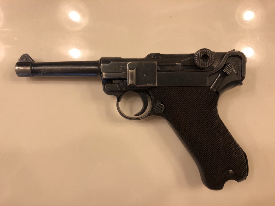

Hello all! New user here. I wanted to get some help from you pros on my most prized possession. My grandfather fought in wwii in France. He brought back with him many guns but this one being the best in my opinion. All matching serial numbers, It even had the matching magazine, which has been lost unfortunately.
I was hoping you could educate me on where it was made and anything of historical importance you think I should know about it. I have read there were straw and blued versions and I don't know which I have honestly. And if anyone could educate me on what each stamp represents that would be a bonus. Thank you in advance!

Welcome, Sean, Your S/42 was made in the latter half of 1937, the year which Mauser changed from rust bluing to hot salt bluing. Its frame was made by Mauser and not DWM stock moved from Berlin to be used up first, evidenced by the "Mauser hump," the swelling on the top portion of the back ends of the barrel extension. It looks like an honest war-horse to me. Enjoy your family heirloom!
Wow! Thanks for the info. Is there a way to tell the difference between the two bluing processes?

The easiest way to tell the difference is the trigger and safety lever are a golden/brown color, aka "Straw", on the earlier guns, and blued on the later guns. Hard to describe the differences in blue, experience helps there. Try going to Simpson, Ltd, and visually compare pre-1937 vs. post 1937 guns. If I had to try and describe the differences, I'd say that the rust blue is slightly lighter, more "gray" than salt blued guns.

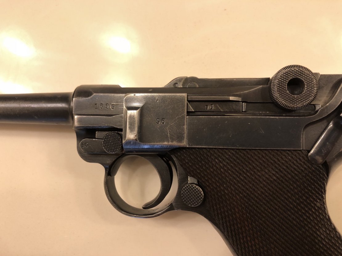

As an FYI, your Takedown Lever Spring is missing.
Never even noticed! Does it insert into the right side of the frame on the other side of the locking lever?
No, you must first remove the lever. The spring will lie in a channel for it on the bottom of the boring for the lever. Put an empty mag into the gun and pull back the action to lock it open. The lever will rotate at this point. If the spring is missing entirely, the lever should just about fall out. If a functional spring is there, the lever won't come out unless you take it out. Once the lever is removed, you'll see the spring or its remnants, or no spring. It may simply have a short "leg" which isn't readily visible in the tiny hole from the outside. In this case, The lever will rotate from locked to unlocked and back without a tendency to fall out. But if it is missing after all, or in pieces, score one from lugerdoc. And, of course, check the FAQ for guidance in installing the replacement. It's not difficult, but there are tips to make it less tricky in the discussions about the process. When you're done, you'll say, "Piece of cake."
Noted. Thank you! I ordered a triple k replacement mag for now. I'll have to wait until it gets here before I can do a takedown

Sean, welcome to the forum. Congratulations on your excellent family heirloom WW-II bring back Luger.
Here's a link to our FAQ document:
http://forum.lugerforum.com/showthread.php?t=13121
It has a wealth of detailed Luger information, and it's free from our forum.
If you have a holster that goes with the Luger, look in the magazine pocket. It might be with the holster.
If you find it, don't store the Luger in a leather holster.
You have a Mauser made Luger. It was produced in Mauser's building "D", at Oberndorf an Neckar, Wurttemberg, Germany. This is South and West of Stuttgart.
Your Luger was made later in 1937, and has both the rust blued finish and the "hump" shaped Mauser Luger frame. These are very well made pistols.
The stamps are military contract inspection and acceptance markings and proof marks.
You can disassemble and re-assemble the Luger without a magazine. Just be careful and don't lose parts.
The takedown lever spring is a small flat "L" shaped spring with a section in the center milled away in a curve. Tom (LugerDoc) can provide some for you. Don't try and shoot the pistol without this part properly installed.

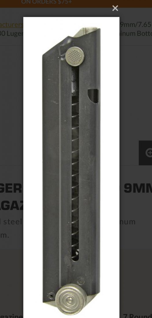

The Triple-K mag is probably a mistake, unless you use it just for display. Mec-Gar makes the best Luger replacement magazines; Greg Cote has them in stock. GT here on the forum can dress it up for you, and even make improvements, if desired.
I should say I THINK it's a triple K. It actually doesn't specify on the site. I had triple k on the brain cause i was looking for Magazine for the enfield. I attached the photo they have on the site.
