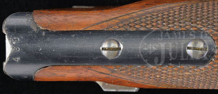

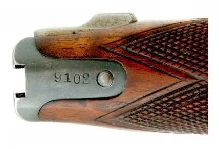

I could only find two pics of the carbine numbers, one appears to be for the push-button attachment, the other the lever-lock. (Oddly, they are consecutive).
But the numbers are on the bottom of the irons. And left-to-right. The pic that was posted some weeks ago had the numbers top-to-bottom, but I don't recall if it was a carbine or an artillery buttstock...

Ah, I see the problem, you blindsided me with a couple of ringers...you slipped in two quite rare examples that are marked differently than later examples. The two you show are the early "one screw" irons and the push button stock is only slightly more common than chicken molars. The later 1902 and 1920 carbines and the LP08 stocks are of the "two screw" variety and are marked like I said. Also, I may not be understanding your orientations...for the two stocks your show you note that the numbers are "left to right"...to me they are top-to-bottom (lengthwise). When I said "left to right" I meant "across" like Eric's #31.

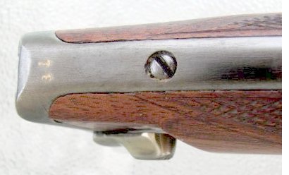

![]() OK, here's one...So, this is 'normal'??? The tang is 10mm wide, extrapolating the size of the numbers gives me ~2.7mm height...

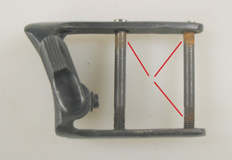

![]() I found a rather alarming condition when I removed my stock iron from my carbine stock. It was last removed/replaced when I finished BOL'ing my buttstock [see Gonzo Carbine thread]. I had occasion today to remove all buttstock/forearm furniture and found that my clean through-bolts had rusted, inside the buttstock... ![]() The rusted areas don't show up well in the pic... Mulling over ways to protect them when the wood comes back...Maybe grease, oil, wax even??? ![]() The buttplate screws were still blued, no rust...Just the attaching iron through-bolts...A mystery, I guess...
I like my coffee the way I like my women... ...Cold and bitter...
| The following member says Thank You to sheepherder for your post: |
#13 |
Posts: 498
Thanks: 112
Thanked 156 Times in 98 Posts
have you tried this? https://en.wikipedia.org/wiki/Renaissance_Wax
| The following 2 members says Thank You to Ben M. for your post: |

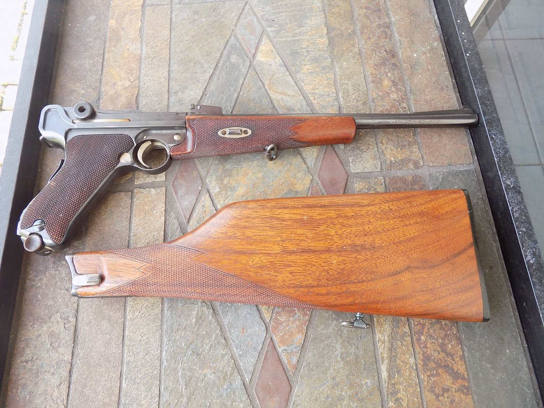

#3231t To dispel a common misconception. The 1920 model carbine was made with Imperial model left over parts of even salvaged because of the Weimar restrictions. The gun is perfect made for sale in the US and elsewhere, This one has "Germany" on the inside hidden tang. It uses a P08 frame as it has a rear sight not ever seen on any other model! It is the actual carbine on the cover of Luger Tips! Notice the rear sight!
