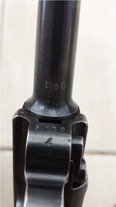

1. 1938 – year manufactured?

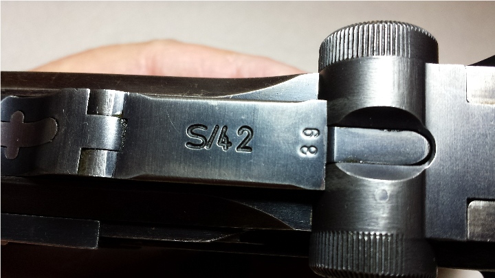

2. S/42 – Mauser manufacture Concealment Code? (What is a concealment code)
3. 5189 – Serial #?
4. b - ? (according to your listing it is probably an L and not a B
5. SE83 – SE63 – manufacturing inspection stamps? (What is the stamp next to these and on the barrel)
6. 5189 and 89 on various pieces – pieces are original manufacture?
7. Number under 5189 on barrel -? (8 82)
8. All matching – can you give me a listing of ALL PARTS that are numbered?

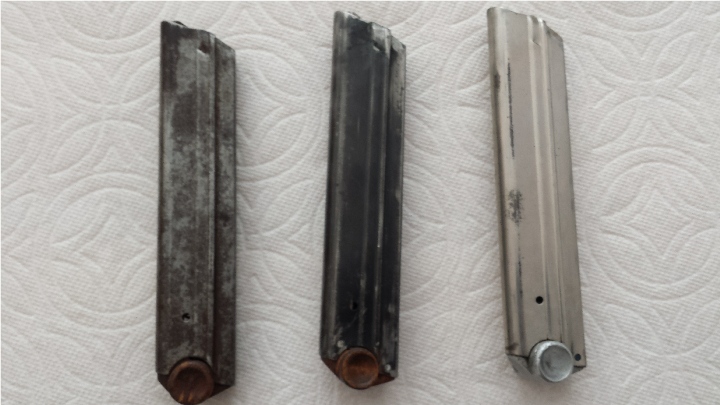

9. I have three magazines. Two with wooden bases one of which has the word GERMANY on the bottom and a 6 at the base of one side. And one magazine with an aluminum base with characters on it.

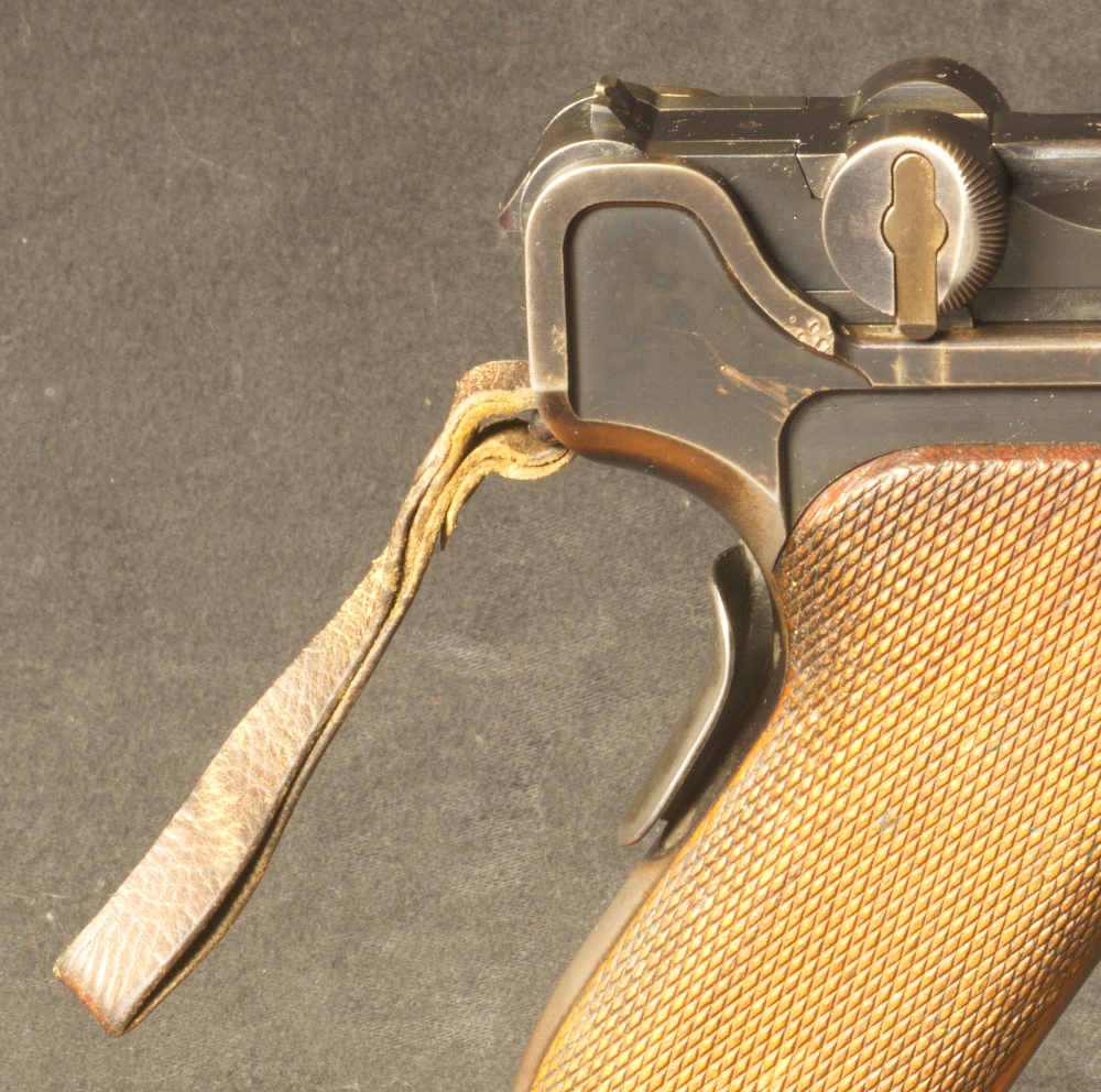

10. I noticed that on the butt of the pistol there is a small loop of metal. Was this for a lanyard in case of dropping the weapon would not be lost? I remember when I was on ships at sea that when we did familiarization firing with our pistols there was a lanyard we would put over our neck in case a person lost their grip on the weapon. Is this a similar safety feature?

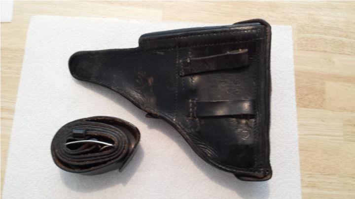

Lanyard loop is on rear, just below the toggle.
Germany marked magazine was for export, usually USA sales. An aluminum bass magazine is what would have come with your luger along with two matching numbered magazines.
Military security to hide manufacturers from the enemy
3. 5189 – Serial #?
Part of it. The suffix "b" is part of it too.
I'm thinking "b", but a better picture sharp and closeup would help http://lugerforum.com/lugermarkings/suffix2.html
Government military inspection acceptance stamps followed by a proof stamp.
Made and shipped with the luger. All matching is collectible. Also look for a "52" or "51" inside the trigger plate.
The 9mm bore measurement after gauging during the manufacture process (see the FAQ)
(See the FAQ)
OK... The only one that might be contemporary with the gun is the aluminum based one.
Lanyard loop. Generally not used. Early pistols had a short loop of leather to help facilitate removal from a holster.

Here's how the lanyard loop was used on my 1900 Swiss:
