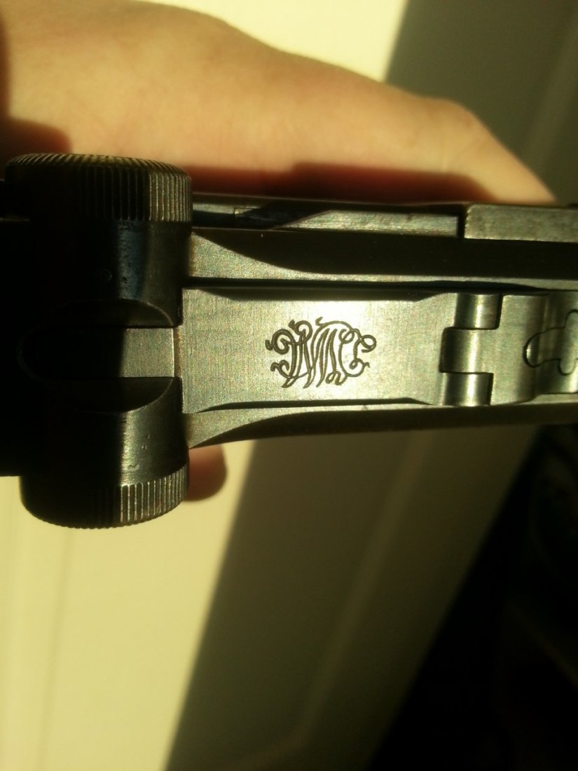

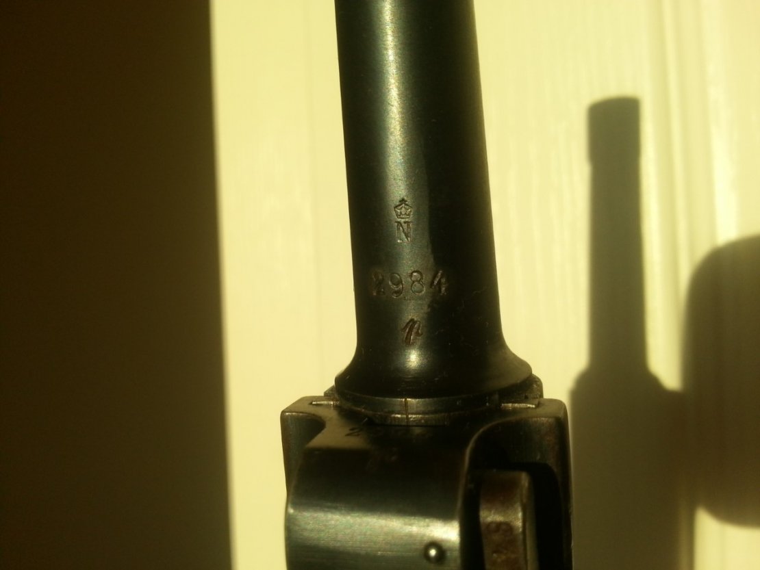

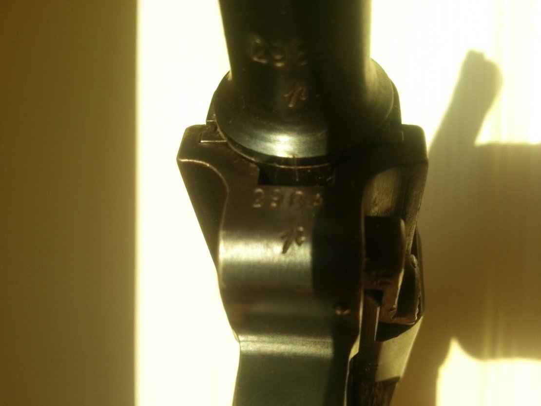

hi,
a co worker had a question on this piece,,yes bad pics and I know we need a pic of the top of the luger, but what do you guys think with the pics I have?
wondering what it could be and a ball park value,,what else should I be looking for?
I have the books,,and will continue to study but time is of the essence here so I'm kindly asking,,I appreciate it!

Looks like a "1920" alphabet commercial- p suffix block.
Need more pictures, 9mm or .30?
Unread 01-24-2017, 07:50 PM   #3
words help almost as much as pictures
caliber - any other markings - condition - etc
ballpark is $700-$900 - could be more - could be less if mismatched, parts missing, etc

Yep understood guys,,this is all I got to work with right now,,
will try to get more pics,,have not seen it in hand,,I assume its 9mm,,but I guess its something
to look for
Thanks again for any help!
2984 p ...Wouldn't that be military???
Unread 01-24-2017, 11:00 PM   #6
Would a commercial number the rear toggle link like that or is it military?

I think Don and Ed got it right...It looks like a DWM Alphabet Commercial with a C/N proof on the barrel and matching frame numbers. S# 2984p made in 1926 according to Jan Still's Weimar Lugers. It's more than likely a 30 cal. We need a few more pics to be sure.
"2984 p ...Wouldn't that be military???" It's also in the commercial range.
"Would a commercial number the rear toggle link like that or is it military?" Yes, commercials are numbered on the rear toggle link.

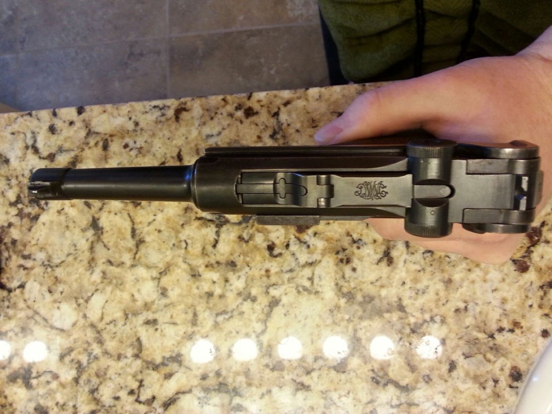

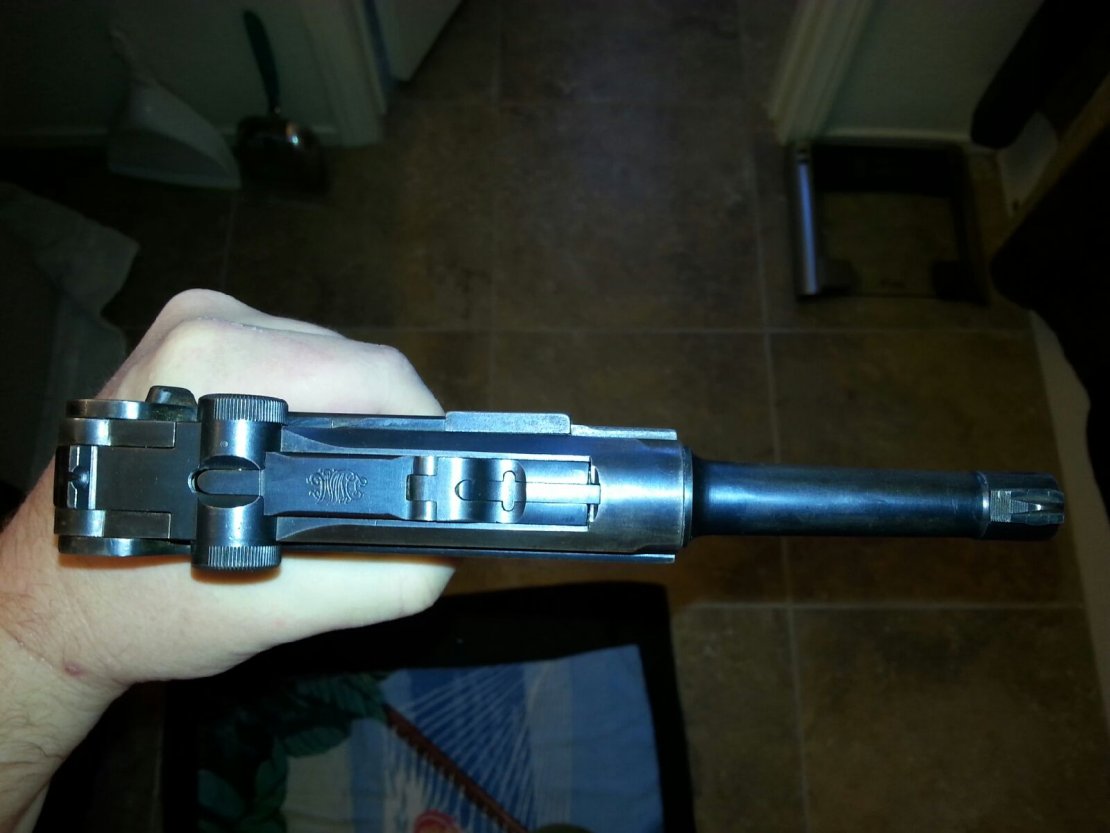

Default Some more photos
hers a few more photos and ID on this piece is helpful,,still dont know caliber, wondering if commercial or military?

Probably commercial; but need close ups of left and right sides of the chamber please.
Unread 01-31-2017, 11:58 PM   #16
Also show the muzzle from the business end.
