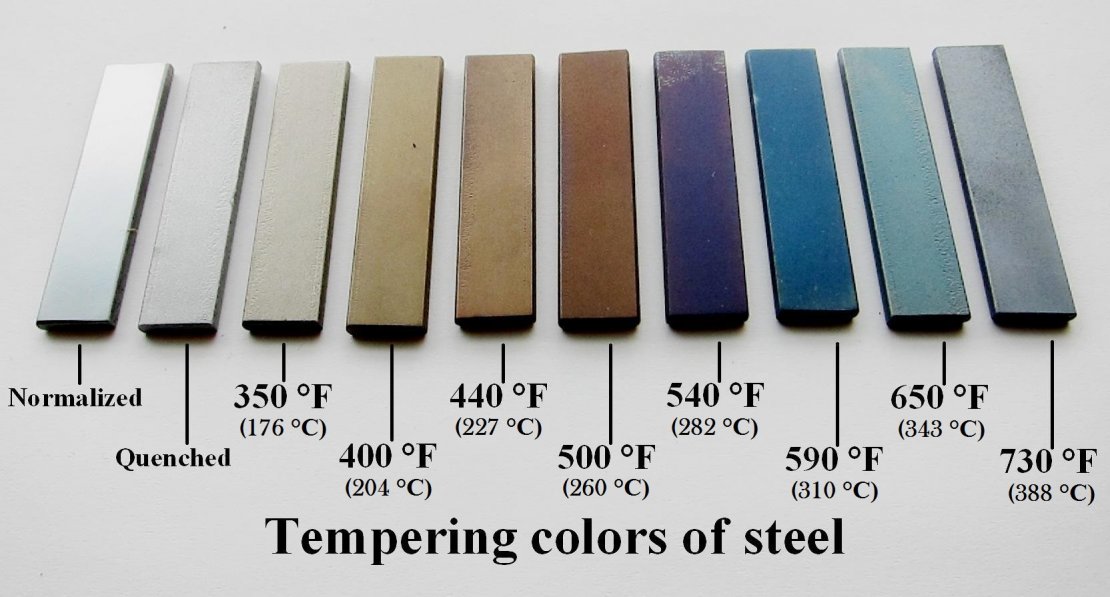

Here's how to establish the exact temperature for strawing parts inside your oven or toaster oven. Using a hotter temperature risks taking the color too far by overheating them. Once the color is established, there is no need to quench the parts, because they won't get any hotter than the exact temp. for strawing, which you've set.
I use a small container of sand as a buffer which will take on the oven temp. throughout its mass, which takes 30-45 min. Immersing the parts in question in the sand allows them, in turn, to take on the exact temp.--but no higher--after another 15-30 min.
Since most thermostats for such appliances are not exact, a little trial and error is in order, to establish the setting on the dial. Start out at perhaps 375, temper the buffer sand, then see what color a shined up part turns. The temp. can be increased gradually until perfect results are the outcome. Once the setting is established, make a discreet mark on your oven's dial so you can have the right temp. straight off, next time.
File Type: jpg Tempering_standards_used_in_blacksmithing.jpg (97.6 KB, 360 views)

That is a handy chart and info. Thanks !
I used the oil I did because it was handy and about like machine oil or 3 in 1 oil.
So, the oil does nothing to impart or affect the color in the end?
dnickels is offline   Reply With Quote
Unread 07-11-2016, 11:23 PM   #12
Posts: 3,403
Thanks: 7,569
That's right. Quenching is important during initial hardening, to cool quickly when the steel is hot enough to be non-magnetic. Ever notice when grinding on a shiny piece of metal that when it gets really hot, the same gradient in the pic emanates from the cut? The color is not much more, if any, than one molecule thick!
