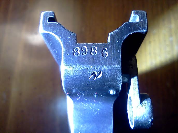

First off, a big shout out to all in providing the wealth of info found on this forum. I'm looking for a confirmation as to the suffix on my commercial .30 cal Luger. It looks like it may have been a partial strike of the letter stamp. I reviewed the script letters on the Technical information page, and luckily found a post directing me to further examples. I believe it is an "O", but I will defer to masses.

I'm no expert, but it looks like an "o" to me, as well.
I agree, it looks like it was not fully punched. |

I think it's a "O", but please give us some more details and close up pictures of the gun, oherwise a partial "O" or a partial anything else hasn't got much sense..

IMHO the suffix letter in this example is a "O"... after refreshing my mind with the suffix charts in the Technical Info section, I can't see how it could be anything else.

Still partial to that X myself, as shown on Gortz' chart. Unfortunately, the letter is a bit low, right on the radius of the curve, making for a difficult, full, strike.
Just my $.02, and besides, once we know the year, that may rule me out as well. dju |

AE, Your suffix letter is definately an "O". The alphabet commericals began production at 2000 i in 1923, so your O block pistol would be about 60,000 guns into the series (no J block) starting in 1923. If you assume a production rate of about 10K per year, that would make your pistol approximately a 1928 production. TH

Norm, I agree, but more info, markings, proofs, etc - would show us thats its not a WW1 example that was sent to the USA
more info is helpful |

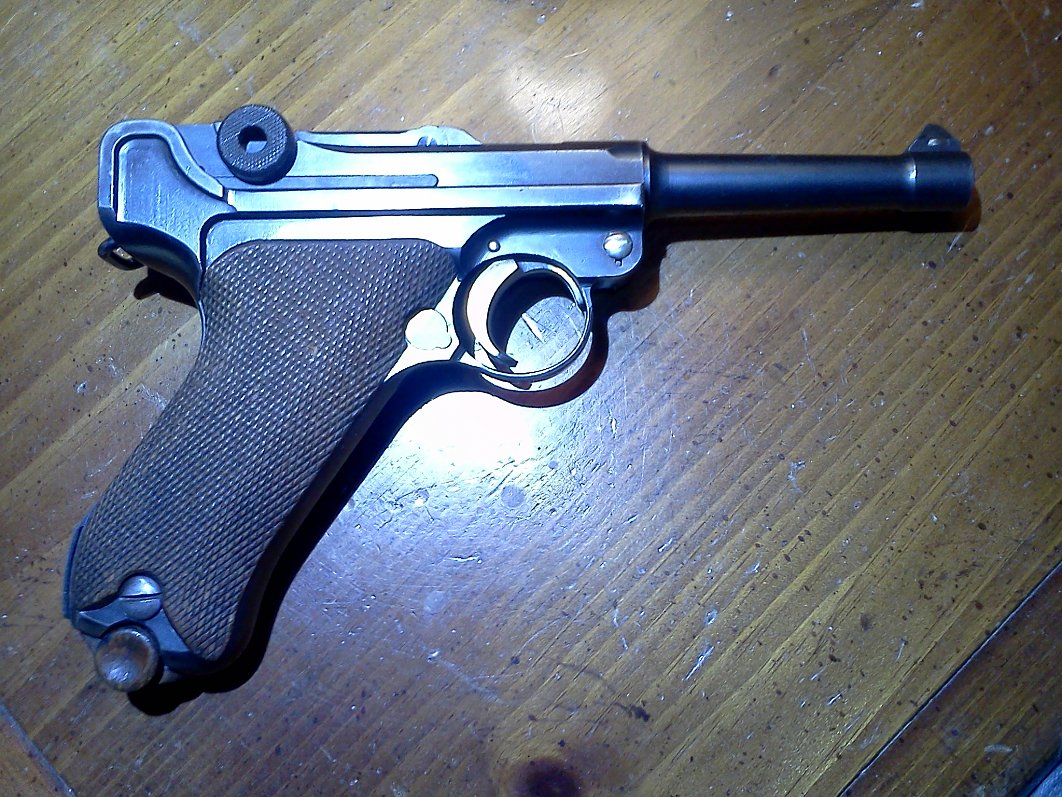

Thank you all for the quick responses. It is a DWM commercial in 30 cal. Seems to have the 86 stamped on the pieces that I can see. Vertical N with crown above take down lever and the same on the breechblock. I've attached a few pics, please let me know if you need a specific view.

I have a much earlier Alphabet Luger (i suffix) produced in 1921. On my Luger the suffix is not only on the frame, but also on the barrel below the serial number. I do not know if this was changed in later commercial production Lugers, but if not, your suffix should be there also. Someone will be along to educate me if the later commercial Lugers dropped this method of marking.

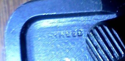

What is this?
I have never seen anything marked here before

I respectfully disagreed. The last three letters appeared to be "EED"
BUT A H H .... I see. It IS "GERMANY" in all caps but upside down!

o p q So, I would say since p was not used and q is questionable - that I agree with the above

Nice uncluttered looking gun. Sort of nice without all those markings...
