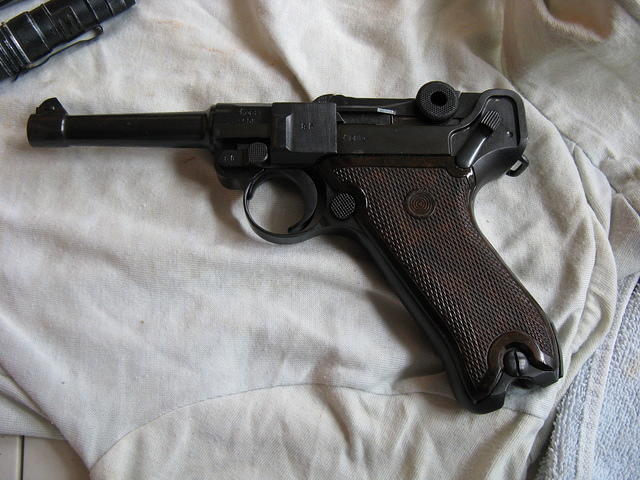

Well, this just got more interesting. The consignee made me an offer I couldn't refuse... I'll have this one later today.
Pictures when I can set things up.
This is as "pure" a captured and dipped gun as I've seen. Must have been an early Interarms import.
Here's a picture I shot at the store:

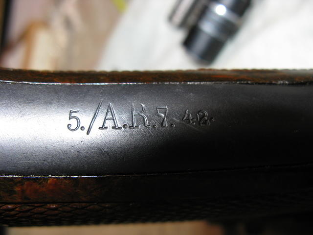

Anyway, I apologize Marc for getting everything off subject! Looks like a very nice vopo / is that a weimar army marking? Looks like WW1, but the rest is weimar.

The receiver is dated 1921. The unit marking is Weimar. An artillery regiment. As such, it is one of the last military Lugers made by DWM (before Simson & Co. became the sole supplier under the Versailles Treaty requirements). This Luger's number is high in the reported 1,500 that were shipped to military units by DWM.
Nothing looks like it was used in Police service during the Weimar or Nazi eras. No sear safety or magazine safety.
There is a mark above the Crown/U inspection marks that looks like a VoPo marks on both the frame and the receiver (left sides). I'll get better photos soon to show these.
There is a 1950s Suhl Crown/N on the barrel (which looks new, and was likely replaced and properly staked with a single witness mark); on the front and on the rear toggle.
One of the number matched magazines has a 1 on the base and on the bottom of the spine. It's a 2/1001 DDR manufactured Haenel Schmeisser milled magazine.
The other is an E/37 FXO marked magazine, numbered "2" on the base and numbered to the pistol. Both aluminum magazine bases look ground and renumbered.
There is an unnumbered loading tool also.
As I look closely at it, the dark blued finish looks too even to be a dip. The bluing is even, and the replacement barrel is highly polished. The edges all remain sharp.
