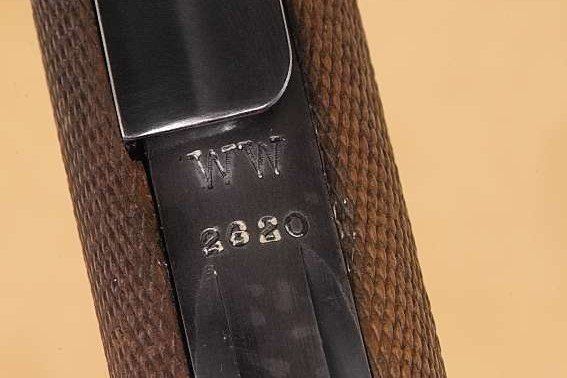

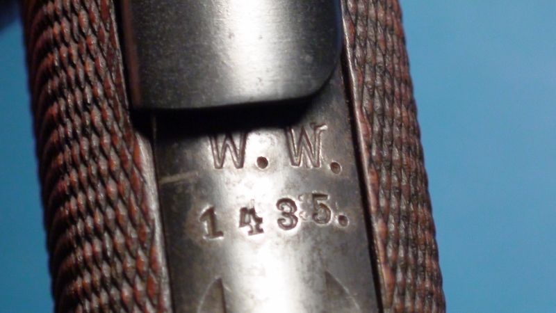

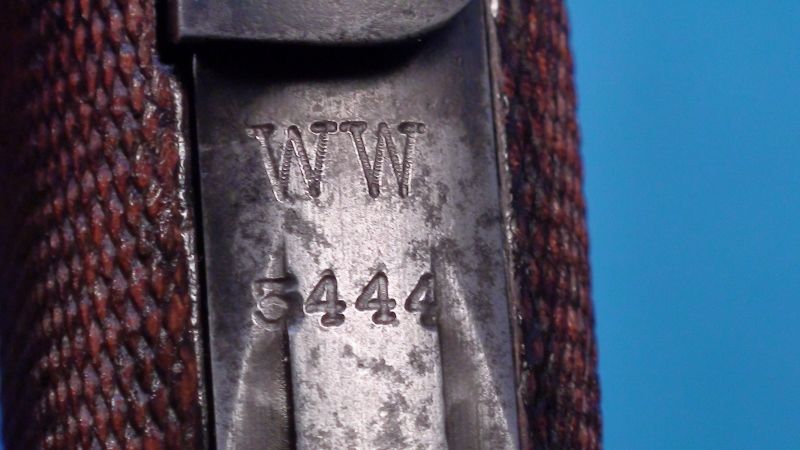

Hi Bill, If you're interested in this gun you should ask for more, and clearer photos, particularly ones of the receiver rails, magazine base and a close-up of the C/M marks on the left receiver. For what it's worth, the barrel serial numbers on guns this early should not have halos, they were numbered prior to bluing, and the W.W. marking (Werft Wilhelmshaven) looks correct also, these marks are almost always pantographed, like this one. All other Navy property marks were stamped.

and the W.W. marking (Werft Wilhelmshaven) looks correct also,?? Norm, I don't see any periods..as in W.W. marking . Looks bad to me.

Hi Jerry, Werft Wilhelmshaven property marks come with and without periods, without is more common.

Hi Jerry, I'm not saying this gun is OK, we simply need to see more and better photos. The property mark, however, does look original.
