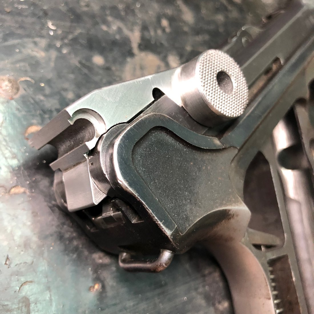

Next step is the making of a rear toggle with integral vindage adjustable rear sight.
Material is Swedish Uddeholm Calmax toolsteel That is really good against shock.
Spuhr is offline   Reply With Quote

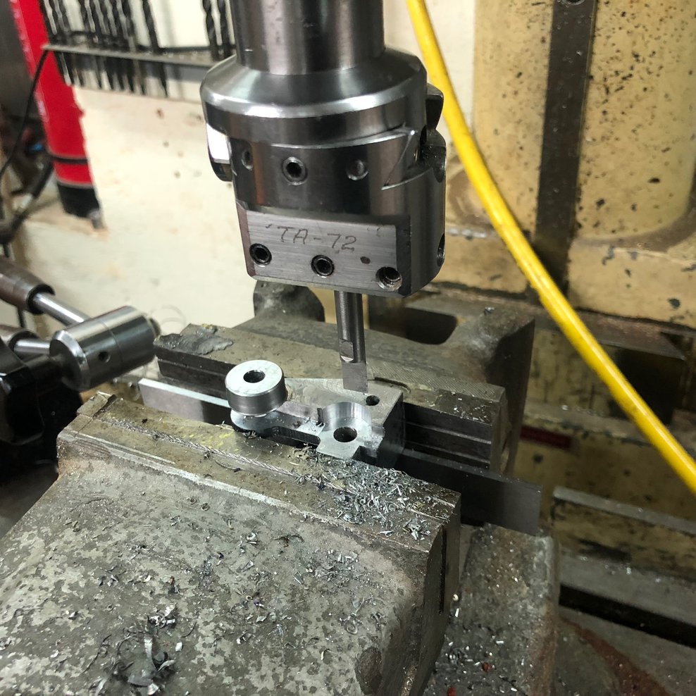

Here is the making of the sightsblade. All made in manual machinery and files.

Sightblade done
