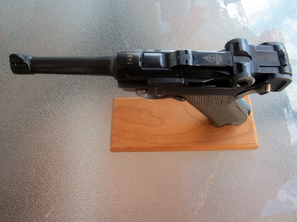

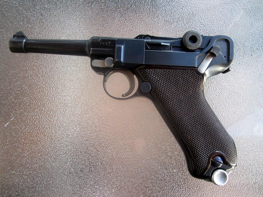

Default A 1937 For Comparison~
1937 #7932 ~~Eric

Two quick differences noted...
Not the same grips... different style. Eric's grips have a smooth border completely surrounding the checkering, and the pistol in question has grips that "appear" to have no top border...
Notice also that the milling marks in the safety lever recess are much more difficult to see than the prominent circles on the gun that is for sale...
Unread 03-20-2014, 10:35 AM   #14
Interesting to compare the lines around the "hump" on the side plates. MUCH clearer/sharper on the 1937 gun.

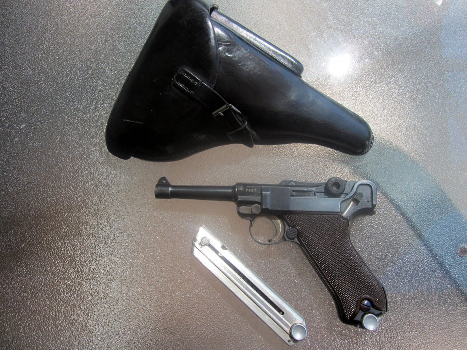

Default George Found Me This Beautiful Holster~
Never seen another this good!
