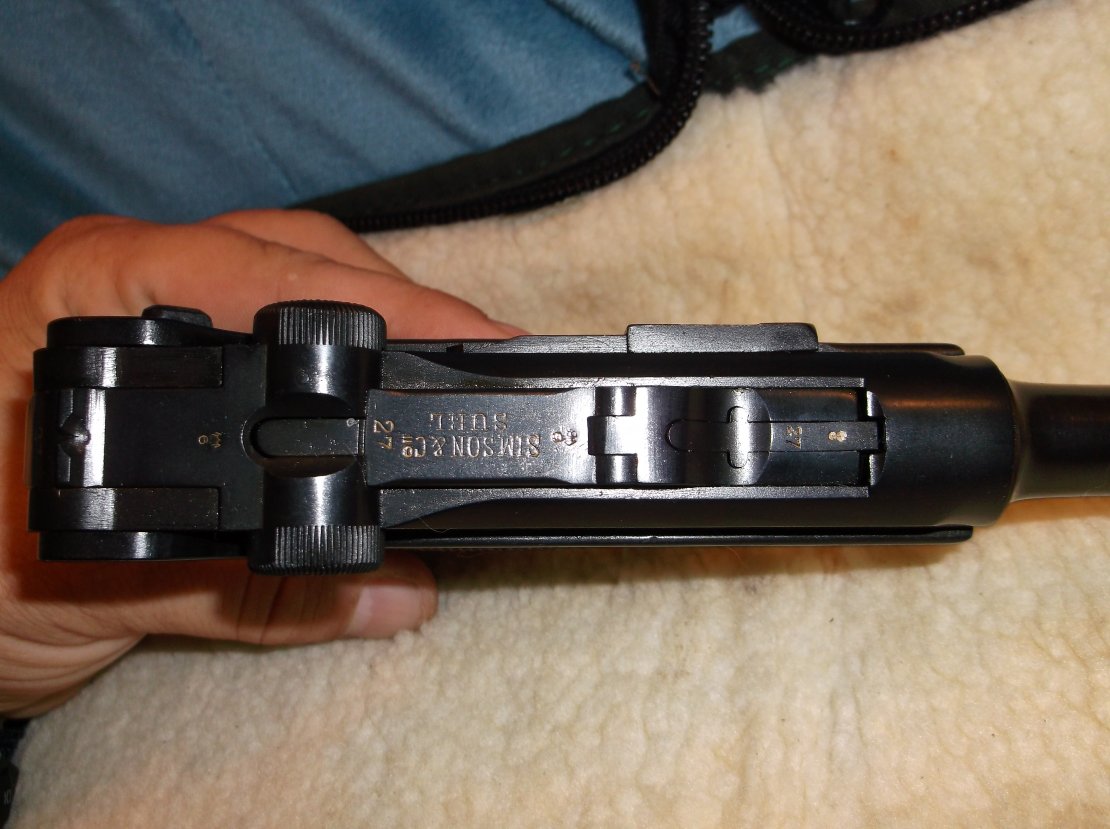

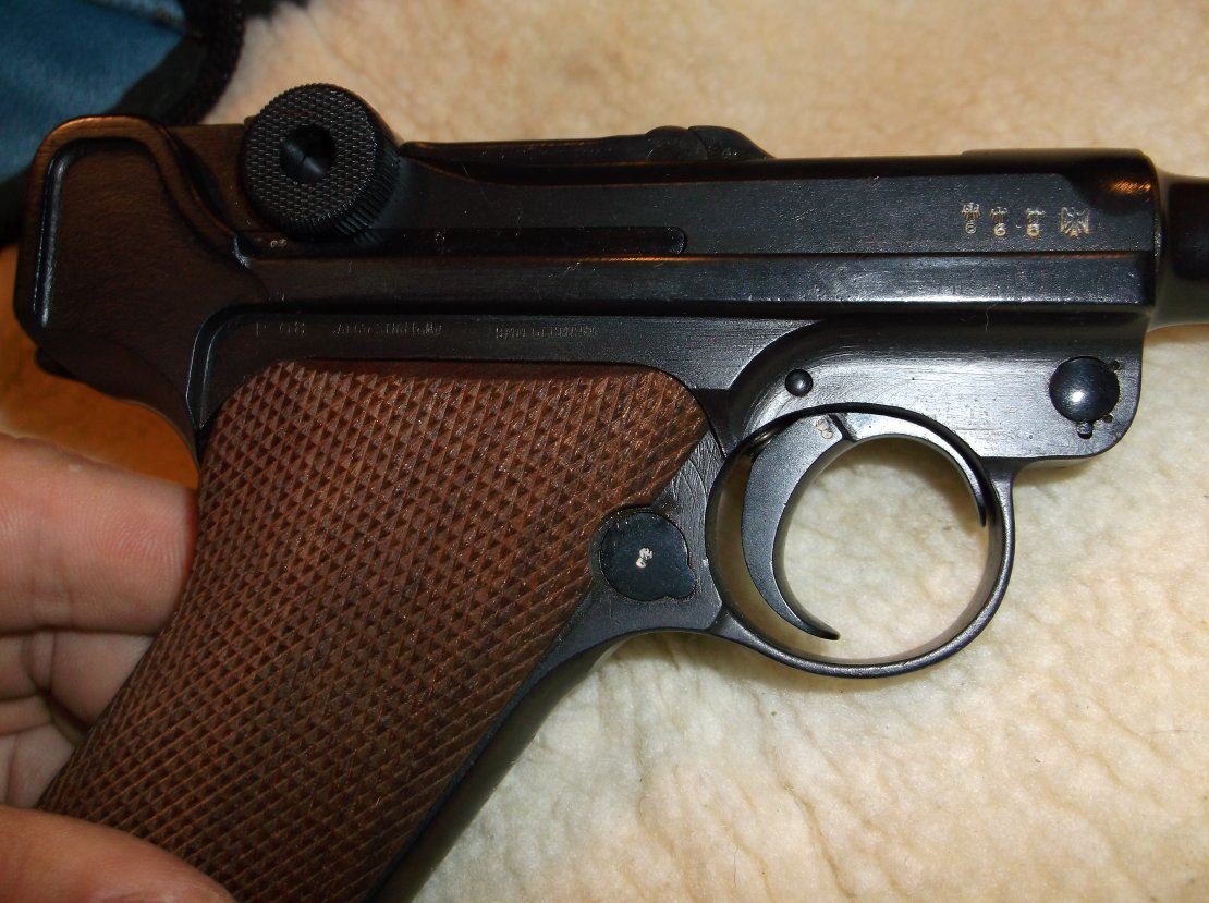

Simson blank chamber serial # 5827
Simson and Co. Suhl marked toggle, all matching with Simson E/6 proofs on all small parts (including axle pin) except:
-the ground, renumbered/force matched sideplate,
-9mm 4 inch crown/N marked (replacement) barrel (original E/6-proofed front sight present on replacement barrel)
-sear bar replaced with plum bar w/ obliterated mark
Partial 'circle X' mark on front of frame below serial number (Russian capture mark, correct?)
2 E/6 proofs on stock lug bottom
E/6, E/6, E/6 and Weimar Eagle (firing?) proof on R side of frame/'barrel extension
E. German extruded blued steel marked "2/1001' with ground and forced match Al bottom
Sarco import-marked just above R grip (poor fitting wood replacement grips, no E/6 proofs on grip screws)
UNIT MARKED on front grip strap:
M.W./L.u.V.J.3.
I suspect this is a Weimar-era Reichswehr unit marking, the "M.W." means 'minen werfer'/trench mortar if I am correct?
Help with interpreting this unit mark is much appreciated!!

Excellent report, all the info I need for my database
I have a East German that started as a simson much like yours, except the toggle was replaced by a Erfurt toggle.
Not sure on unit marking.
