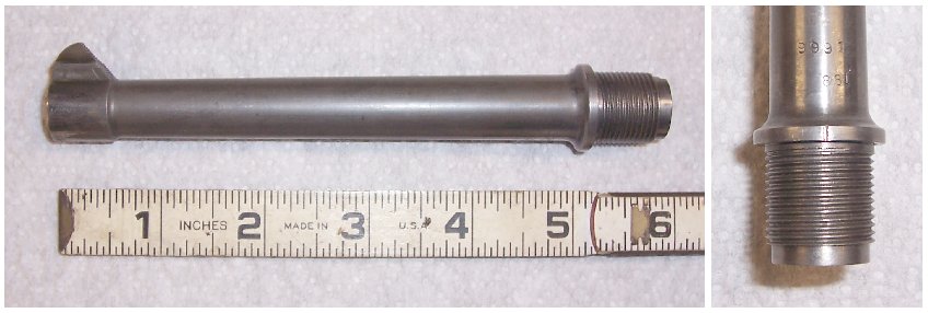

Unread 08-21-2012, 09:13 AM   #4
Amateur machinists also make 6" barrels...Sometimes even mark them to the Luger/Lahti/whatever...
(44-40 Gun Blue doesn't seem to hold up too well after 30 years)...

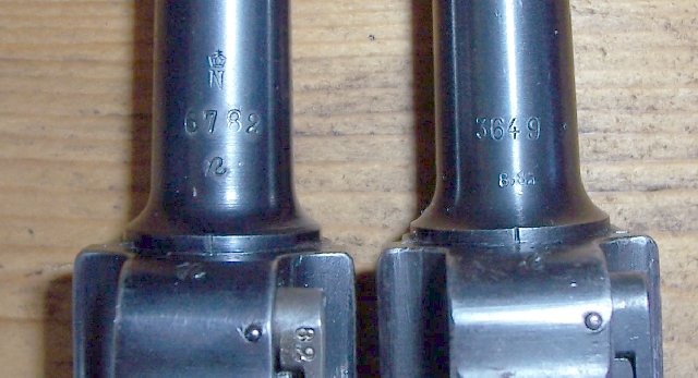

Unread 08-21-2012, 01:47 PM   #9
Originally Posted by coosbaycreep View Post
I just uploaded some photos, but I think it went to an album here instead of the thread.
Yup. Close enough!
Definitely not an OEM barrel. Still nice, though.
Here's a commercial 30 cal barrel on the left; military 9mm cal barrel on the right...(Bottom of barrels)...
