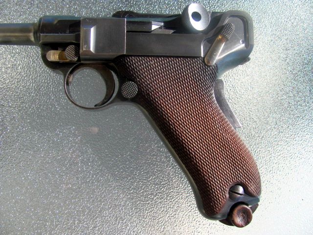

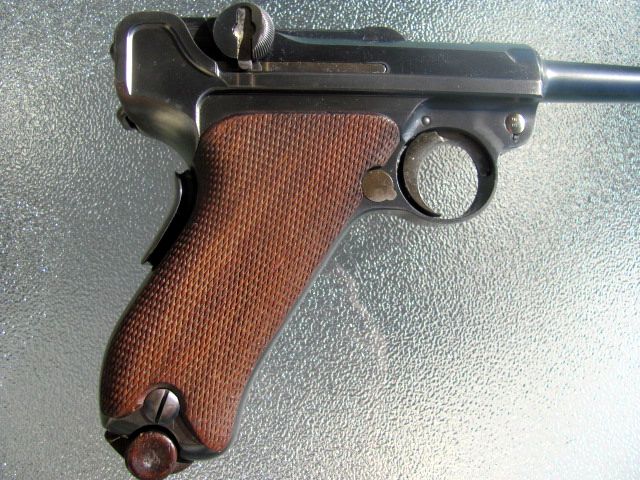

Where did he find the grips. Are mine wrong?
