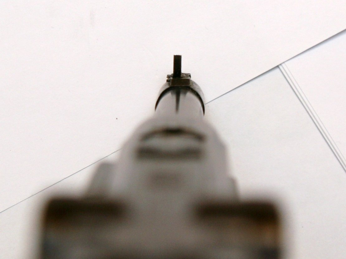

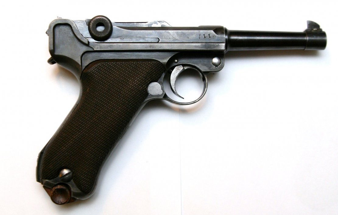

Hello
I am new to this very nice forum and this is my first post.
I've recently acquired my first Luger and would really like some help to identify it. I know that it is a DMW from 1917, but that's it.
Also the front sight is loose and can be moved even more to the left than shown i the pictures. I cannot move it more to the middle.

The receiver notch shows that the receiver was once attached to an artillery barrel. The Tikka marked barrel shows that the current barrel is Finnish. The Finns also had their own sights which differ from the normal production ones. This sight looks like a home made or home modified one. personally I'd tap it out and get a replacement one. Chances are it will also cure the loose fit in one go.
The rear sight has also been modified, you normally find a V-shaped notch. Dunno if this is a Finnish modification though.
With the square rear sight, a square P38 front sight may also be a good option, if you plan on shooting it.

It is also mismatched, making it a shooter
Unread 12-05-2010, 05:13 PM   #4
Your Luger was originally a LP08 (Artillery) model. It now has a barrel made by Tikka in Finland. I do not think it was ever a Finnish military piece as it does not bear the [SA] mark. The front sight has a similar appearance to a Tikka sight but I do not believe it is one. I see that there has been some effort exerted to move it, probably with a pin punch and hammer as evidenced by the deformation of the metal. It may not be a correct sight and therefore will not fit, but I think you could remove it completely from the left and clean up the slot and dovetail on the sight and try it again. You may have to touch up the dovetail with a fine file, but don't over do it. Good luck.
Thank's everybody for this information I am really impressed.
My plan is to use this gun as a shooter. Where can I find a P38 front sight or a Tikka replacement one.
If that is so, then the toggle train has been swapped also. It has a rear sight.

Hi Kress, The toggle train is the three connected parts shown in the photo. Breech block, middle toggle link, and rear toggle. Regards, Norm

Kress, I believe that the front sight shown in your photos is a Finnish replacement. In lieu of that one the P38 type would probably be best for your square profile rear appeture. TH
