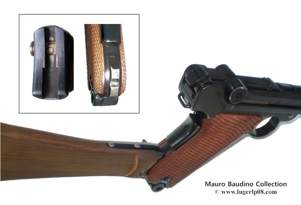

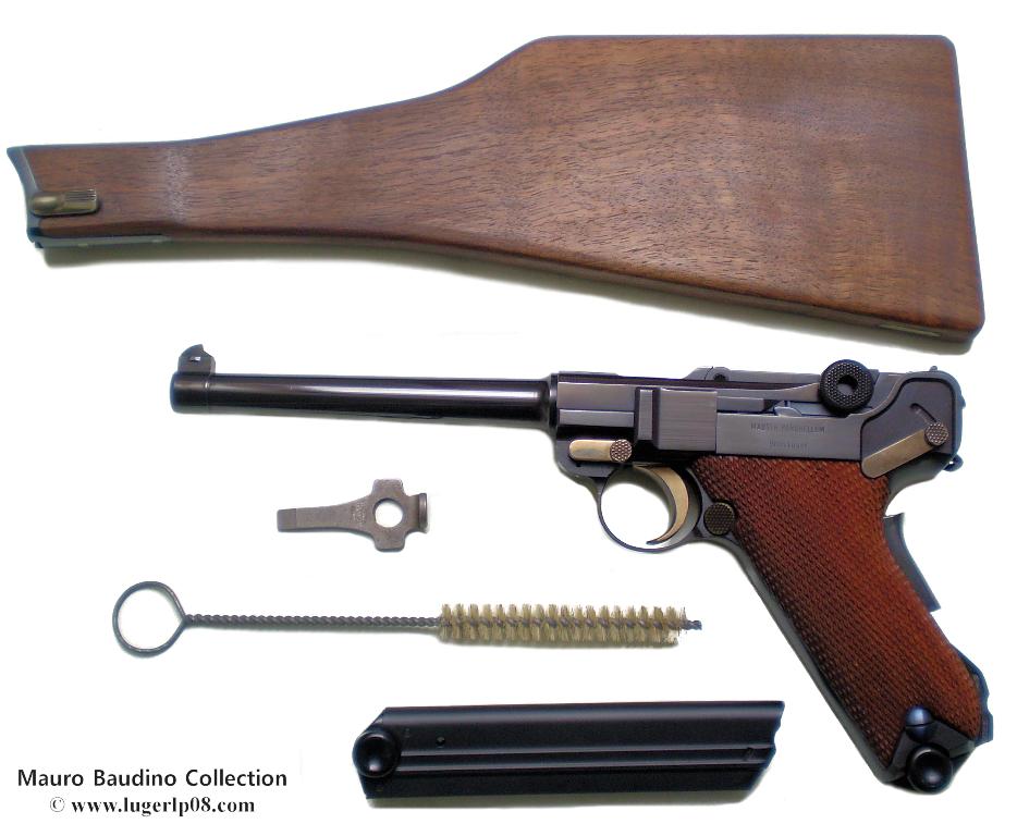

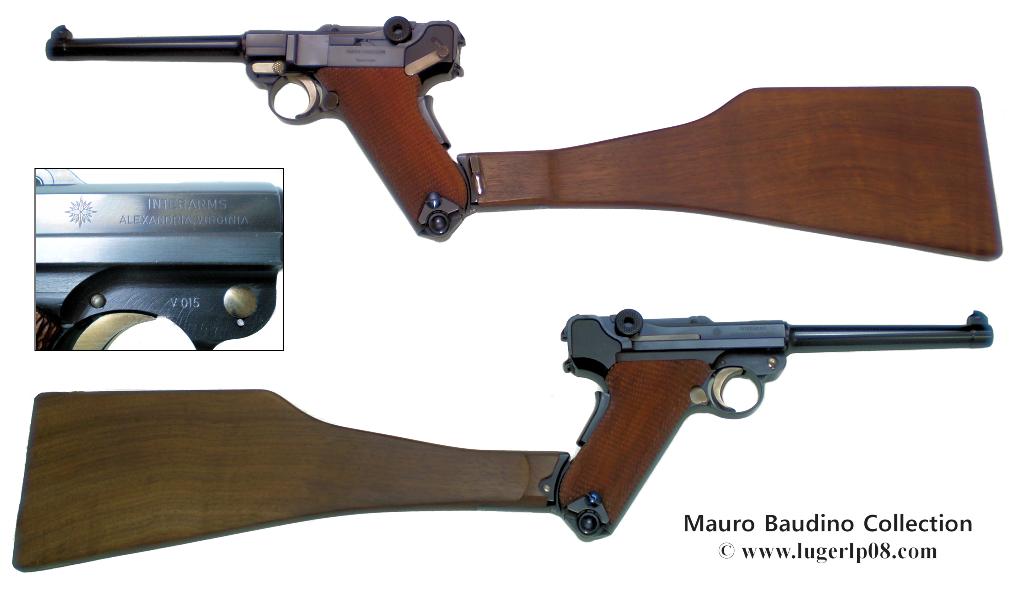

I have recently opened a topic about the Versuch model V15 that is is actually the first experiment Mauser made when they decided to create stocked frame with lanyard ring.
The V15 is the unique 29/70 prototype reworked to accept a stock and a lanyard. I guess you will find interesting the topic.
The topic is: http://forum.lugerforum.com/showthread.php?t=22600
Have fun,
Mauro

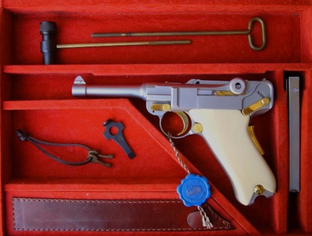

This is my Hard Chromed made by Mauser in 1972 with Ivory grips and gold plated small items.
Mauser applied in the time, different kind of bluing for the small items.
They are really nice to see...
