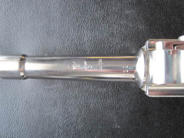

The barrel is marked "ca. 7.65"
The markings are odd, starting with the single eagle on the right receiver to the two large eagles on the barrel and what appears to be a hand engraved caliber marking

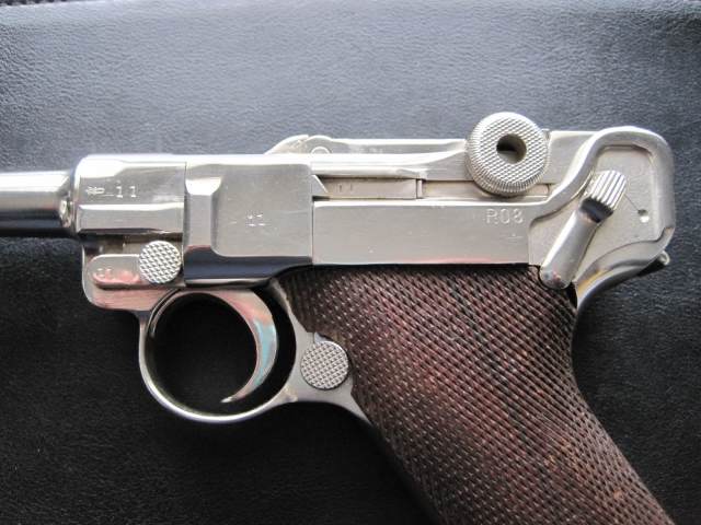

If this gun has 1938 on the chamber (not shown in the photos), then it is a real "Mixmaster". Luger frames weren't marked P08 until 1941. Regards
Thanks! I missed that!
It has the comma rather than the American period...maybe a European re-barrel???

What about the lazy C/n and lone e/s. Looks to be a police issue gun.

The E/J and E/N on the barrel are 1940 rework proofs. This is an odd one for sure. This is the best nickel plating I have seen on any Luger, very well done.

Here's a couple pics, in case you're at work and can't connect...

The Crown/U is a Mauser Oberndorf commercial proof. This thing is really an enigma of parts and proofs. All of the marks indicate that it is a Mauser Commercial rework. I would be curious if it has a Banner toggle.

This Mauser appears to have originated as a military pistol, but reworked (factory?) for some reason, commercialized with E/N proofs and rebarrelled to 30 luger. Must have been some special order item...and in the midst of wartime!

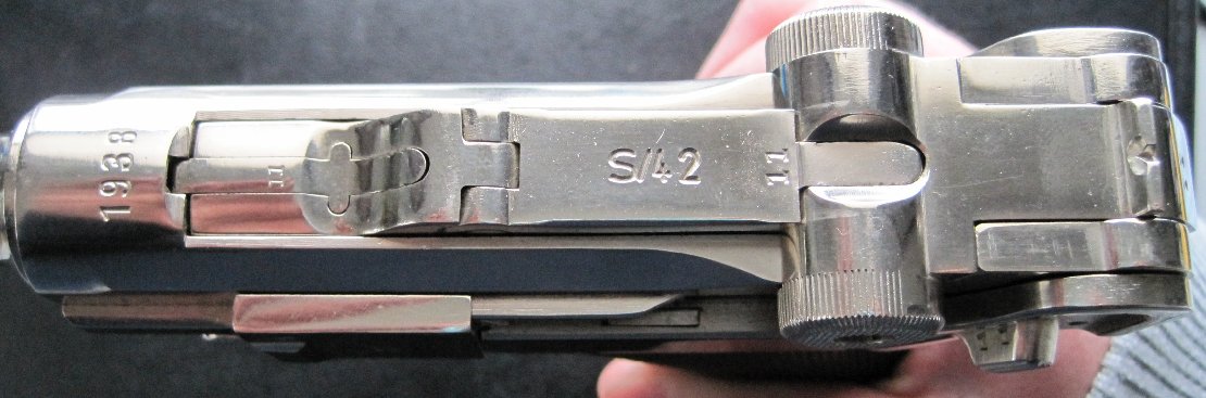

Oh, boy! It sure is a special order item!!!
The seller sent me a pic of the top view...Nice big one; the toggle stamping is especially interesting...

Please Wait.... where did CNC come from.... although dressed in silver color, the toggle marking still looks correct, period correct matching 1938 s/n 5088k publish in book well. CNC is not dirt cheap, supposed being used in more serious application, if rational.
Can ceiling on gunbroker.com be lowered after bidding?
Unread 05-05-2010, 07:52 AM   #18
Toggle markings have been cut, not stamped...could be from a pantograph...but not 1942 technology...
But it is nice work...
Unread 05-05-2010, 08:03 AM   #19

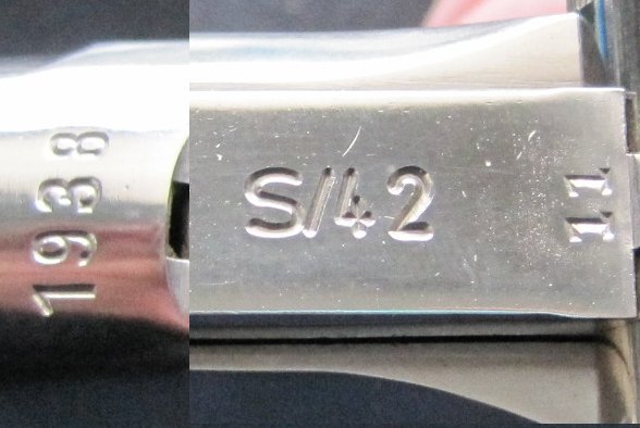

Good point. Now the question is -- Are "1938" and "S/42" supposed to be cut, not stamped before bluing? Those markings do not have ridges nor distoration on the guns that I've met.
Unread 05-05-2010, 08:14 AM   #20
Here is a comparison with my S/42 toggle...Notice end of letters/slash are rounded, from rotating cutting tool...and where the cuts intersect, it is a nice clean edge, not rounded like a stamp...
Font is different as well...The "11" looks cut also...
Very nice work...CNC initial $$$ is considerable, but with practice, very quick & easy...Something like this could be done in a few minutes...During a regular run of engraving...
