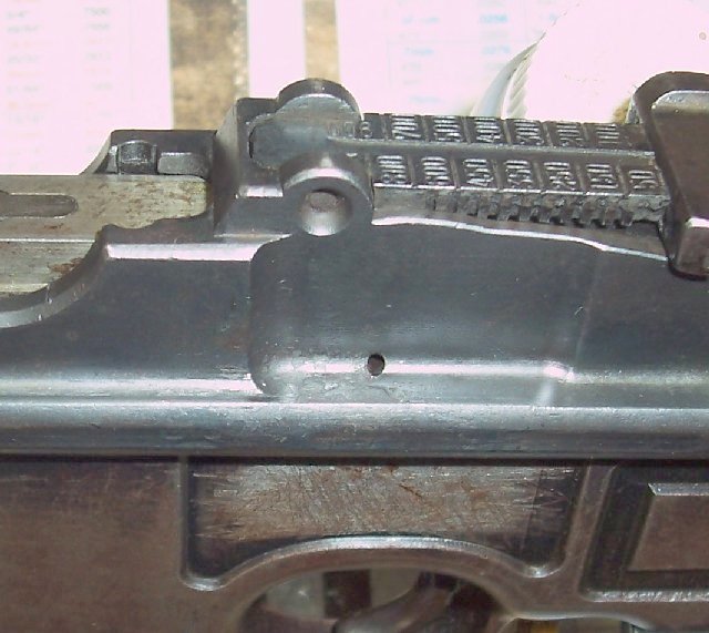

There is a 1/16" hole drilled into the barrel extension...
(first pic)

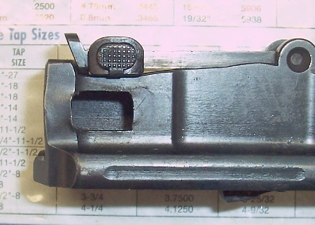

...And the bolt stop slot is pretty hammered...
(second pic)

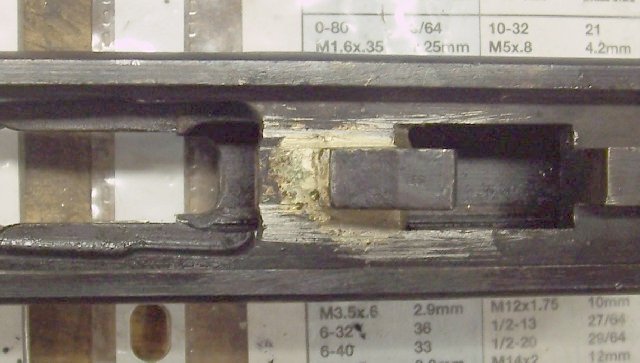

...And the most confusing (and alarming), the barrel extension lug has been brazed...
(third pic)
Now, if the bolt stop slot in the barrel extension (like my pic shows) is hammered back that far (presumably by hot and/or Tokarev loads), will the lug on the bottom of the barrel extension get hammered back as well???
I have examined everything carefully, and likewise examined my M1930 which is *not* hammered, and I am pretty well convinced that the brazing was to add metal to the front of the lug where the locking block pivots...
I won't attempt to shoot it this way, and I do have another barrel extension on the way from a Forum member which is not hammered like this one. But I'm really curious as to *why* anyone would braze up the lug on the bottom...

When the area behind bolt stop was very distorted, operator would notice (1) the barrel could not fully return to its forward position; (2) the trigger did not work anymore. The previous owner might try to solve the problem by moving the locking lug under the receiver a little bit, but that's the hard way leading to nowhere.
Unread 05-17-2009, 12:43 PM   #5
It must have worked; I cleaned off quite a bit of fired powder, and there were fresh brass marks on the bolt/extractor.
I'm amazed that whoever did it actually could get in there to file down the braze...

It looks like something was done to the side of the frame, then filled in and filed away again?
I can imagine that someone who found himself owning a 'locked up' Mauser would try and poke around to see where to deblock it, drilling some 'inspection holes' here and there?
Unread 05-17-2009, 01:49 PM   #16
You mean the scratches in the milled indentation above the trigger??? I know that Keng's puts their import marking there; I'm guessing the previous owner sanded/filed it down...There's nothing on the inside to indicate drilling or filling...
