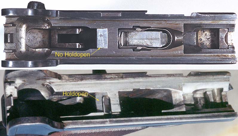

Henry,
Look inside the frame and compare to these two examples.

Posts: 12
Thanks Dwight. It looks like it does have a holdopen. Should it be replaced?

Posts: 12
Dwight, thanks to your photos, I was able to locate the holdopen. I have removed and cleaned it which helped. I also discovered that it might be the replacement magazines I purchased. The are new made replacements and when inserted, the mags do not always push the holdopen spring up into place.
Thanks again for the help, Henry
