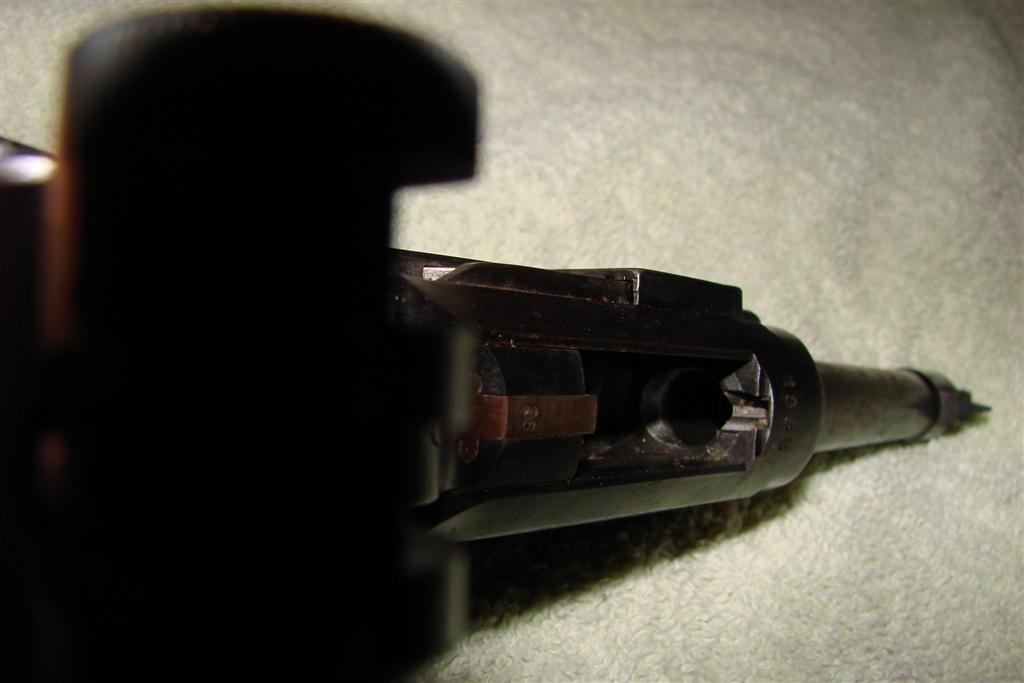

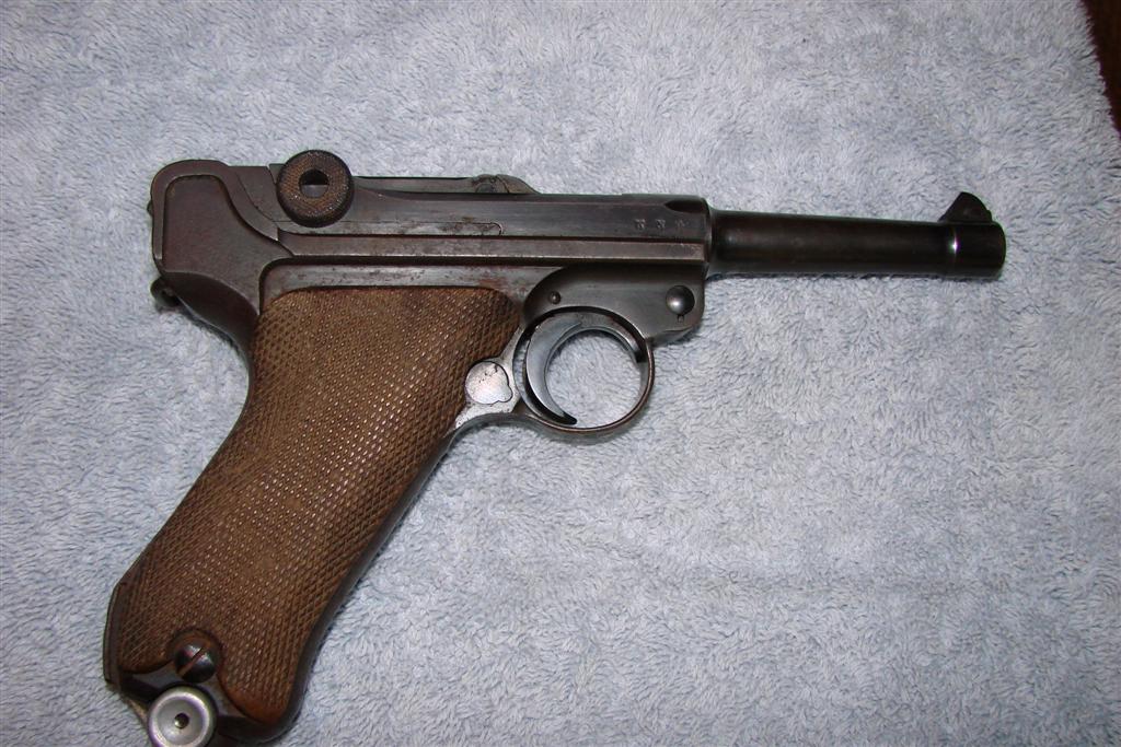

Can any one tell me a little about this Luger. My grand father gave it to me before he died. He loved this gun and now I do too. Is it a collectable or a shooter. All #'s match except the mag. He brought it back from WWII, where he picked it off a German soldure.

It would be helpful if you could show us a pic of the top and other side if you can

post information so we can help. Don't use just pictures (and only one shows). tell us the year stamped on it, the proofs / acceptance on the right, the toggle marking, etc.

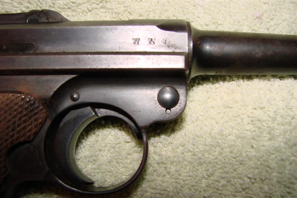

Luger Identification Form
1. S/42
2. 1938
3. Circle checkerd hollow center
4. Not present
5. present
6. 9mm
7. (? )(chechered)(? ) (no insignia)
8. (?) (Gesichert)

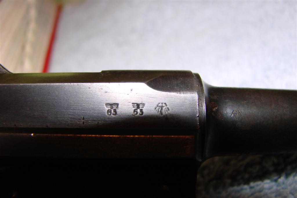

9. (Proof marks- breech left side #46 -from incignia list- 2 eagles with #63 underneith, third eagle more like #45 only no #underneith----Barrel left side eagle same as third on breach----frame close to barrel bottom side cursive K
10. 4''
11. n/a
12. open, V (rear) tryangle with ridges (front)

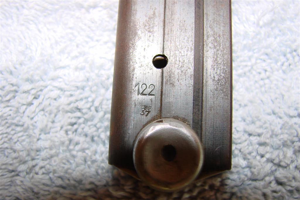

13. Aluminum bottom, cursive O and an X---eagle and # 37 on mag body
Particular specimen
1. S/42
2. 75%
3. no straw
4. excelent
5. very good
6. all matching except mag
7. no
9. no

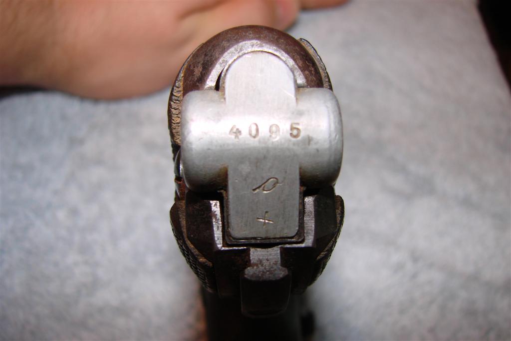

Your Luger is made in the Mauser factory. Not much more to say about it from the provided data.
It's a nice piece of history and you are lucky to have one!
From the one picture, it looks very dry. With some surface rust and pitting.. think it's time you take it apart and oil it in well. Perhaps soak it in Kroil over night, and 'rubb' it in with oil afterwards.
You can also carefully remove the grips and look for any markings on the inside. Think they look a bit too 'single colored' to come from the s/42. Welcome btw

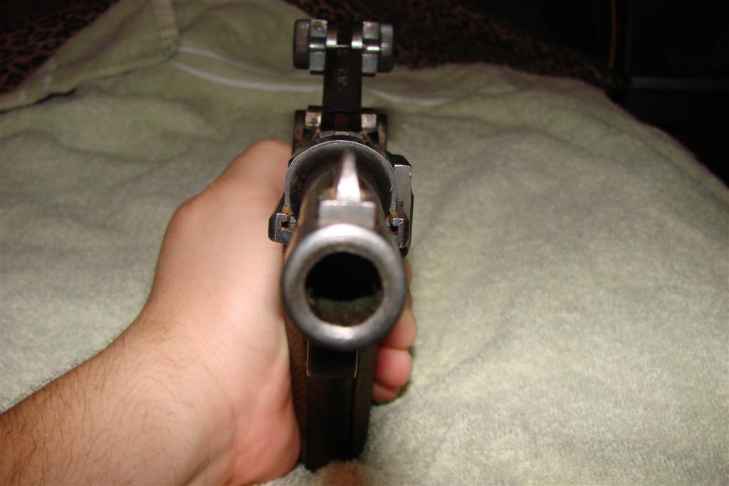

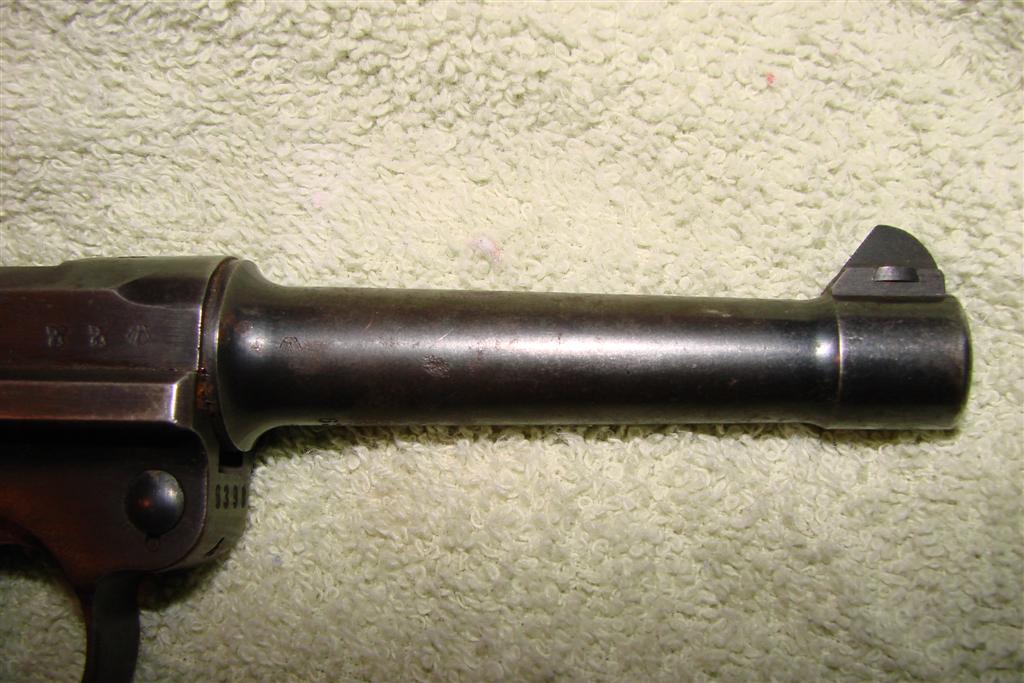

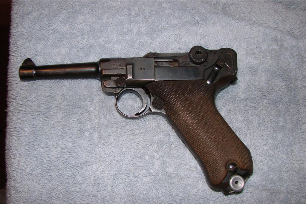

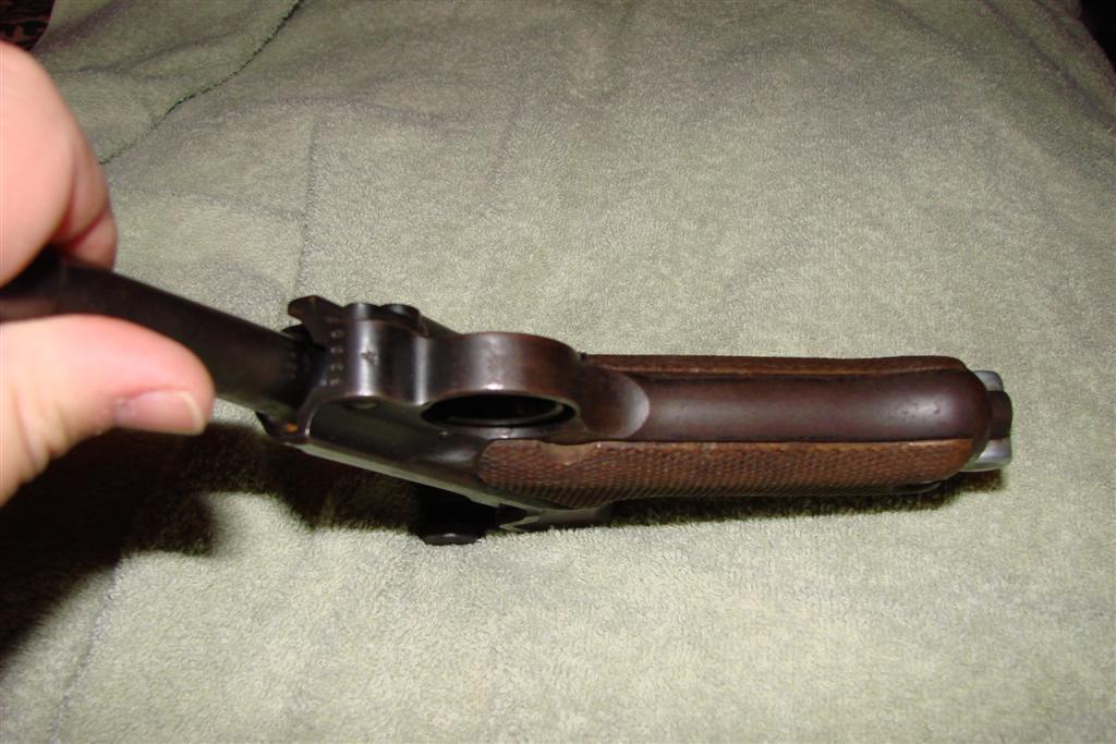

I appologize for the lack of pics. I am just learning the pic upload feature. Appareantly every photo must be imported to your message seperatly? Any way here are some more
Thanks
Enzo
I thinh I am doing this right. Please let me know if I am not.

A very honest looking Luger, just like I like them.
Most of the rust will go off with regular oil if you spend some time on it. Rubbing is the key.. and then some more.. and when you think you're finish, do it twice as long. I'm sure it will turn out great.

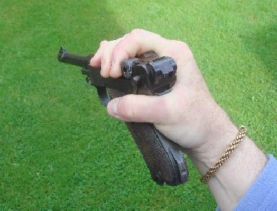

As posted by Tac Foley (and I think the same method as mentioned by Steinar), it is easy to retract the receiver enough to rotate the takedown lever. Remove the magazine, and with the safety off, grip the frame and toggle knobs as shown in the following photo provided by Tac. Just squeeze so that the barrel/receiver group slides back until the toggle knobs contact the frame ramps and then rotate the takedown lever with your other hand. It works just as well for toggle-lock and grip safety Lugers.
