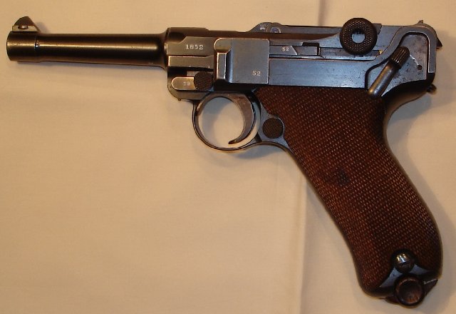

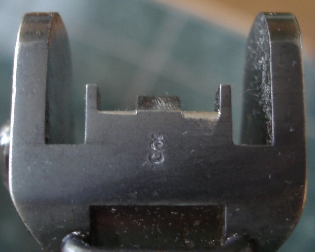

Lyn Islaub sent me some photos of a nice 1913 DWM. He asked that if I couldn't identify the mark on the rear of the frame to post it on the forum. I'm stumped...any of you folks have any ideas?

Ron, This appears to be a styiize crown over S, but not the normal font of the standard Imperial inspector's mark. One might guess that this indicates acceptance or inspection at a non standard or foreign facility. As I recall many Swedish Lahti pistols have a crown/SS stamped in this location.TH

In Costanzo's, page 206. A very similar mark identified as a Spandau triggerguard proof. Found on one 1918, on the front of the trigger guard.
Maybe it's a Spandau Back frame proof, found on one 1913?
I know it's not much help, but maybe it's a possibility.

Thx for the input. I've poured through Costanzo and every other Luger based publication I could find trying to identify this mark and appreciate you taking the time to comment.
