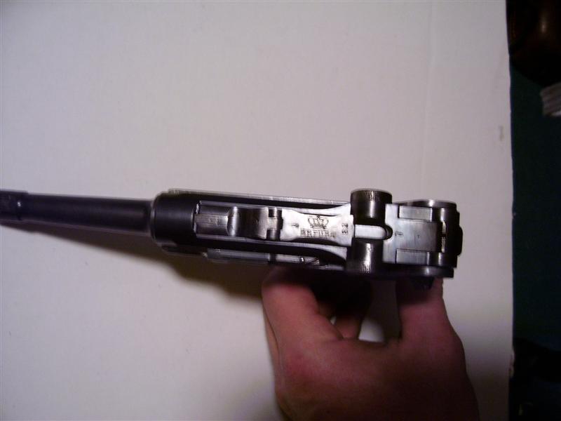

More pictures to follow All numbers on the gun are 82 the last 2 of the serial number

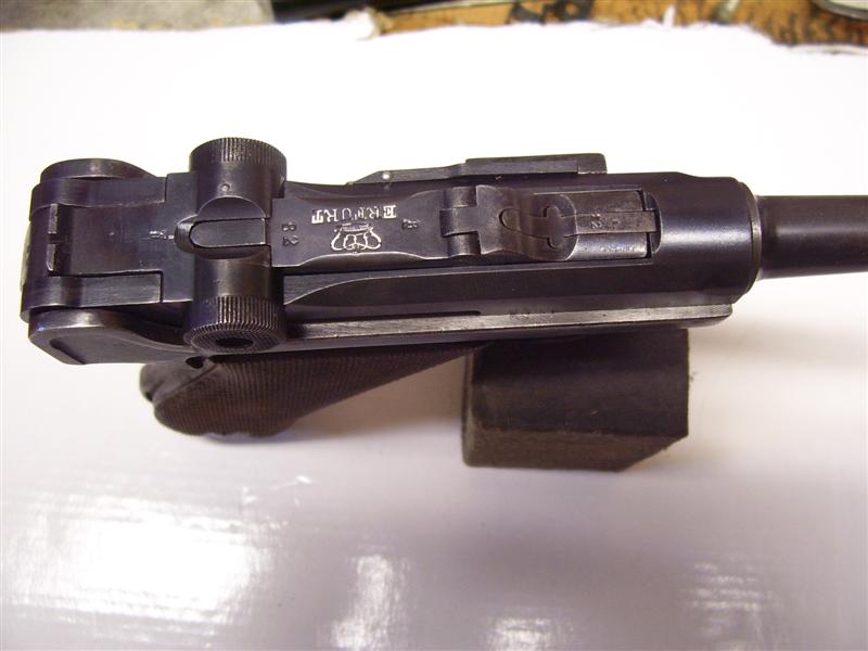

Default top
Notice no date code .

Police rework. One of our Weimar police collectors will be along to explain more fully.
Unread 12-14-2006, 11:49 PM   #6
Not sure why the date would have been ground off. What are the proofs on the right? That might explain a bit, if it has Erfurt proofs (and is all matching), then that might tell us something. If it is Weimar proofs, and the Erfurt toggle matches, then the toggle is a force match by someone...
It is a sear and magazine safety police. Those two safety's were put on in 1933 and the magazine safety made inoperable in the late 1930's to almost all guns. Is yours snipped off by the trigger? Hard to tell by the pictures, it might appear to be mostly there, but 95% of the time they are inoperable.

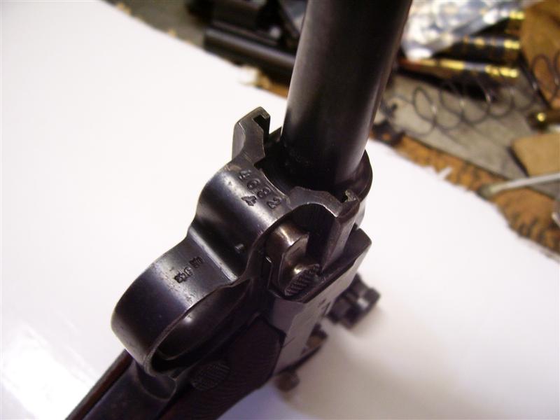

Guys first I would like to say Thank you for helping me
There are no marlings on the front strap or the right side of the gun . I do not think there ever was a date code on the chamber there is no evidence of any grinding the metal all looks the same and not lower at any point . I will post more pictures of the markings on the front of the gun .

Jay,
It appears that this pistol underwent rework for police service, and during that process the barrel/receiver combination was replaced. As there are no markings on expected places found on either the barrel or receceiver, it is not possible to deduce their source.
