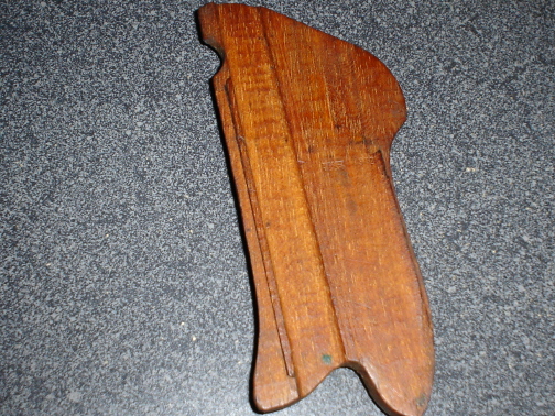

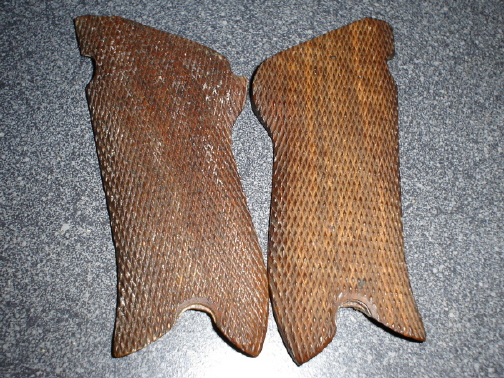

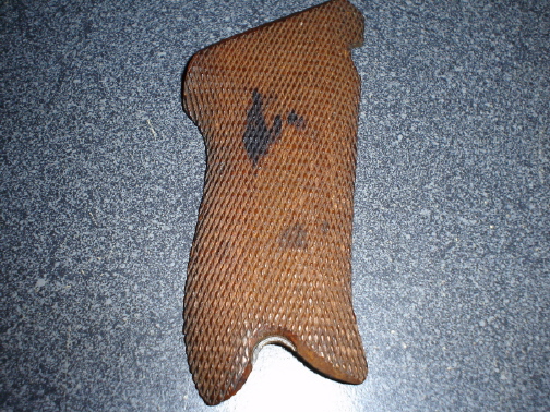

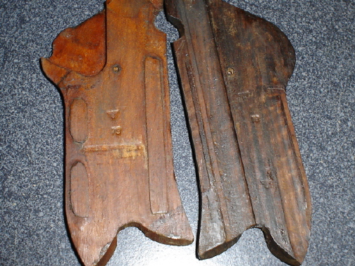

I was offered these grips today. At $80 per pair, they are not cheap. One set is a "pair", the other is not. Do you think any of these are legit?
What are those holes for in the one set and why do they look like different wood? Thanks in advance. Eric |

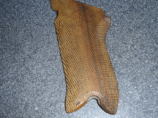

close ups. . .

checkering. . .

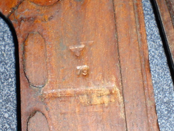

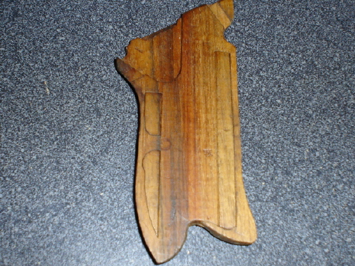

Here are the singles . . .

and the last one . . .

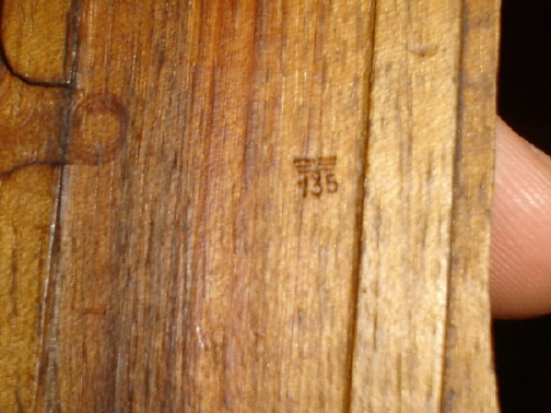

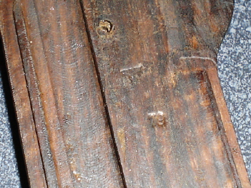

The only grips I have seen with the holes in the back like that were not original, I believe they are holes for a duplicating machine. The grips I have observed with the holes were all very well fitting and matched wood however. These grips are different because they are of different wood, and although they look old and worn and have inspection and sn marks, I am not sure of their authenticity. The other pair are nice original WWII Mauser grips and probably worth $80, although with the stain I'd try to talk him down a little. Often dark water stains like this can be bleached out.

How does one go about bleaching that black mark out of a grip?
thanks, efm |
#12 |
Posts: 2,460
Thanked 166 Times in 65 Posts
Mix laundry bleach 50/50 with distilled water. Lay the grip on a flat surface in the sun and drop some of the bleach solution on the black spot. You may have to repeat several times depending on how fast it evaporates.
You can also bleach the whole grip by putting some of the solution in a shallow pan and soaking the grip in it in the sunlight. Takes 30" to an hour to bleach out good, depending on the strength of the sunlight.
TRUMP FOR PREZ IN '20! |
