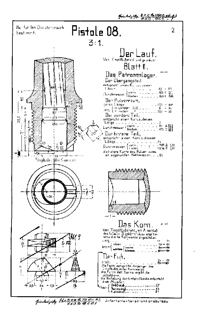

Shape of chamber design gives good information if old barel or not...
Please give us more information, because I have been collecting for years, and I have no idea how I would tell from your statement...

Simple:
Old design from 1902 to around 1940 has a different shape than modern 9mm Para.
Chamber is not totally conical, you have a 5mm strait bore just after the beginning of riffling.
Picture:
http://forum.lugerforum.com/lfupload/image2reduced.jpg
