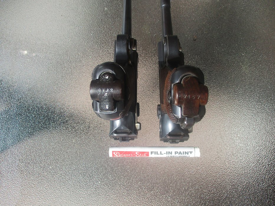

I have had good luck with the lacquer sticks that Brownell(I think) sells. They come in red, gold and white. They are inexpensive and not difficult to use once you prep the end for use. I keep lacquer thinner handy and Q Tips. Like anything else, the more you do it, the easier it becomes, UNLESS the stamping is very shallow like the American Eagle on the Mauser Parabellum pistols.......what a PITA!!

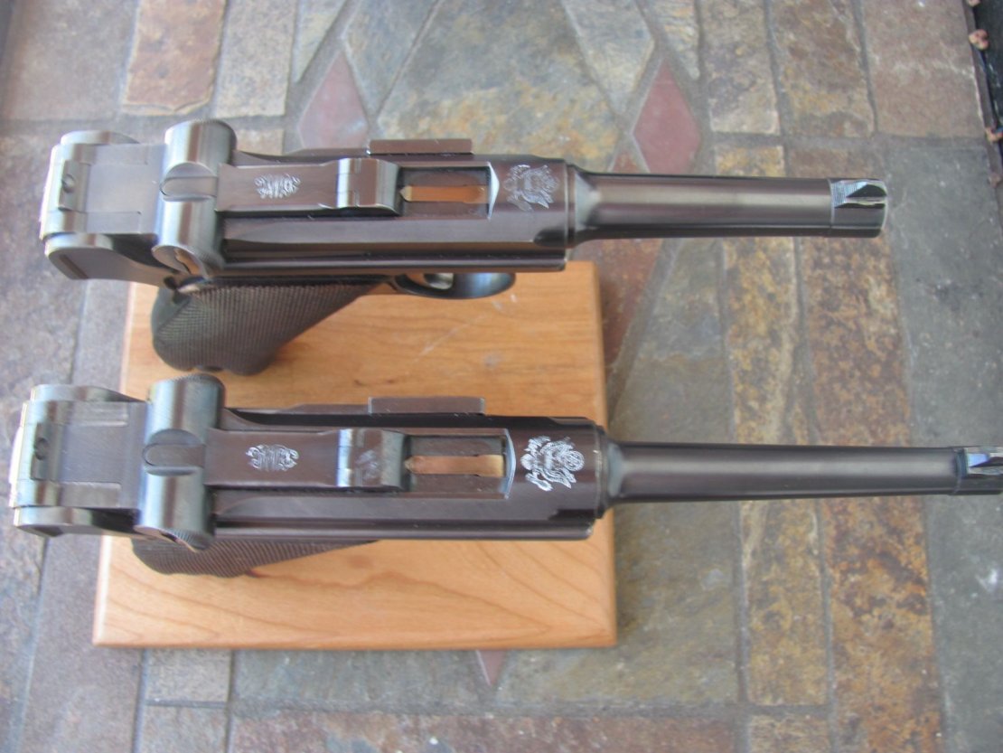

Which do you prefer? I vote natural!!!~

Eugen
Eugen's Avatar
Join Date: Apr 2016
Location: Newburgh,IN
Posts: 797
Thanks: 403
Cirelaw, yes, on that big eagle natural looks better. But on small stampings white looks ok to me. Having said that I am content to leave luger collection (of one) au natural.

Default No Question!!
I agree with Eugene! I use Laquer Stick which is easy to remove! I'm realizing that Georg made some pretty early lugers!!
