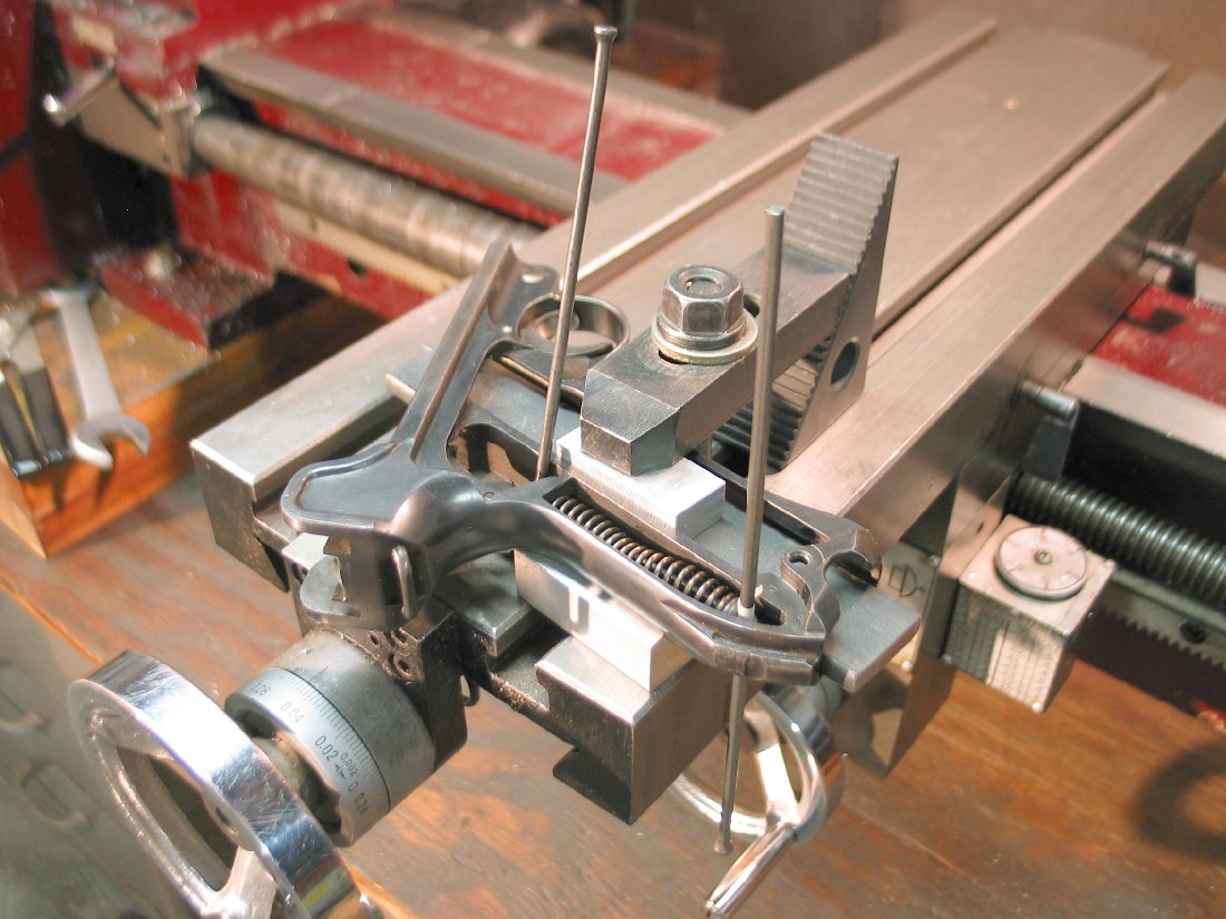

One of the pics in that thread is of a frame clamped to a table with a tool removing the mainspring. There are some brave souls who accomplish this task by holding the frame in their hands. I do not recommend that. A C-clamp and a couple pieces of scrap wood and a 90º tool like Jim Solomon's (or a cotter pin puller) will avoid spilled blood.

- It helps to remove the magazine button and spring, and the safety lever, safety bar, and pin. I took a pic of my mainspring removal just before I began. It isn't the way others do it but it should give you an idea of how a gearhead does it. (The long rod compresses the mainspring and the short rod prys the hook off the coil. Long rod then pulls the mainspring out. This is the dangerous part - the spring is still under compression).

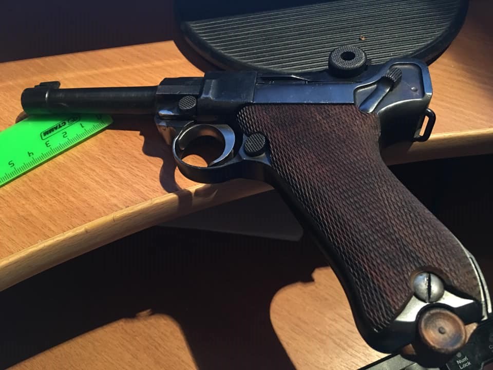

Well, I'm not so strong either. But I'll try....
