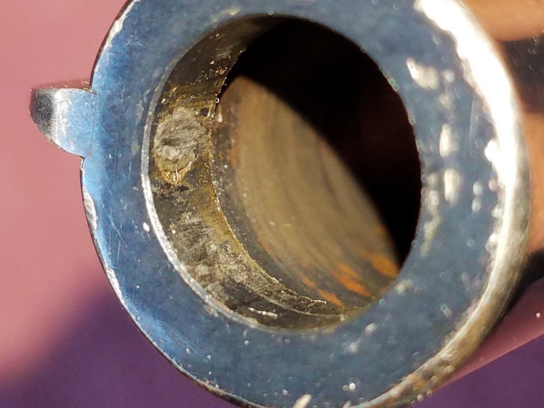

Interesting repair to the front of the Savage!
The area behind the washer was very shiny and silver. It seemed like lead solder and scraped off with my fingernail. Beneath that is what appears to be epoxy. It's anybody's guess what's under that.
The plan it to restore the nose of the slide and re-blue the entire pistol since it is entirely in the white.

This info is the nicest surprise I've had all day. Just in case...do you have an extractor in stock, Tom?
Here's a question for you, et al... The nose of the slide, along with a front sight, must have an integral area that guides the slide as it navigates the barrel when the gun is fired, similar to how the barrel bushing of a 1911works. My question is how long is the internal "sleeve" that rides the barrel? It works OK with the drilled-out washer that was cobbed on, but it seems to me that it originally must have been an affair with more to bear on the barrel than the thickness of a washer. If my question is coherent, I'd be delighted to have a measurement!

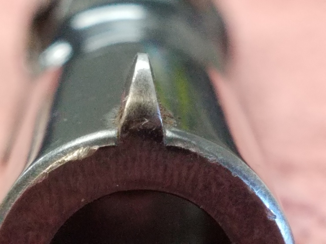

As per David's request, here are some pics and measurements to help with his rebuilding of the front of the slide on his Savage 1907. Sorry for the delay in posting, my Savage was not readily accessible. I included the rear sight so you can confirm yours is the same. The front of the slide is machined from solid stock and there is no separate bushing as can be seen in the pics. So yes, there is more than the width of a washer contacting the barrel, ie dimension A, .170"

last 2 pics
