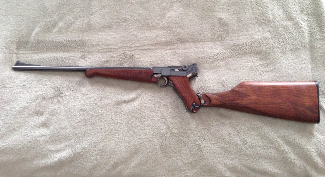

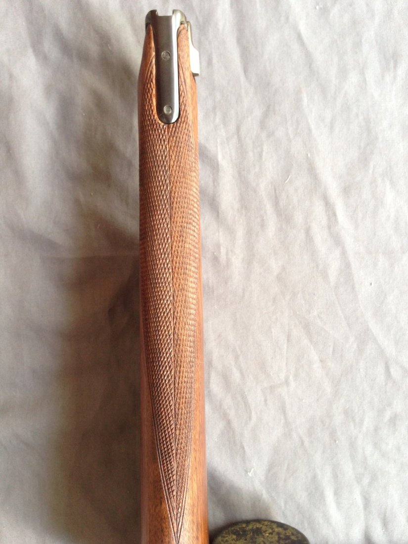

Here are several photos of my carbine crafted/assembled by the following “gang”.
Charles Danner : rust blue, straw, and fire blue.
Jim Solomon: from a single piece of wood, Macon Gun provided
a semi-inlet blank for the stock, Don fabricated the forearm, I
made the grips, did the design and checkering, along with
installing the attaching iron.
Gerald Tomek: cut the barrel and threads, index to BDC at the
correct torque of approx. 50 lbs.. and cut the taper.
Don Voigt: coordinated the project. He did the extractor cut,
finished the chamber and head space, front and Navy rear sight,
and fit the forearm to the bbl.
It was a fun project, and I felt privileged seeing the nice results of three craftsmen—Charles Danner, Gerald Tomek, and Don Voigt.
Jim Solomon

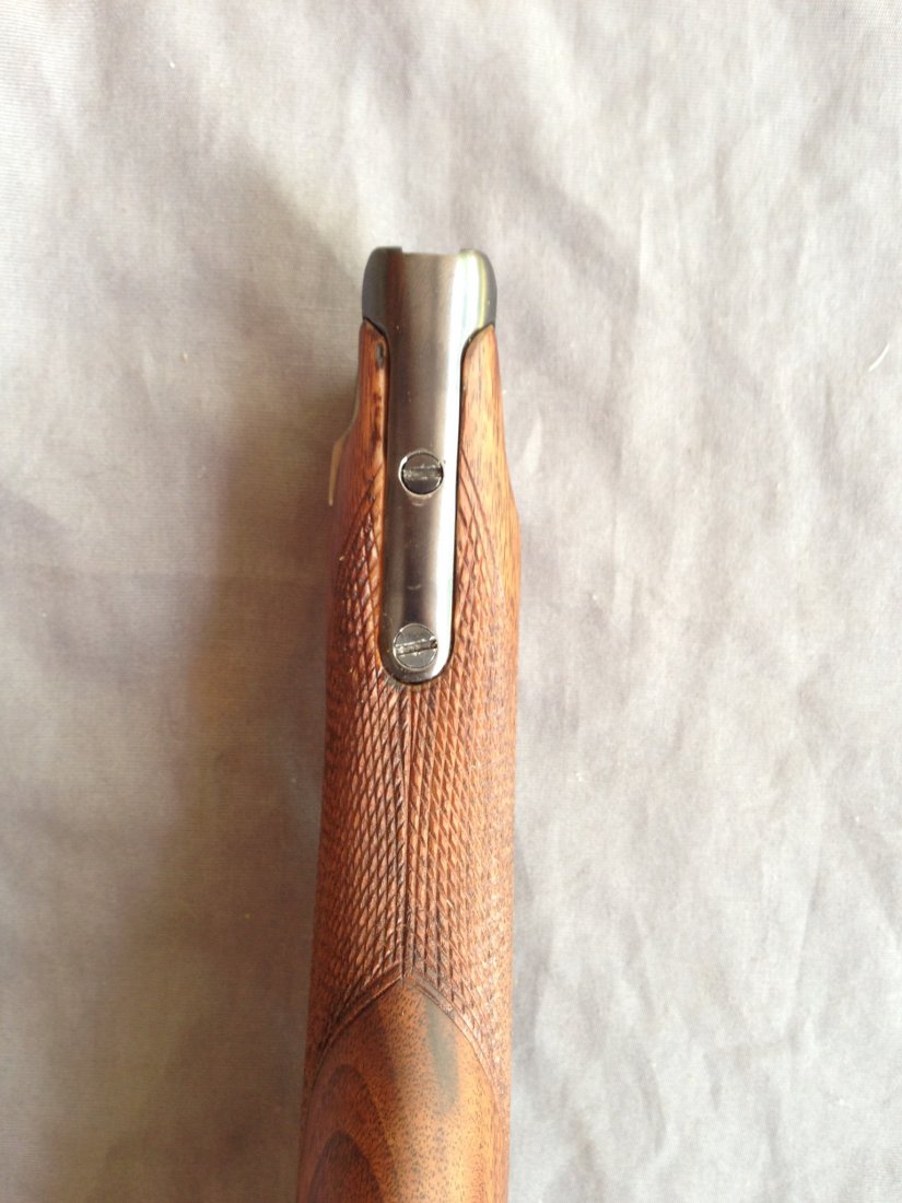

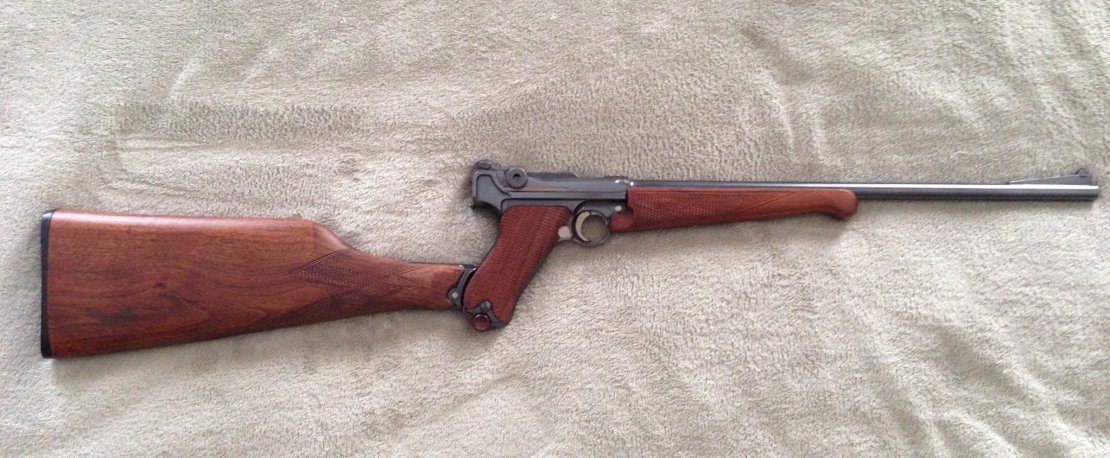

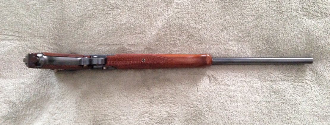

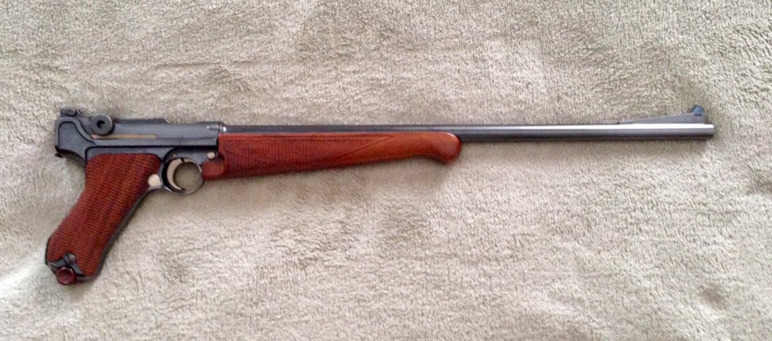

Additional photos. Jim solomon

Don't forget Jim Solomon was part of the gang as well!!! No small task in checkering and finishing up the wood to where you see it now!... til...lat'r....GT....

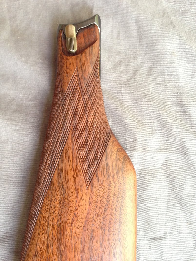

Here are picts of my carbine, Jim did the stock checkering and finishing on it too. I used the screw in the forearm as mentioned above.
