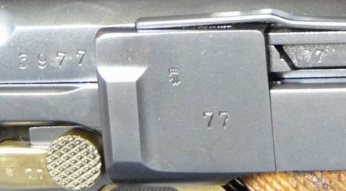

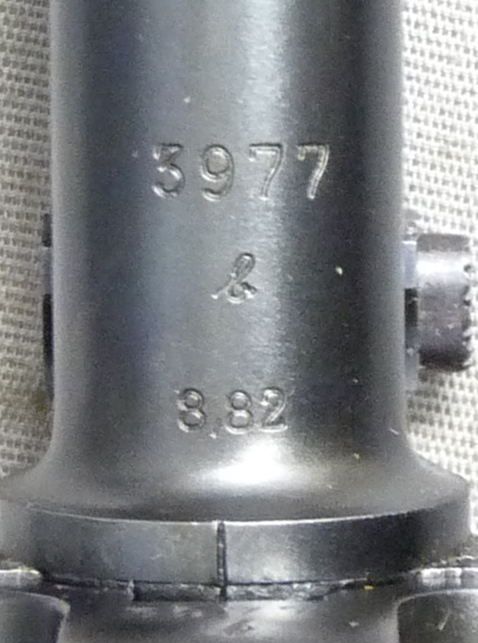

The added numbers are pantographed, not struck with a stamp or die- pantographing leaves tell-tale rounded ends and markings from the swirling of the tool in the numbers or letters, also there is no displaced metal as is seen in a stamp. You can see the pantographed numbers in the pictures below- on the magazine, barrel, the 3 and 9 on the frame are enhanced.
All the barrel numbers and the suffix are pantographed!

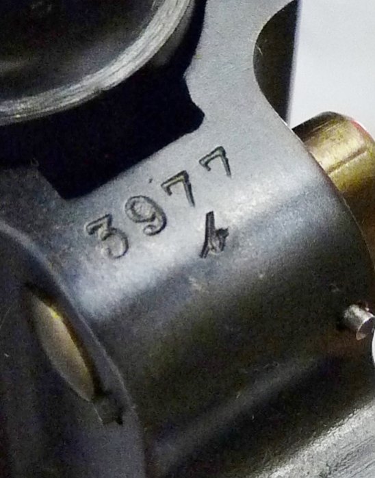

Compare the difference between the "7s" on the frame and the barrel; on the frame they have square ends, elsewhere they are rounded. The expected harp/square ends are clearly visible for comparison on the chamber numbers, the others should be similar- just smaller.

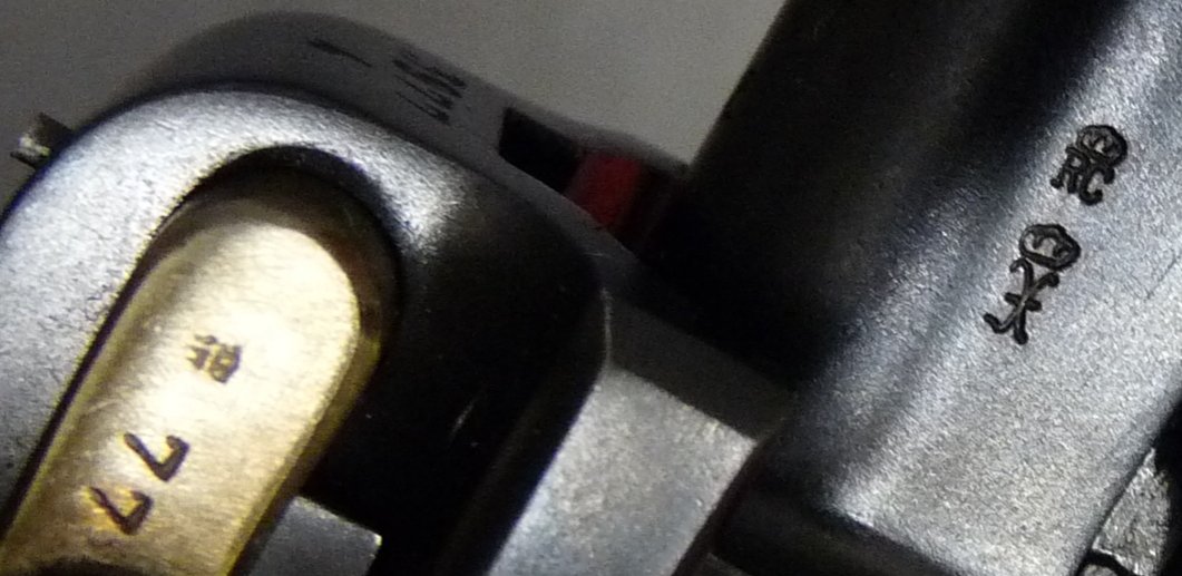

Notice how the inspection marking on the take down lever is faint, compared with the strong "77" and the really sharp RC and C/x marking on the barrel in close proximity.

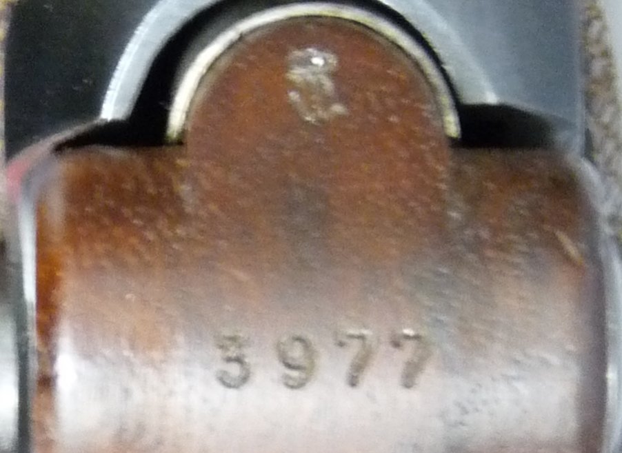

The magazine is tougher to see in the grooves, but the rounded ends are there, and there is no displaced wood.

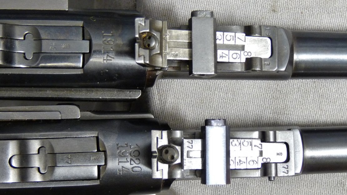

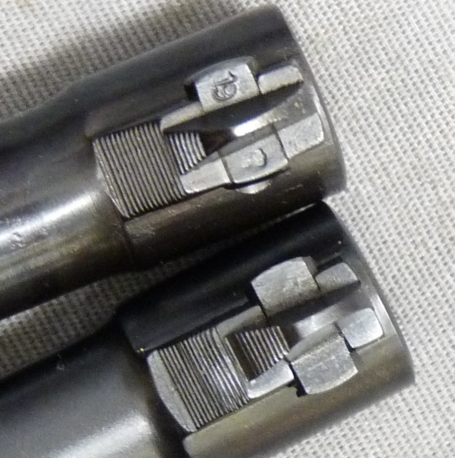

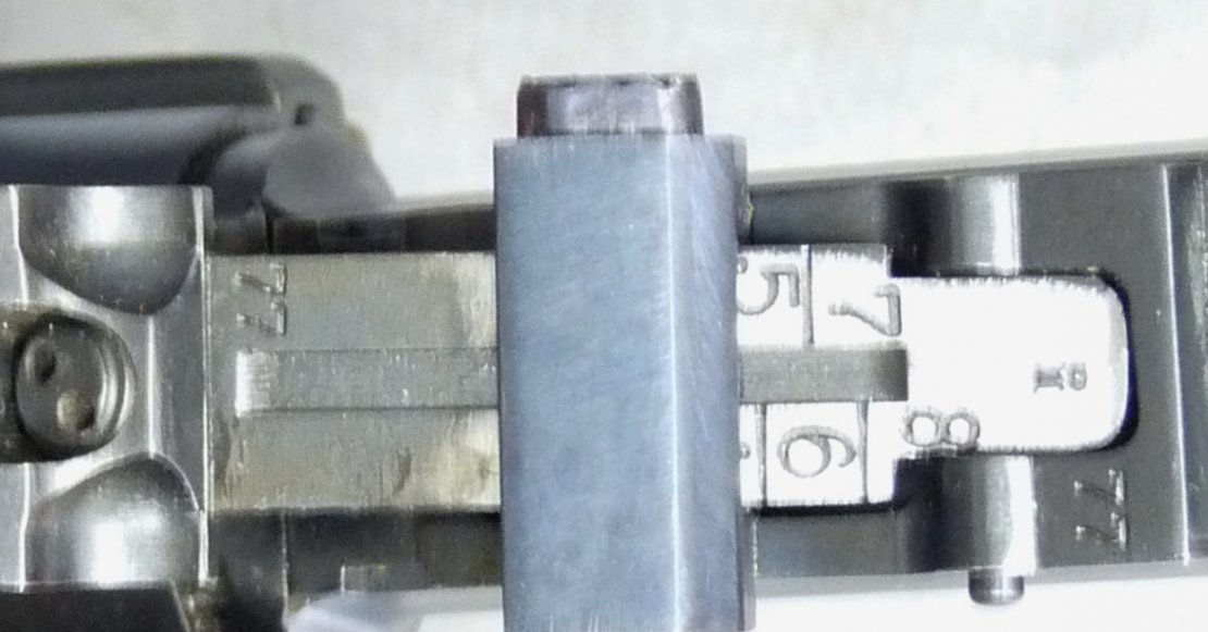

Also the numbers and inspections on the rear sight are not in the right places, nor are they stamped. The sight elevator clearly shows the panto-graphed numbers on the right or lower pistol vs. the fine stamped markings of the genuine 1914. Also the inspection stamps are not as small on the fake, and too "sharp".

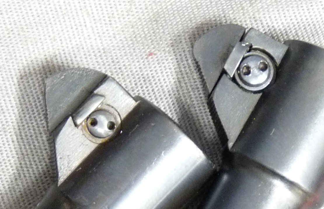

The front sight fine tune screw, slot, and blade are a sloppy fit on the fake, compare them with the fine work and fitting of the genuine barrel which is on top/left. Even the adjustment holes are off center in the fake.
The markings on the top of the front sight are also missing on the fake, I guess they are too small to do with the tools at hand.
And the guy was too lazy or in too big a hurry to polish off the blue under the slider, notice the dark spot with the slider pushed up!

I would add that the serial number postscript "b" on the barrel does not match the "b" on the receiver.
