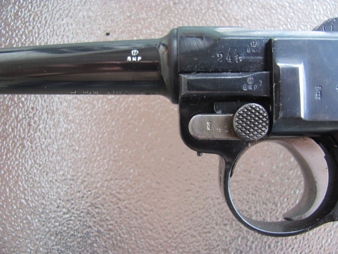

Here is a picture of an Austrian barrel on a shooter. Is this the same as yours?
