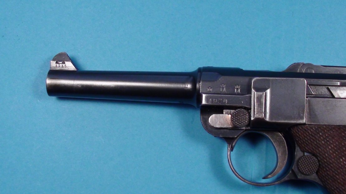

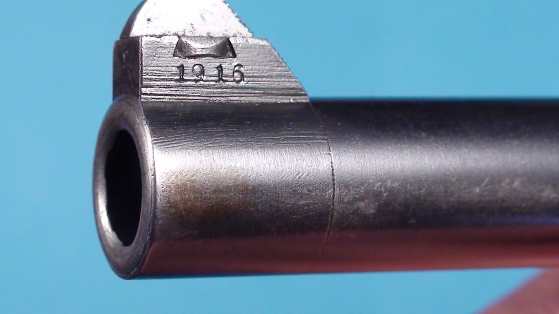

I built a clone. Like Tom says, it does shoot high, but then so does my 6" original Navy luger. I'll put in a picture when I find it!
Here is what an original shortened barrel with re-located sight looks like.
