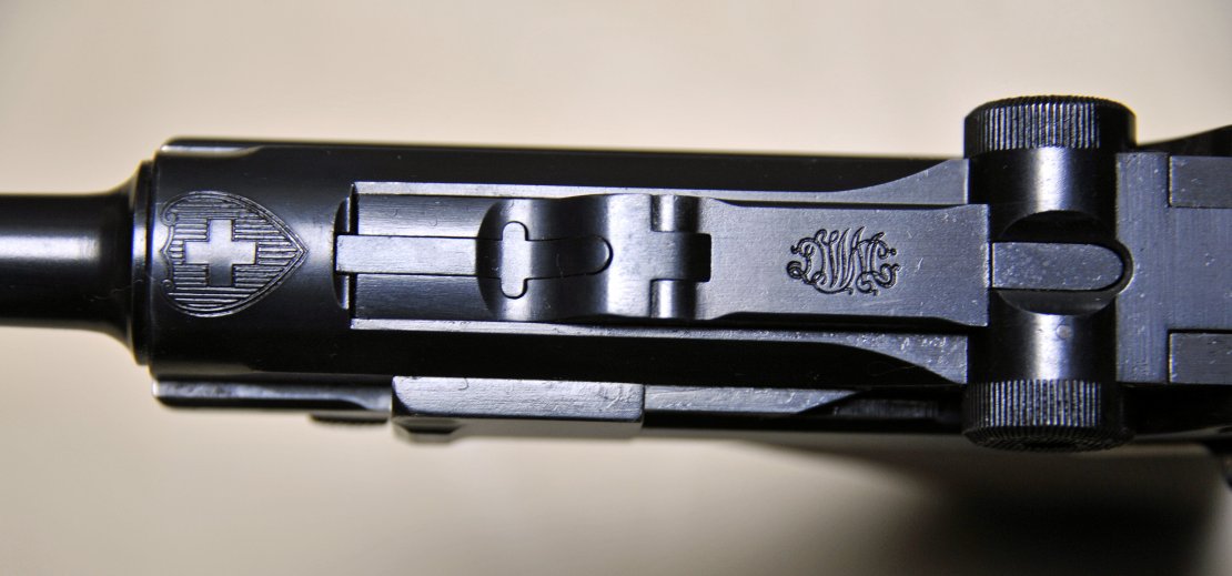

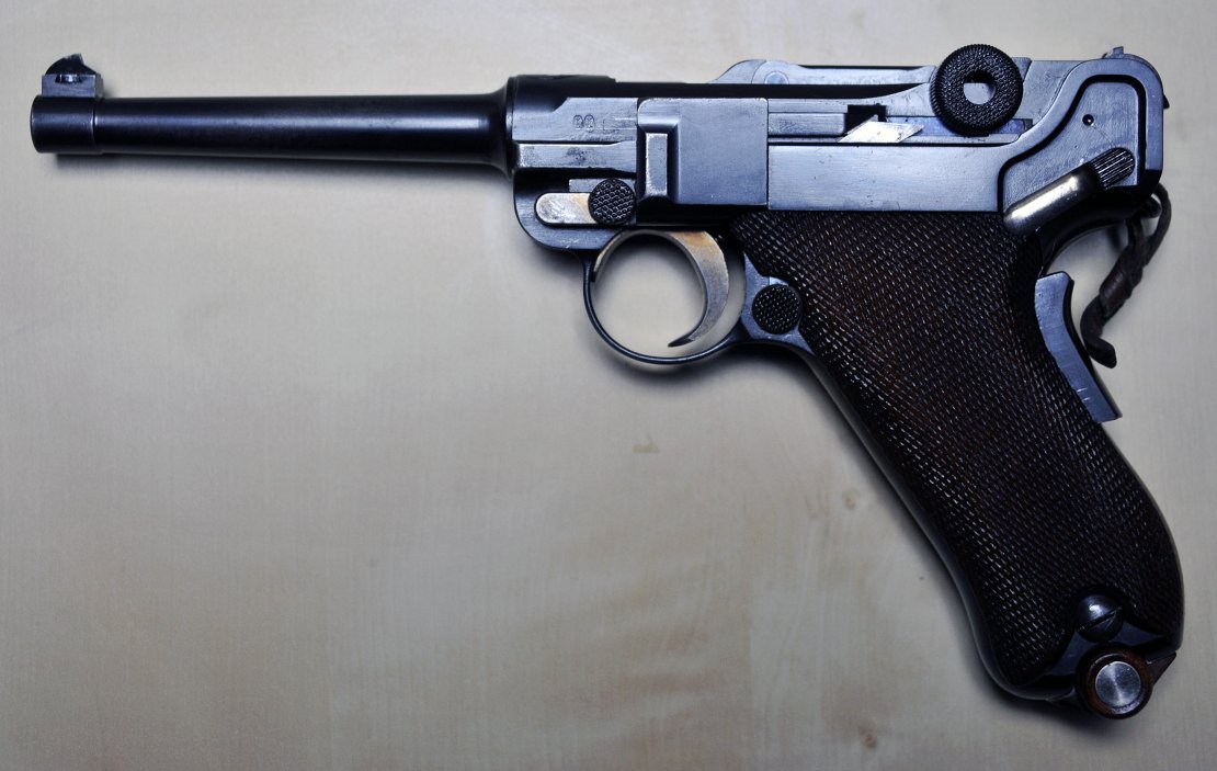

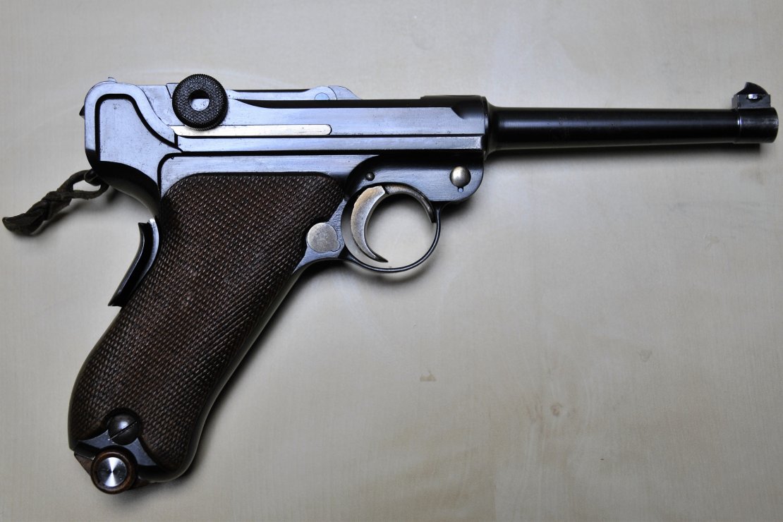

Unread 04-07-2016, 04:07 AM   #4
To me each Swiss Luger is a world of its own.

Unread 04-11-2016, 07:17 PM   #5
spacecoast
spacecoast's Avatar
Join Date: Dec 2013
Location: FL and PA
Posts: 332
Thanks: 276
Sergio -

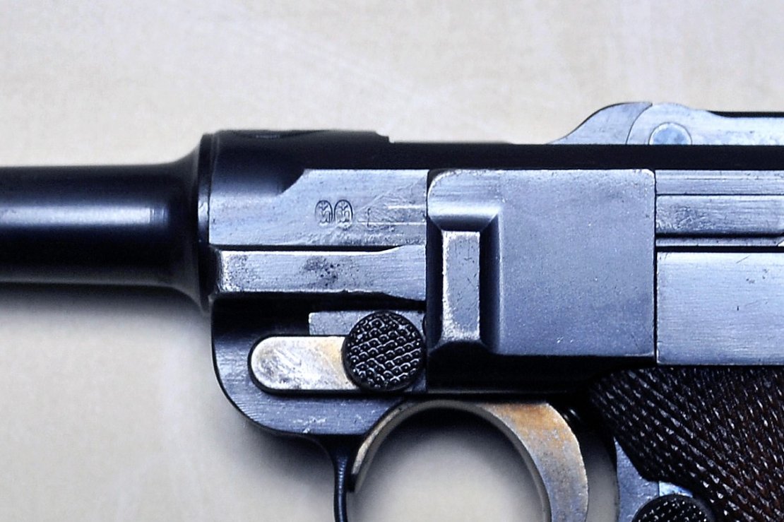

If you don't mind, could you tell us the serial of your Cross-in-Shield, and provide a close-up of the inspector's initials on the left side of the receiver?
Unread 04-12-2016, 05:48 AM   #6
Originally Posted by spacecoast View Post
Sergio -
Mark, the s/n is 14827 manufactured in 1914
