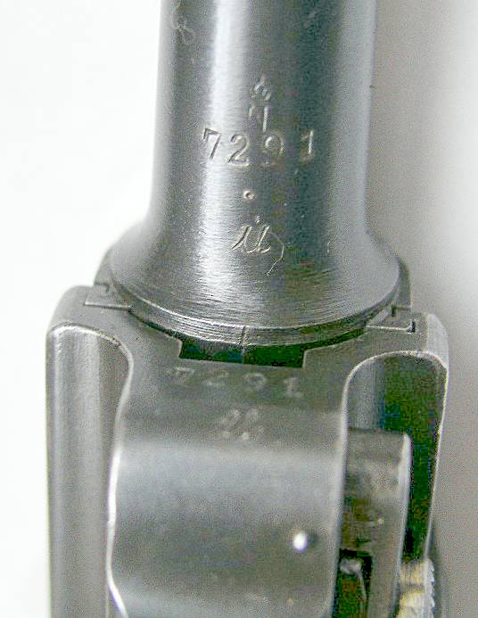

Default DID DWM/BKIW RESUME MANUFACTURING 9-MM PO8s IN THE LATE 1920s?

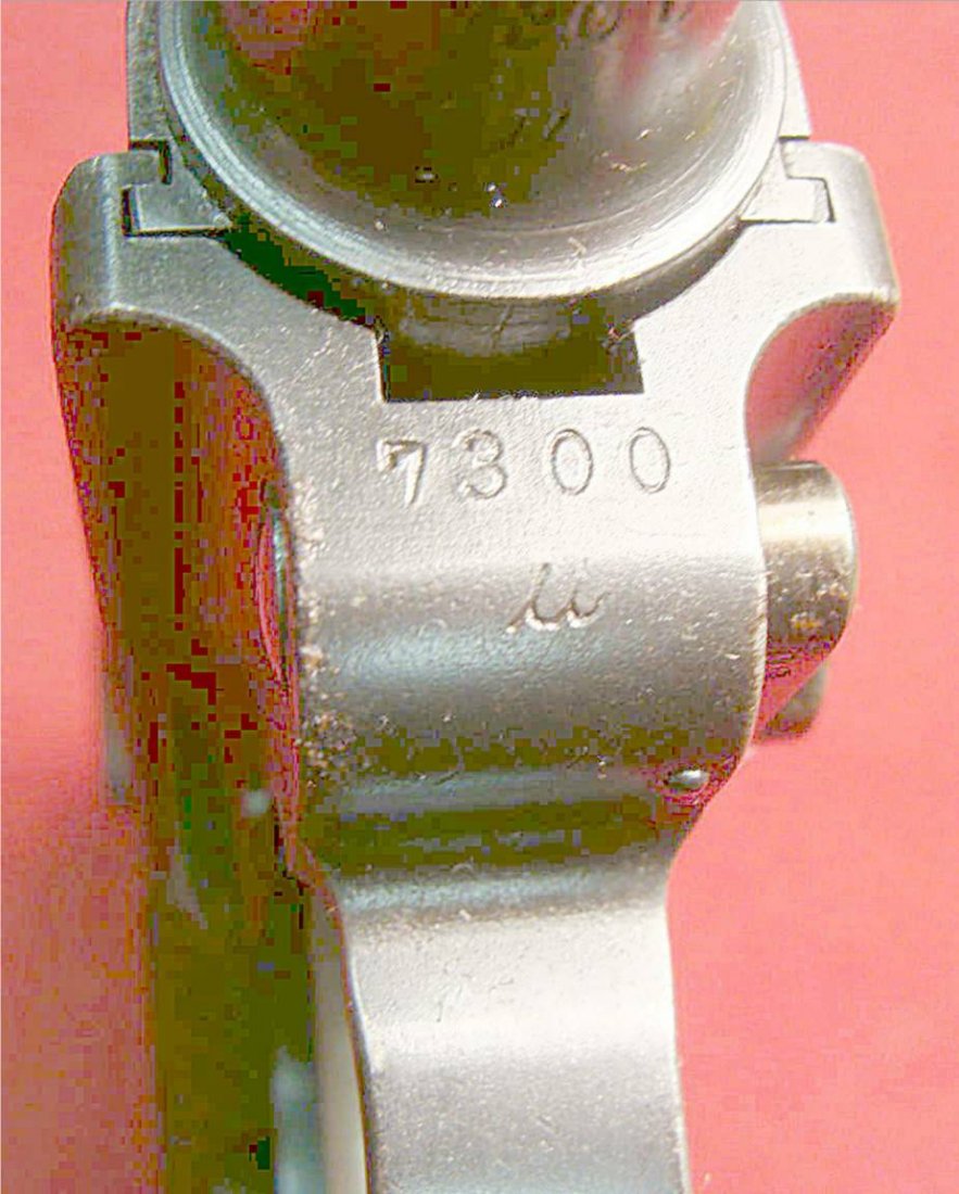

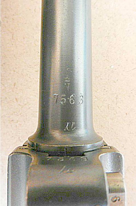

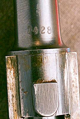

It is well-established that DWM was ordered by the IMKK in 1921 to cease manufacturing pistols with calibers of 8 mm or more or barrel lengths of 100 mm or more. As a consequence, subsequent DWM Parabellum deliveries were limited to “commercial” variations in 7.65-mm caliber with barrel lengths of 96 and 98 mm. For subsequent Parabellum purchases from DWM, the police routinely replaced the barrels, recoil and magazine springs of delivered 7.65-mm Parabellum pistols to create the desired 9-mm P08s. (See, for example, The Mauser Parabellum 1930 – 1946 by Don Hallock & Joop van de Kant, pp. 339-40.) Many collectors believe this arrangement persisted throughout the remainder of DWM/BKIW’s manufacture of Parabellums until the manufacturing equipment was transferred to Mauser in Oberndorf in the spring of 1930.
Although it has not been a topic of extensive research by me, over the last several years I have come to believe it is very likely that BKIW resumed the manufacture of 9-mm P08s following the withdrawal of the IMKK from Germany in 1927, even though the prohibition remained in effect. Not everyone agrees with me, including Dwight Gruber,, whose opinions I greatly respect. I hope replies to this thread may shed some light on this issue.
There are several reasons I have developed my opinion.
Dutch Navy Contracts – Hallock and van de Kant had access to handwritten notes from August Weiss (head of Parabellum production for DWM and Mauser from 1920 to 1946), correspondence between BKIW(DWM) and Mauser and Mauser inventory and sales records for 1930. Based on this information, the authors state that 1,484 9-mm P08s were delivered by BKIW (DWM) to the Dutch Navy in the period from 1928 to January 1930 (Ibid., p.386). They also conclude that BKIW transferred 815 finished 9-mm P08s and 9,526 finished and unfinished 9-mm P08 barrels to Mauser in February and March 1930 (Ibid., pp. 567-8). This strongly suggests that BKIW had resumed manufacturing 9-mm P08s by 1928 at the latest.
Rif Contract Pistols – Based on the notes of August Weiss, Hallock and van de Kant have also provided very strong evidence that the “blank toggle” or “sneak” DWM P08s were originally manufactured for the revolutionary Rif tribe in Morocco in about 1927 or 1928. These were not delivered to the Rif and were later sold to the German police (Ibid., p. 340). I know of no documentary evidence that these pistols were 9-mm caliber; however, the fact that they were intended for military use suggests they may have been.
Hessische Polizei (H.P.) Pistols – Based on their serial numbers in the upper part of the “u” and very low “v” suffix blocks, these apparently were the last pistols delivered by BKIW to the German police in late 1929 or early 1930. In preparing this post, I made a quick search of the LugerForum and Jan Still’s Forum to find any photos that might indicate whether these pistols were or were not originally 9-mm. Shown below are photos of five H.P. P08s which I have enhanced to try to determine whether the witness marks suggest they have their original barrels. Unfortunately, only the photo of 7428u is really adequate to form any firm conclusions and it strongly suggests this barrel has been replaced since there is no witness mark on the barrel. The other four photos appear to show aligned witness marks across the barrels and receivers but this is very speculative. There is however other evidence that may be significant. The barrels of the other four (7225u, 7291u, 7300u and 7563u) all have the suffix “u” stamped on them while that of 7428u does not. If the presence of the suffix is a characteristic of an original barrel and if the witness marks on these pistols are aligned, it is likely that the barrel of 7428u is a later replacement (not an immediate replacement of an original 7.65-mm barrel), indicating these pistols were originally manufactured in 9-mm.
The H.P. evidence is rather meager. I hope that more evidence can be collected that will more firmly establish whether or not BKIW manufactured 9-mm P08s for the German police in the 1927-29 period. Accordingly, I request that forum members submit photos similar to that of 7248u of DWM Parabellums with serial numbers in the “s”, “t” and “u” blocks, particularly those with H.P. property markings (including the four below with indistinct witness marks) and those with blank toggles. Although I am looking for evidence on 9-mm barrels, I would like similar information for pistols with 7.65-mm barrels for comparison.
If possible, the photos should be detailed, focused close-ups with high resolution and show the witness marks as well as the serial number and suffix (if present) on the bottom of the barrel. If they are too large to post, please email them to me rather than shrinking them to meet forum limits. In addition, please submit photos (preferred) or descriptions of any additional barrel or receiver markings such as crown/N proofs, Weimar proof eagle, eagle/WaA66, eagle/H, eagle/33, eagle/6, PTV/eagle or TP/eagle. Also, please include adequate information to identify the pistol such as any police markings or sear/mag safeties, caliber, barrel length, GERMANY stamp, etc.
Dwight Gruber has reviewed a draft of this post and is also very interested in resolving this issue. This request for information may be considered a joint request from both of us.
Don

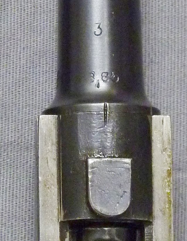

This pistol discussed in http://forum.lugerforum.com/showthread.php?t=34565. Witness mark is misaligned.

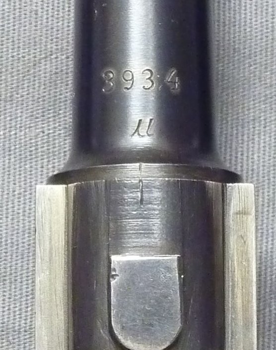

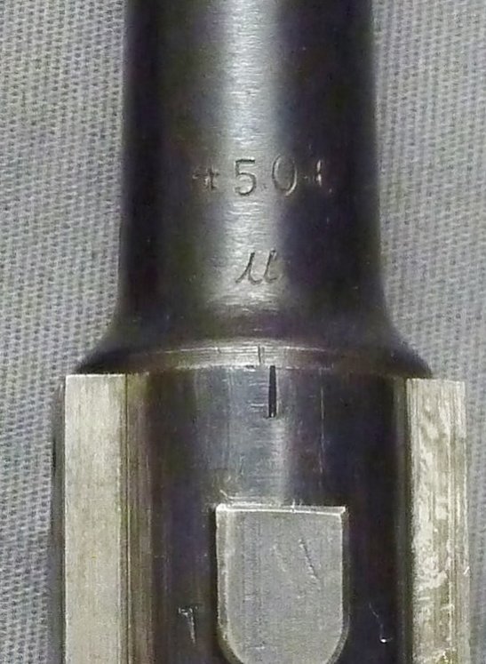

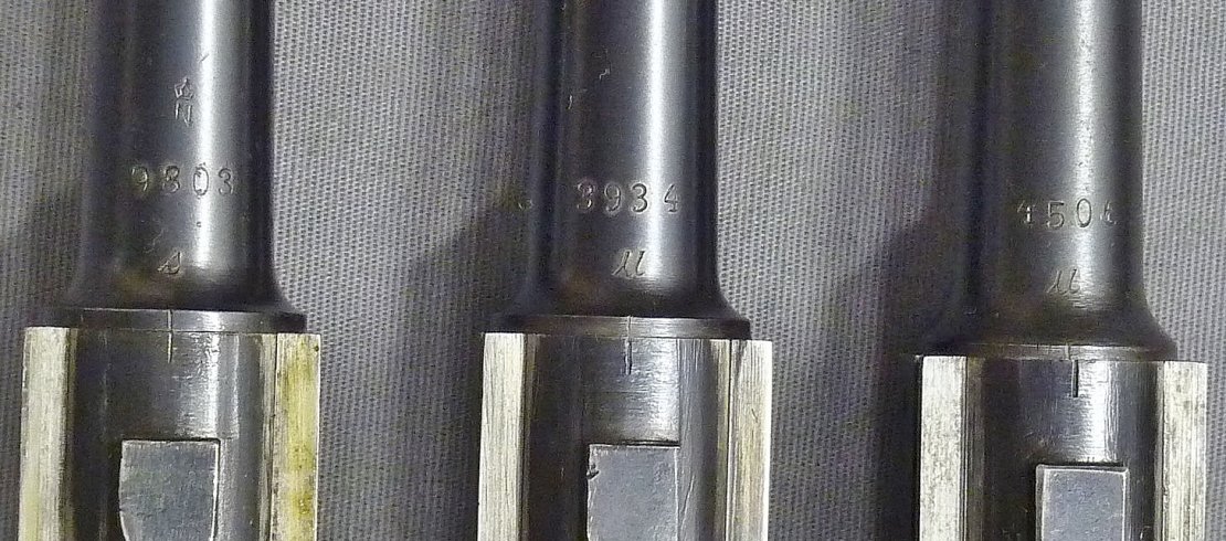

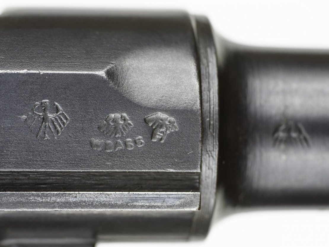

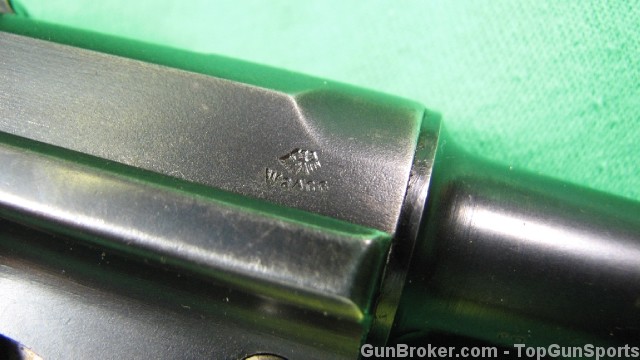

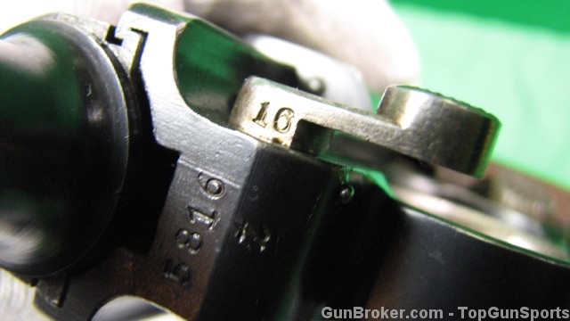

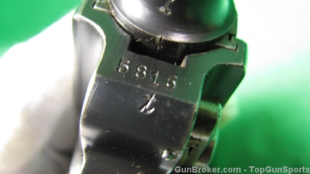

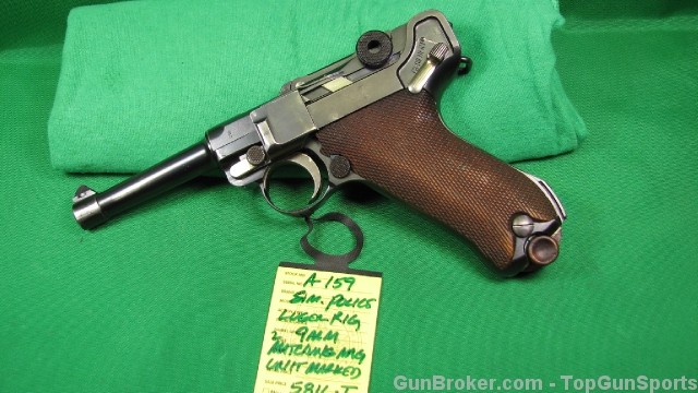

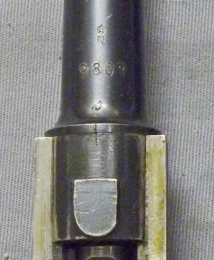

I'll post my close ups here , I like this forum's picture loading better than the GB one.
All pistols are police with the exception of 9803 s which is Weimar Navy N.91.
Pistol 3768 r is not serial number marked on the barrel, but is a police modified '29 comm. with simson barrel and TP marking.
I have also added a t block, that I snatched somewhere; also a police marked pistol with sear and mag safety, and L.G. on the grip.
Don and Dwight,
It would be interesting to hear what you make of these as posted and what you expect or don't expect to see.

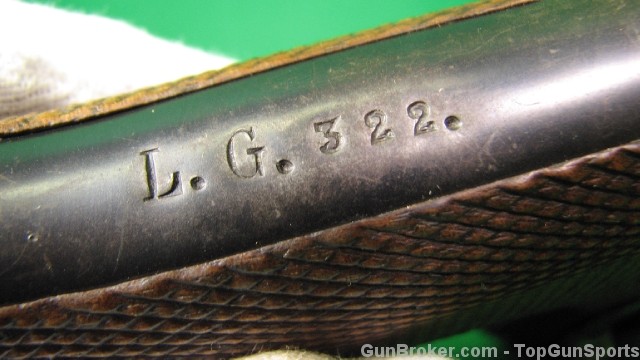

Don,

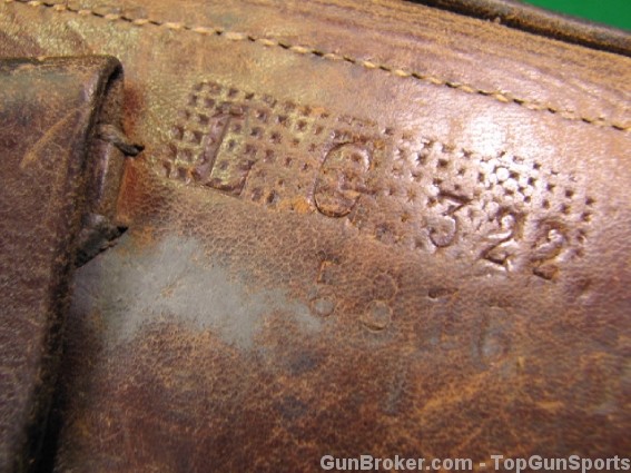

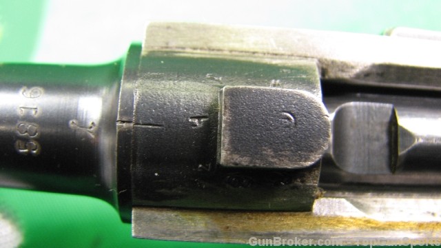

I saved them from an auction or for sale ad.
Don't know who now but here are some more pictures.
There is no view from the top, so no Idea on the toggle,
but the L.G.322. marking must be Landjaegeri , right?

Don,
Aha! Thanks. Yes, it's Landjägerei Gumbinnen. Too bad there's no top view.

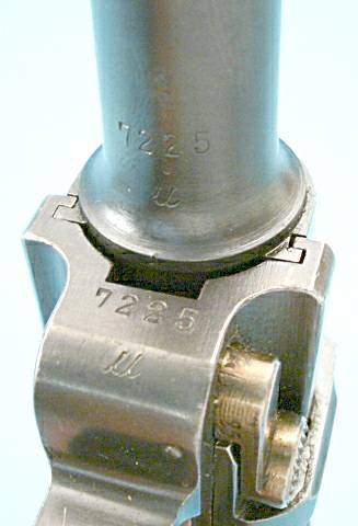

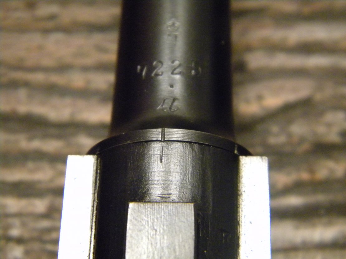

Here is a better photo of H.P. 471 luger SN 7225U
Also since the H.P. luger was in discussion I attached a pic of H.P. 54 SN 1857h

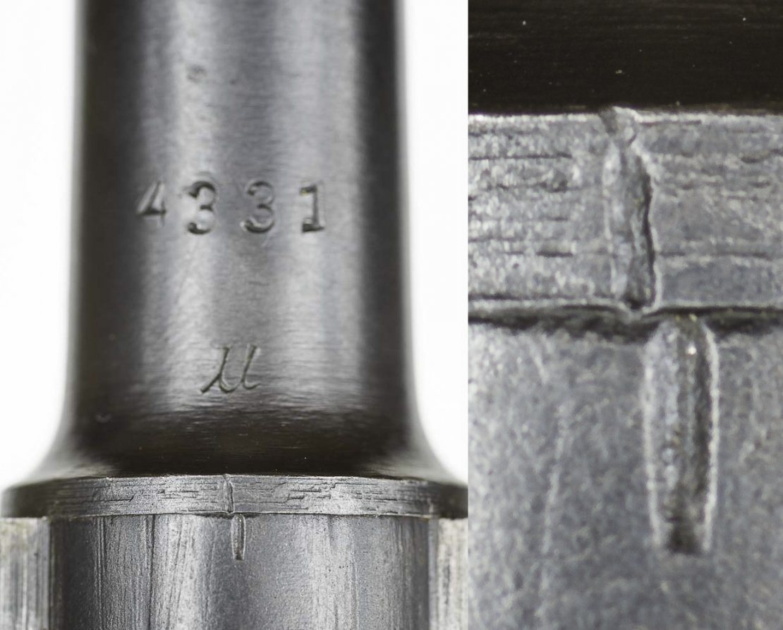

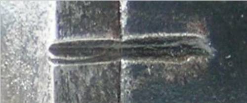

For the record, here is my submission to the 9mm witness mark fest.
4331u is a Rif blank toggle police pistol. It has only the full suite of army acceptance and proof, no c/N.

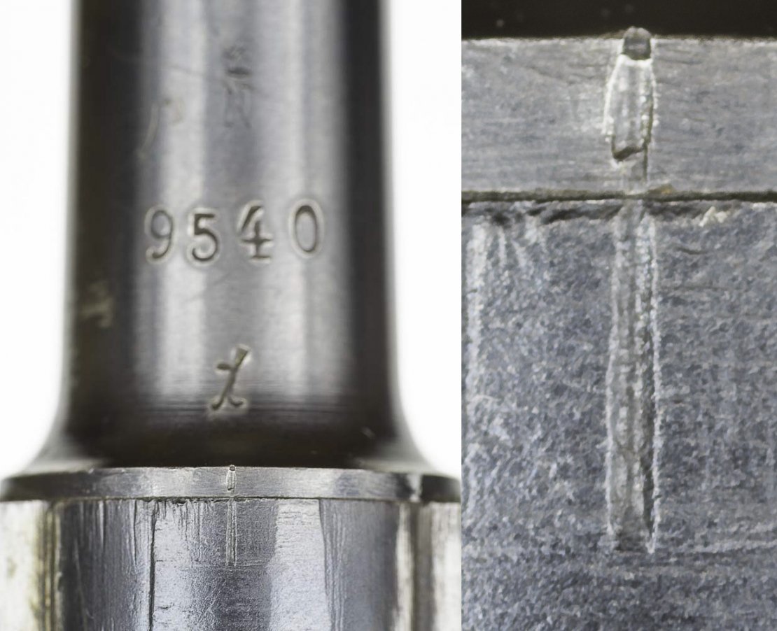

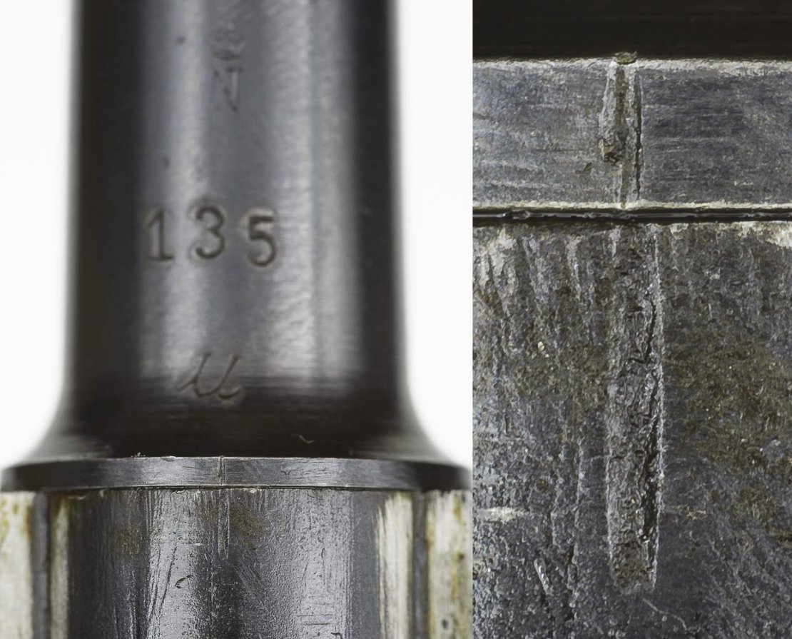

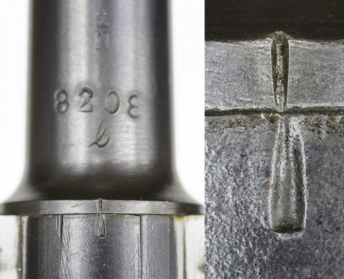

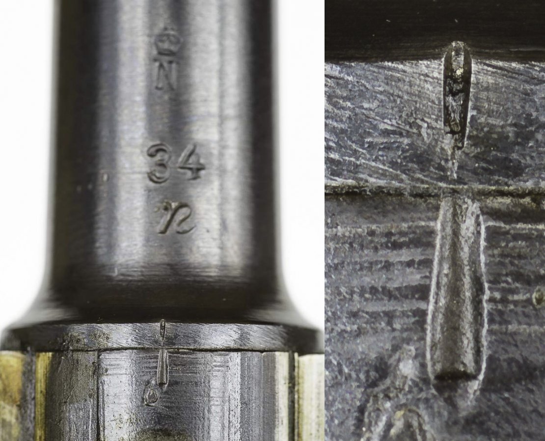

Since we are discussing witness mark evidence, it occurred to me to examine the Alphabet Commercial Lugers with original 7,65mm barrels which I have on hand.
It appears that what is understood as a complete, proper witness mark is not characteristic of Alphabet Commercial Lugers. I did not expect this result. Haphazard witness marking goes clear back to the i suffix range, although I did not prepare any of these for presentation. It is necessary to go clear back to Old Model and New Model Parabellums and Imperial army P08s to see what proper witness marking looks like.
The reason for non-standard witness marking on 7,65mm Alphabet Commercials is not clear. What is clear, is that witness marks are ultimately not useful for determining the originality of 9mm barrels on police Lugers in the s, t, and u suffix range.
The following 2 members says Thank You to Dwight Gruber for your post:

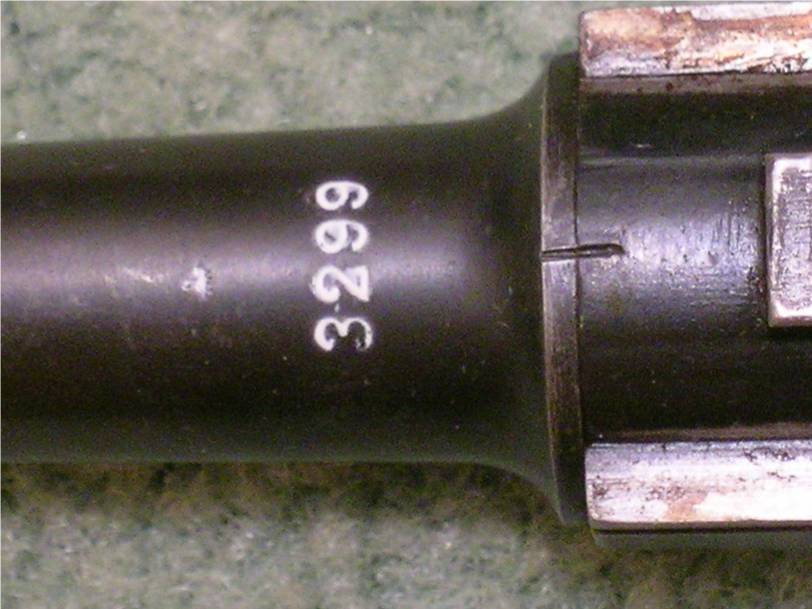

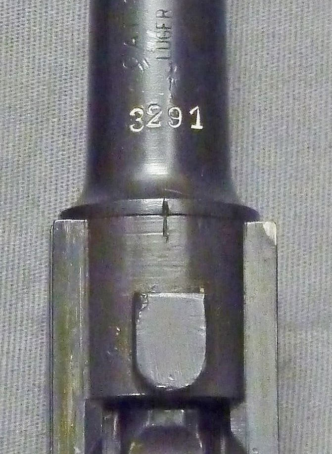

(I thought I posted this at the same time I posted it on Still's forum. I guess I forgot to hit the right button.)
First, I wish to sincerely thank Dwight and all who have contributed and/or participated in this discussion. I agree with Dwight that everyone should continue to ask the "old" questions. Almost nothing about this hobby is absolutely certain and new information or fresh eyes are always improving our understanding.
Reluctantly, I agree with Dwight that witness marks are of little use in this study. As a case in point, I have attached a photos of the witness mark on my 9-mm DWM P08 3299q with Polizeischule marking P.M.477. According to Still (Weimar Lugers, p. 15), this pistol was manufactured in 1927. Years ago, Dwight and I argued about this mark back and forth. I strongly felt the witness mark indicated an original barrel but he disagreed. Since then, I have learned more and now believe it is a replacement as evidenced by the small eagle (Simson?) above the serial number and the lack of a letter suffix. This was the first but certainly not the only instance of "Dwight's right!"
As for the original question, "Did DWM/BKIW Resume Manufacture of 9-mm P08s in the late 1920s?", the answer is "Yes." The Dutch Navy Contract pistols and the 9-mm pistols and barrels shipped by BKIW to Mauser in early 1930 establish this convincingly.
An ancillary question is "Did DWM manufacture 9-mm pistols for the Rif contract?" I believe the answer is "Very Probably." DWM was permitted to manufacture and export 7.65-mm Parabellums throughout the 1920s. If the Rif pistols were 7.65-mm, there would have been no need for the subterfuge of blank toggles. (The possible exception would be if the customer for these pistols was considered politically sensitive.)
The other question is "Did BKIW manufacture 9-mm P08s for the German police in the late 1920s?" I would say "Probably." Beginning in 1927, the police armory at the Polizeischule für Technik und Verkehr (PTV) became the central purchasing and repair facility for Prussian and later all German police weapons despite the IMKK prohibition. This facility would have been the one to rebarrel 7.65-mm Parabellums. It used the PTV/eagle stamp on replacement barrels. There are many 1928-29 manufacture police 9-mm P08s without this stamp, suggesting they came from the factory that way.
Don
donmaus1@aol.com

Alphabet Commercial pistols in the u suffix range are reported with c/N commercial proofs until sn 1198u. This serial number begins the range of u suffix pistols which are almost exclusively reported with a suite of three army acceptance and proof stamps on the right receiver, and no c/N commercial proofs.
Almost all u suffix pistols are reported with blank toggles, with an occasional DWM toggle salted in. These are all police pistols in 9mm, nearly all unit marked to the Landjägerei.
The army proof set, the blank toggles, and the police pistols all vanish abruptly at sn 6034u, to be replaced mostly by specialty production in 7,65mm and with c/N commercial proofs. This extends into the v suffix range, where DWM production ends at approximately sn 559v. There is one major exception in this late-u—early-v suffix range: all the reported examples of Hessische Polizei (H.P. )new production, in 9mm and c/N proofed, are found here.

The eagle/WaA66 stamps are found on the right receiver, the position specified for army acceptance markings since the 1910 army instructions for the manufacture of the P08, and carried out through the end of WWII.
Many of these pistols are found with the additional stamp of a small, almost vestigial eagle, or an eagle/H. Although these stamps are in the position indicating power-proof, the pistols display no other army power proofs.
Enduring questions remain about the purpose of these right-receiver stamps. It is clear that an army acceptance officer was stationed at DWM, but it is not at all clear for whom he was accepting these pistols, or why? The only reason for the certification of army acceptance would be if these pistols were produced to the military 9mm specification. The pistols were not acquired by the army, and the police had no need for army acceptance.
The range of 5,000 or so pistols with the three-stamp suite, and whatever reason might exist for them, is even more mysterious. On the pistols with three stamps, the third stamp is almost always an eagle power-proof stamp, in the style adopted by the German government dating from 1936-1939. A matching stamp is found on the barrel in the customary position for power-proof. The anachronistic nature of this stamp is simply imponderable.
