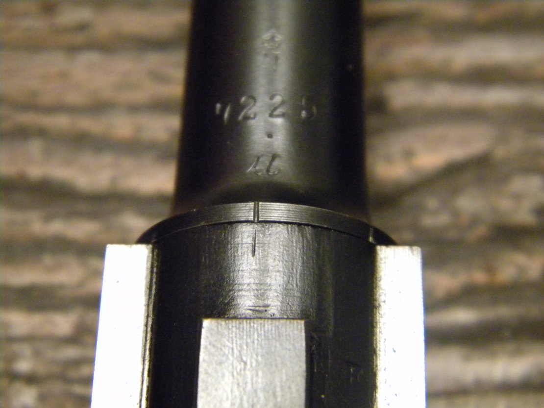

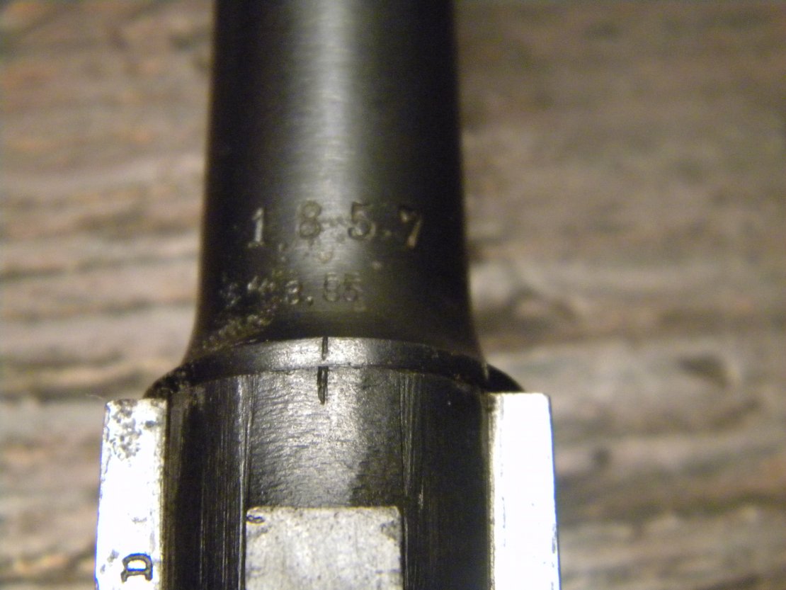

skeeter4206 08-15-2015 08:29 AM
2 Attachment(s)
Here is a better photo of H.P. 471 luger SN 7225U
Attachment 51040
Also since the H.P. luger was in discussion I attached a pic of H.P. 54 SN 1857h

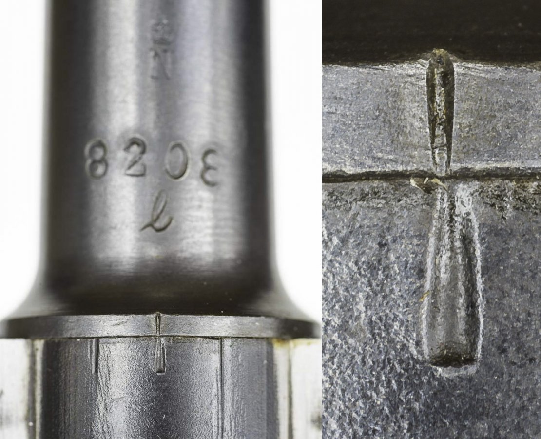

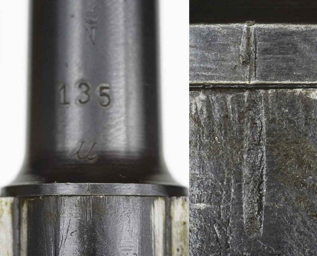

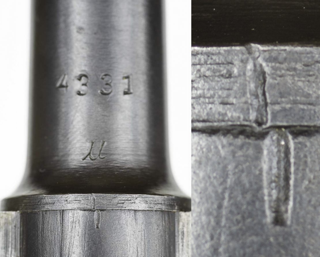

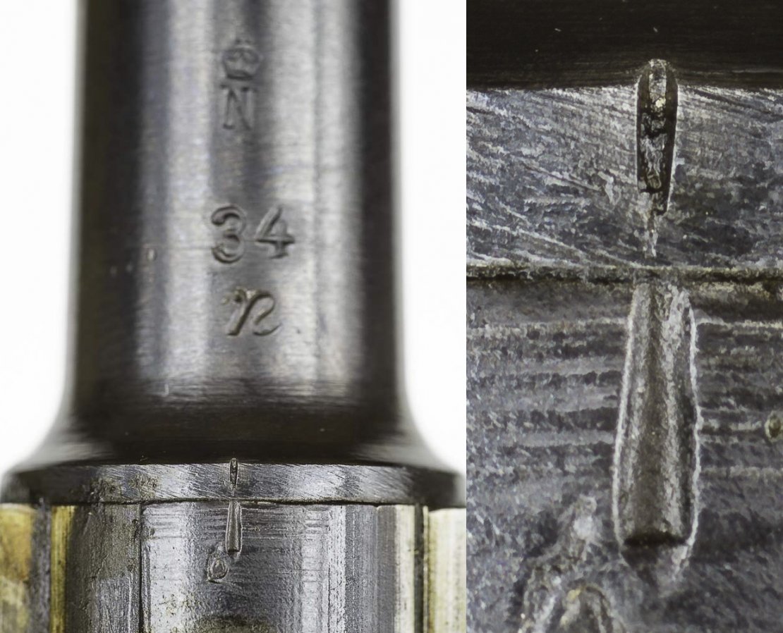

For the record, here is my submission to the 9mm witness mark fest.
Attachment 51103 Attachment 51104
4331u is a Rif blank toggle police pistol. It has only the full suite of army acceptance and proof, no c/N.
Since we are discussing witness mark evidence, it occurred to me to examine the Alphabet Commercial Lugers with original 7,65mm barrels which I have on hand.
Attachment 51105 Attachment 51106 Attachment 51107 Attachment 51108
It appears that what is understood as a complete, proper witness mark is not characteristic of Alphabet Commercial Lugers. I did not expect this result. Haphazard witness marking goes clear back to the i suffix range, although I did not prepare any of these for presentation. It is necessary to go clear back to Old Model and New Model Parabellums and Imperial army P08s to see what proper witness marking looks like.
The reason for non-standard witness marking on 7,65mm Alphabet Commercials is not clear. What is clear, is that witness marks are ultimately not useful for determining the originality of 9mm barrels on police Lugers in the s, t, and u suffix range.
