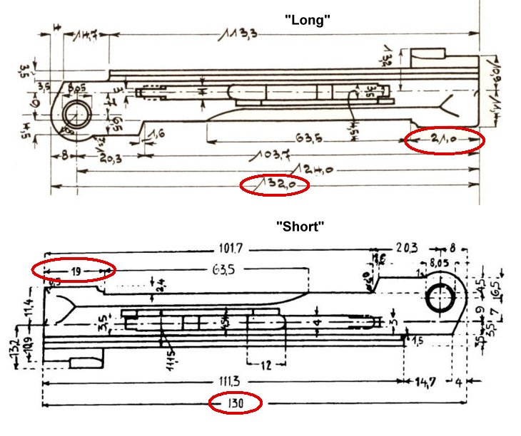

I don't think the front of the frame has been shaved, it's more likely that that undated receiver is from a long frame gun.
Norm, the displacement doesn't look large enough for the long/short frame swap...
(If anyone else is thinking of bidding, be aware that my absolutely top bid will be $120...OK, maybe $150...You'll have to beat that...)

...the displacement doesn't look large enough for the long/short frame swap...
The difference between a long and short frame is only 1mm.
Dwight, I don't have a stripped barrel or barrel extension of either here to measure, but reading the prints it looks like 2mm...or .078"...
