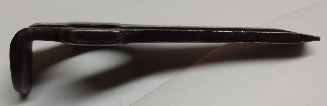

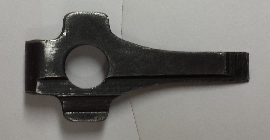

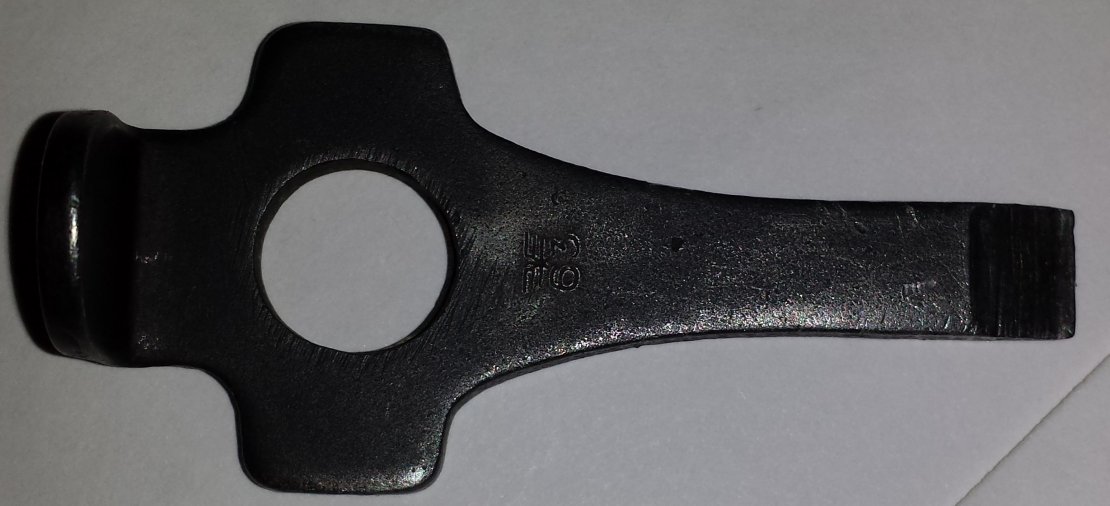

Here are some better pics; thank you in advance.

The one you show here..from these pics I don't like it. Do you have it in hand? There appears to be NO lip in the hole to grasp the follower button and hold the tool onto it for loading. Fake tools are often made this way and they just slip off the button. Could just be the pics but I don't see it. I also suspect the blue/black color and metal texture? Looks painted..I can't see the screwdriver tip well enough either...too dark.

In the eBay pic, the light is coming from overhead, slightly to the right and behind the tool--check out the shadows... The radius on the bottom of the button hole has a hint of a lip. Compare the edge there to one oriented the same way to the light, the upper right shoulder. eEven when you consider that the button hole, milled, will appear slightly sharper than the stamped edge of the shoulder, there's something more there. None of these photos is particularly revealing, due to bad angles, being out of focus, and glaring light.

I have 6 light different variations of the stick winged eagle with 63. It seems to be the tool with the greatest of the eagle 63 acceptance marks. I have not seen many of this variation but it is with the smallest of them rare. Without a doubt it is original.

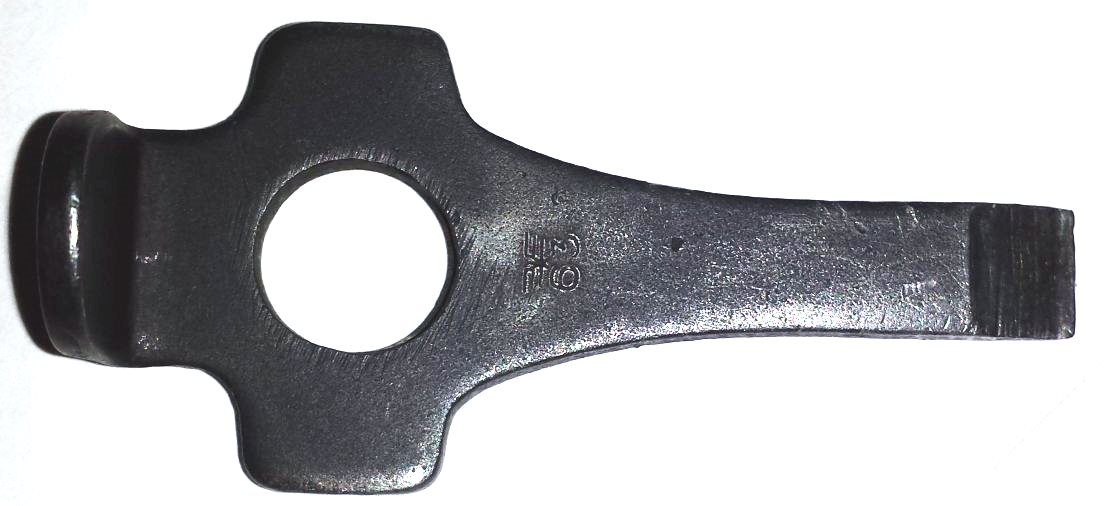

Jerry, I think the shadows in the photo are obscuring the view of the "lip"... I tried looking at the photo in high magnification..., and then played with the brightness and contrast, and came up with this. I think the lip is there...
Unread 09-04-2014, 01:17 PM   #11
John, I tried the same thing and I agree that it appears that there is a "lip"...but man, that has to be the most shallow lip I have seen. I am glad Klaus authenticated it.

Thank you for the info. I checked and there is a lip. Now I know more of what to look for; much appreciated.
