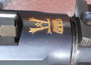

I saw this as an avatar on Jan's Forum. At first I thought a 1900 Luger, but it seems to have a rear sight (but not an artillery) mounted on the barrel.
Is it a Masonic Luger?? A Japanese Luger?? [A Torii??] Is it a Luger at all??
Flat breechblock/extractor...
BTW: The member, Luger666, does not answer PMs.

just ask him in public - he answers my PM's (usually when he is mad at me)
I wondered too - not sure what it is, danish?

The unknown symbol appears to be on a M1902 Presentation Carbine (M1900 extractor, rear of Carbine rear sight and Portugese type crown over an unknown symbol. TH

It is the crest of Graff Anton (“Max Egon II, Fürst von Fürstenberg (Prince of Fürstenberg (Baden-Württemberg) – Maximilian Egon II Christian Karl Aloys Emil Leo Richard Anton, known by his family name Anton”), a royal personage at the time of Kaiser Wilhelm II. It is a presentation carbine serial number 9110C with the early push-button stock. It is GL marked on the rear of the toggle. It was purchased by Mark Rendina at the last James Julia auction. It was formerly in the collection of Dr. Sturgess and has excellent provenance.

Thanks Ron!
I found two threads by searching for 9110C -
http://luger.gunboards.com/showthrea...at-James-Julia
http://luger.gunboards.com/showthrea...bine-SN-9110-C
