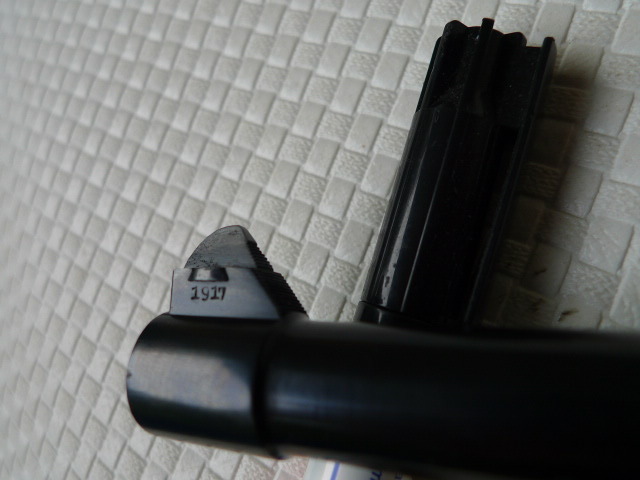

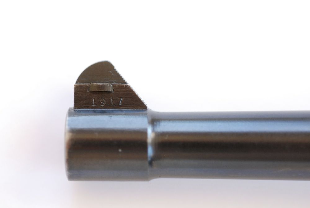

Hi Fellas, The seller does describe it as having been professionally reblued. However, even with the poor photos posted there are enough signs to lead me to suspect that this Navy is a ground-up fabrication. The 1917 on the front sight block, for example.
Regards, Norm
