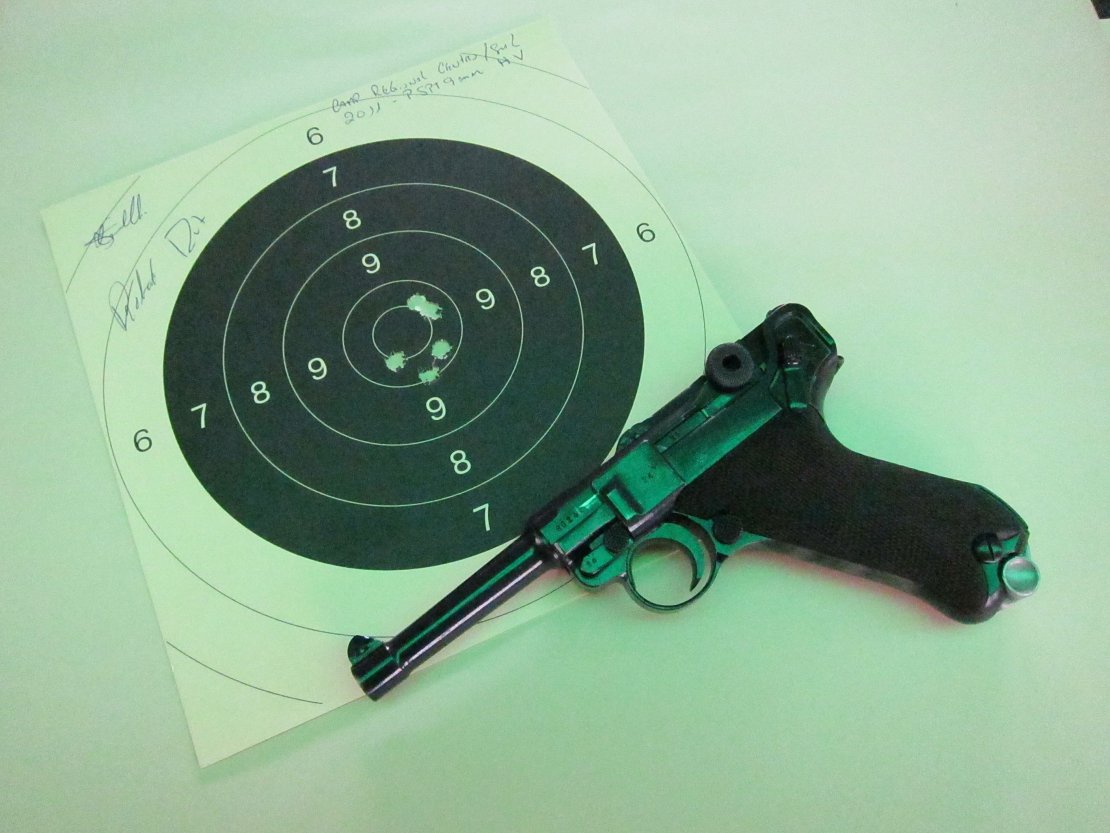

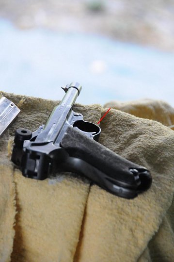

Unread 10-13-2013, 04:13 PM   #12
K, I've straighten a few mashed in tigger guards with a conical wodden mandrel, but none of them came out perfect, so hesitate to do it for anyone else. TH
Unread 10-24-2013, 10:44 AM   #13
kurusu
Join Date: Sep 2007
Posts: 1,225
Thanks: 2,679
Lots of food for thought in here. I'm not going to rush anything but think carefully on the best approach.
I've added a photo, but it's very hard to see what's wrong.
The photo was taken in a competition by a fellow shooter and not to show the damage. I'll take a better photo on the weekend
The lanyard ideia is not feasable. It's not casual shooting but official target shooting.
And it does shoot

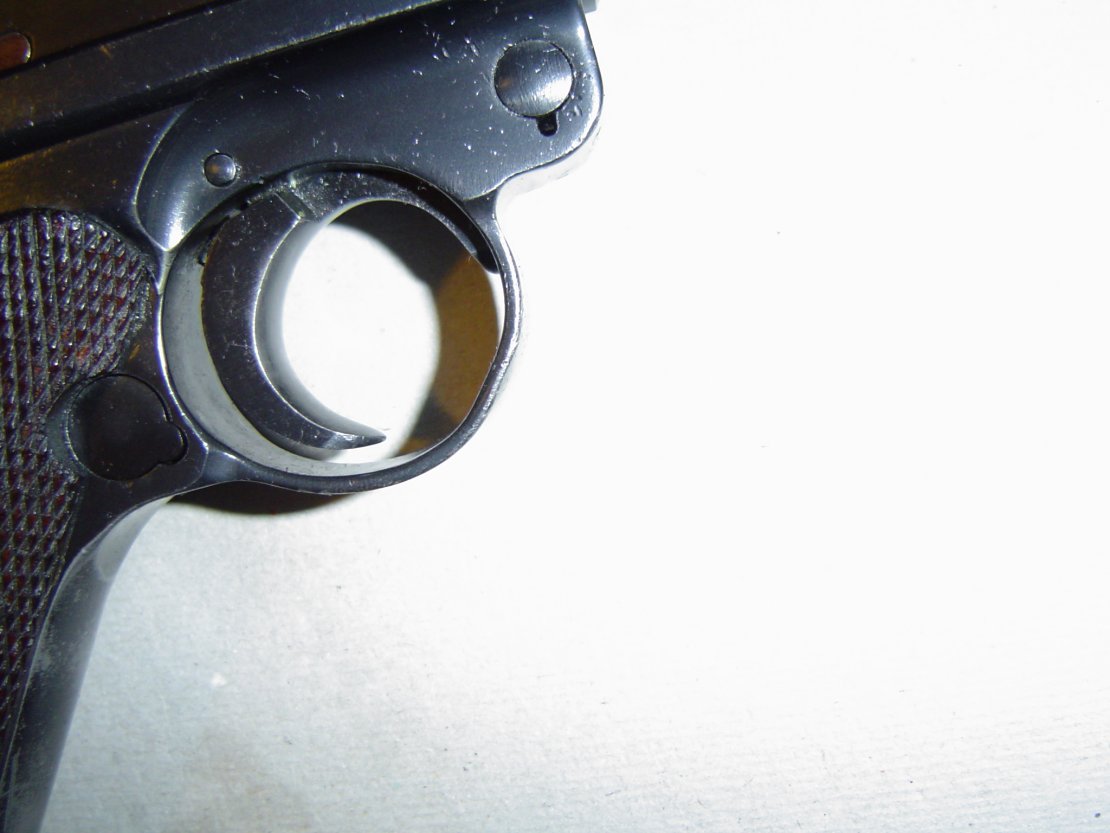

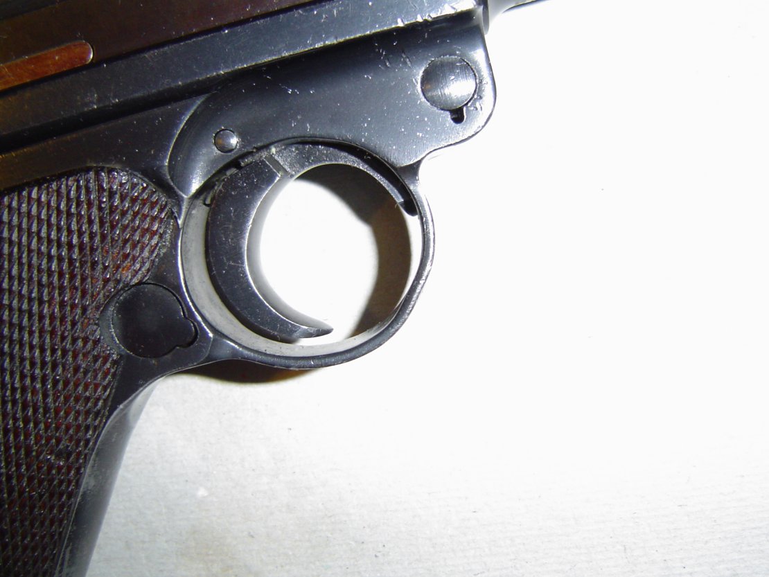

Unread 10-28-2013, 04:46 AM   #15
kurusu
Join Date: Sep 2007
Posts: 1,225
Thanks: 2,679
As promised here are some photos of the affected area
Hope it helps.
