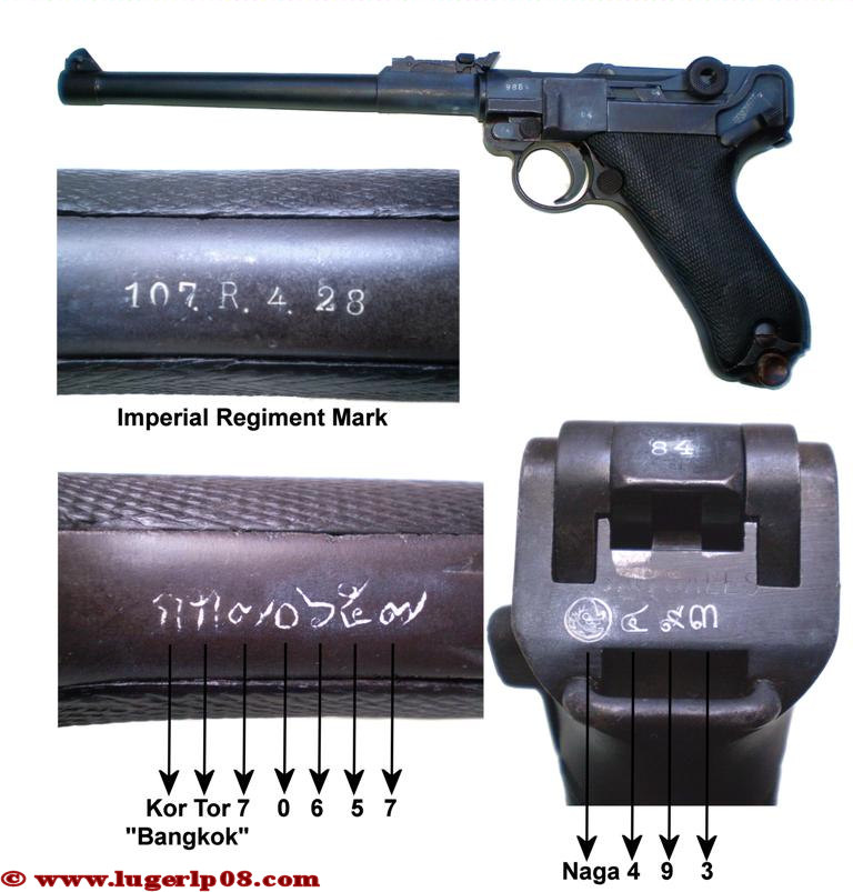

One of the main differences between the Mauser Parabellum and the Imperial ones, used by the Thai Police, is a specific Bangkok (Kor Tor) mark (see the paragraph Kor Tor).
Until now, no Mauser Parabellum pistols have been reported with this specific mark.
Only a small number of Imperial Lugers with Thai Police marks have been reported, but they are enough to propose possible theories.
Before introducing the theories, let’s clarify the meaning of the marks.
Picture 1: From the Görtz Archive: M. Baudino Collection

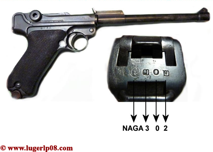

Picture 2: Imperial Artillery Luger with Regimental Mark, Kor Tor and NAGA marks. M. Baudino Collection

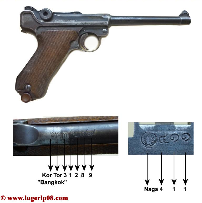

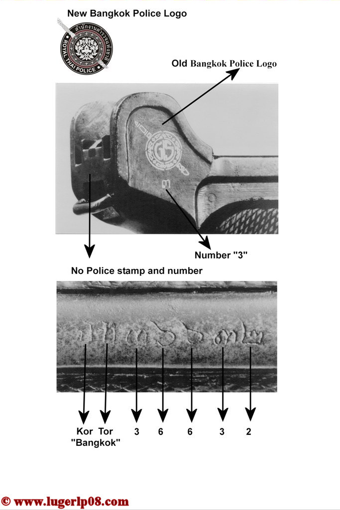

Kor Tor (กท)
Kor Kai or Kor (ก) is the first letter of the 44 letters of the Thai alphabet.
Tor Thahan or Tor (ท) is another letter of the Thai alphabet.
This acronym is read "Kor Tor (กท)" and it is considered to be the abbreviation of Krung Thep, the Thai name for Bangkok, the capital of Thailand.
This interpretation has been validated by Thai sources (see paragraph Sources) as well as by the Thai Embassy in Italy.
Considering the fact that, one of the pistols with the Kor Tor mark shows an Old Bangkok Police Logo supports the interpretation of Kor Tor as the abbreviation of Bangkok.
The number that follows is definitely big and cannot be considered the number of pistols in use. It is most probably a serial number for all the guns available.
NAGA
The NAGA is a mythic animal for Thailand.
One of the more beautiful elements of Thai temples and spiritual places is that of the Naga. Naga is a Sanskrit and Pali word for a deity that takes the form of the great snake, often a king cobra.
For the occidental point of view it is easy to confuse the mark used in the Parabellum pistol, above the lanyard ring, with a lion or an elephant instead of a Naga, closer to the Thai tradition.
The author considers more realistic the interpretation of this symbol as a NAGA instead of a Lion or an Elephant although there is not definitely evidence of that.

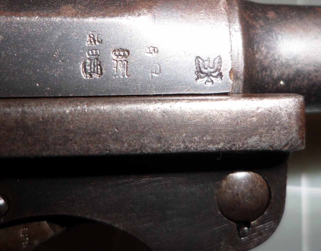

Picture 3,4: NAGA, it is mythic animal for Thailand.
Picture 5: Imperial Navy Luger with Kor Tor and NAGA marks. Giuliano Alfinito Collection
Picture 6: Rebarreled Imperial Artillery Luger with NAGA marks. Courtesy Giuliano Alfinito.
Consideration
The first picture form the Görtz archive, shows a Imperial Parabellum with the Kor Tor mark but no the NAGA.
The second and third Imperial Parabellum described, have both the Kor Thor and the NAGA marks.
The Fourth and then all the Mauser Parabellum don’t have the Kor Thor mark.

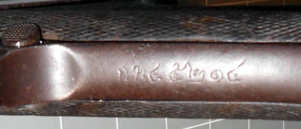

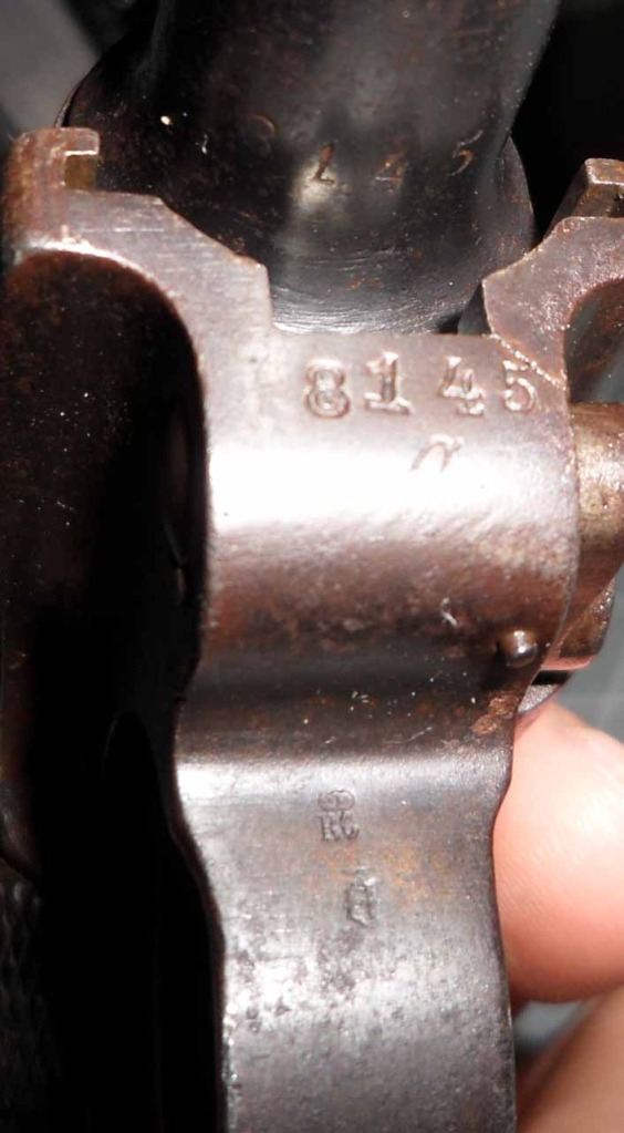

I have been doing research all night on a Luger I picked up at SAR West today- it was sold as a 'Tibetian' Luger, but the price was right. Turns out it's Thai Police
No Naga mark on mine, but it has the Kor Tor front strap markings, and what looks like 45214 in Thai numbers.
Mine's an Erfurt 1917 non-artillery (standard barrel). All matching (period correct wood bottom but not number matching mag) and mechanically sound, but with pitting under the grips (typical of anything used near the ocean- I've seen Shanghai Piloce guns look similar, or usually, worse!).
Nice to see you guys worked out a hypothetical timeline already!

Postino: the Thai police received initially German WWI surplus, it means that they received several types of gun (P08, LP08, Navy...) without a real possibility of selection. I know that also C96 are reported with Thay marks and it should be nice to find out some specimens. Then, in 1936-1937 the Thai Police decided to buy additional pistols. In that period, the only new German P08 and LP08 were available in Mauser therefore it seems logic to me that they ask Mauser for new pistols.
saki302: happy to see that you find here the solution for your Luger. Please post some pictures; the idea of this topic is to collect as much specimens as we can.
You are right, usually the pistols from Thailand are far to be in mint condition; personally I am happy with my artillery that is correctly numbered (except the magazine) and it is in well preserved when compared with others Luger not only the ones coming from Thailand. My Arty is a 1917 specimen with Imperial regiment mark (not common for 1917) and with front and rear sight adjusting screws.
Your pistol is interesting as well because, like the first one presented from the Görtz archive, has only the Kor Tor mark and not the NAGA.
This confirms the hypothesis that initially the pistols received the Kor Tor mark, then the NAGA was introduced and the Kor Tor pistols still in service were re-marked with the NAGA stamp.
At a certain point, only the NAGA stamp was applied; this is why the Mauser Parabellum have only the NAGA.
Looking forward to see your Luger.

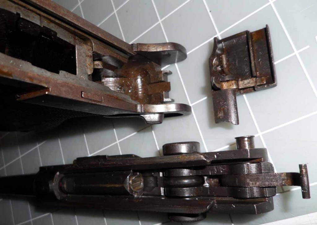

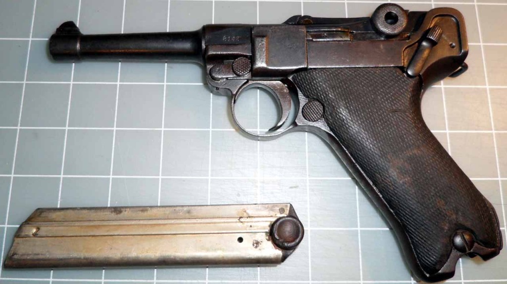

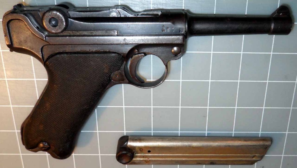

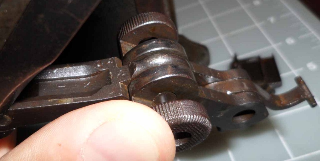

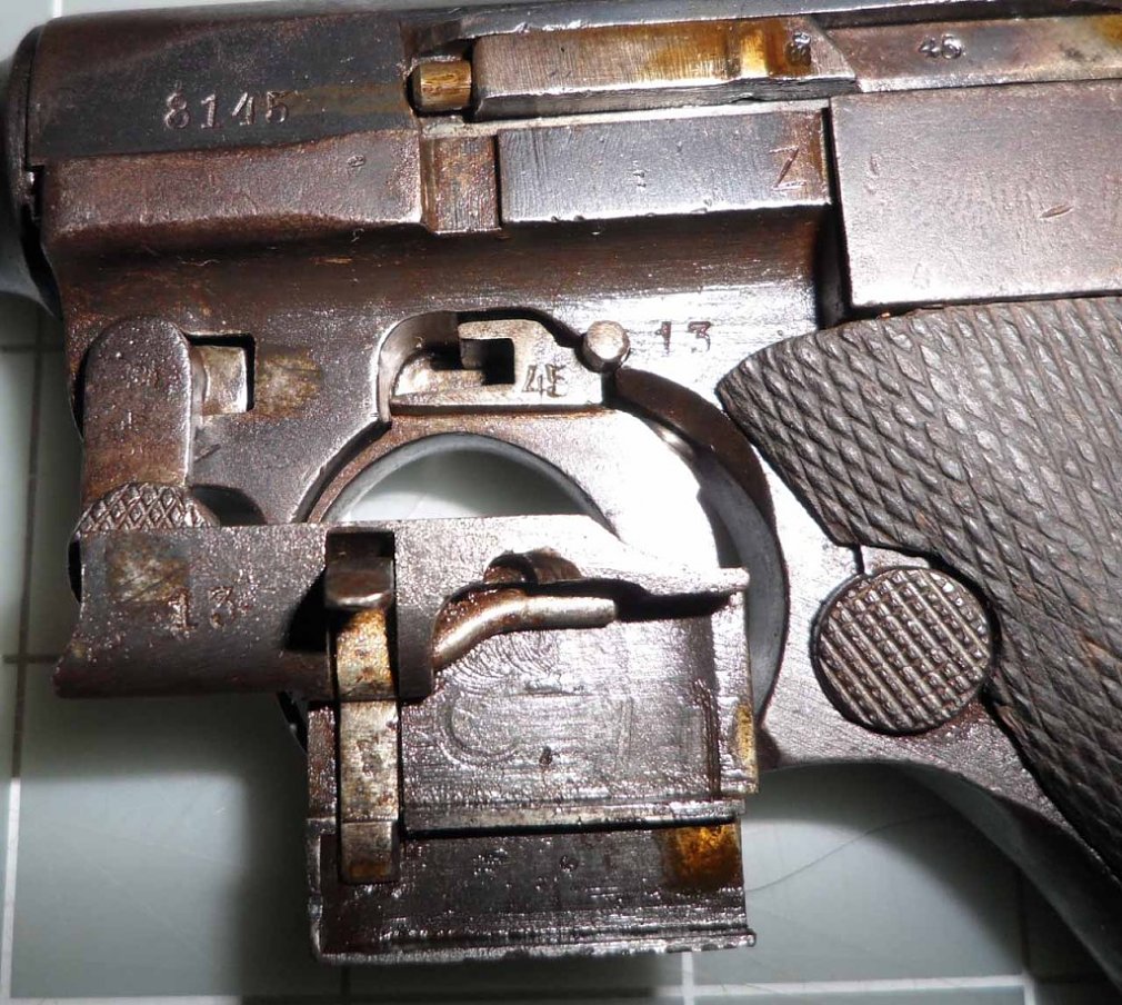

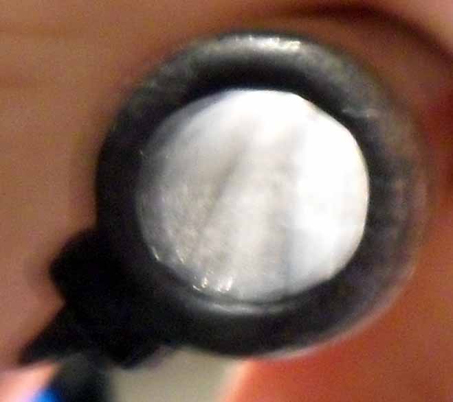

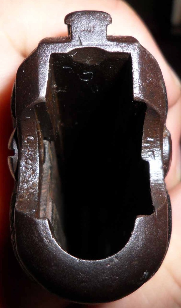

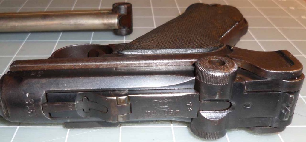

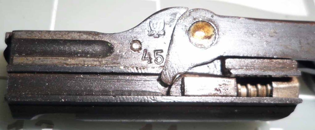

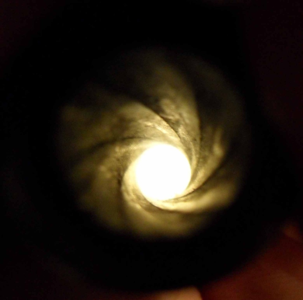

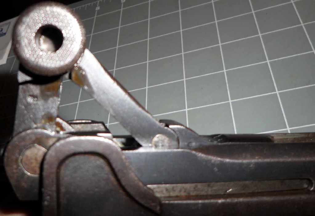

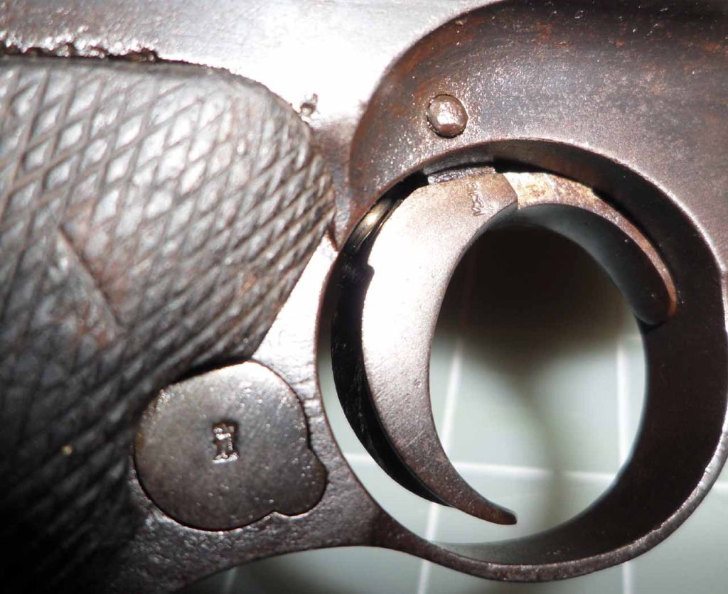

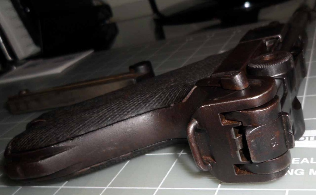

I took photos of all the various parts, proofs and the front strap on my Luger and put them on photobucket.
You can see the pics here:
http://s1028.photobucket.com/albums/...20Tor%20luger/
Maybe you can make something more out of this odd old Thai pistol
I replaced the springs with Wolff (but I kept the originals), and took it out and fired it. It seemed to work quite well with a spare modern Luger mag I have (I didn't use the original since it won't lock the slide back anymore- it does seem to feed fine though).
-Dave

Default Repost Pictures to This Site
Hi, Since this thread has been made a "Sticky Posting" and PhotoBucket and other remote sites sometimes lost things, I've reposted Dave's pictures to this thread directly on this site.
Unread 02-14-2011, 10:50 PM   #15
Default Part 2 of Reposting Dave's Thai Pictures
More:

Truely awesome. Such research. Not a big surprise but I didn't even know they existed. Wonderful of you to document and share them.
How in the world did someone ever get a picture of the bore!!! Never saw one before.
