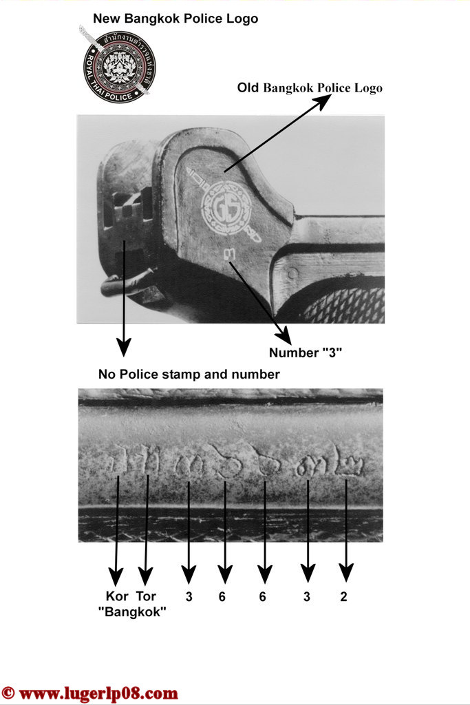

Picture 1: From the Görtz Archive: M. Baudino Collection

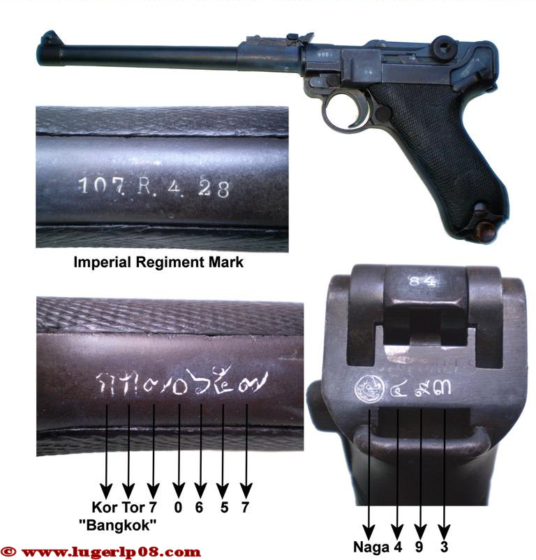

Picture 2: Imperial Artillery Luger with Regimental Mark, Kor Tor and NAGA marks. M. Baudino Collection

Considering the fact that, one of the pistols with the Kor Tor mark shows an Old Bangkok Police Logo supports the interpretation of Kor Tor as the abbreviation of Bangkok.
The number that follows is definitely big and cannot be considered the number of pistols in use. It is most probably a serial number for all the guns available.

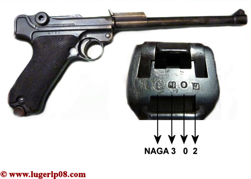

Picture 5: Imperial Navy Luger with Kor Tor and NAGA marks. Giuliano Alfinito Collection
Picture 6: Rebarreled Imperial Artillery Luger with NAGA marks. Courtesy Giuliano Alfinito.

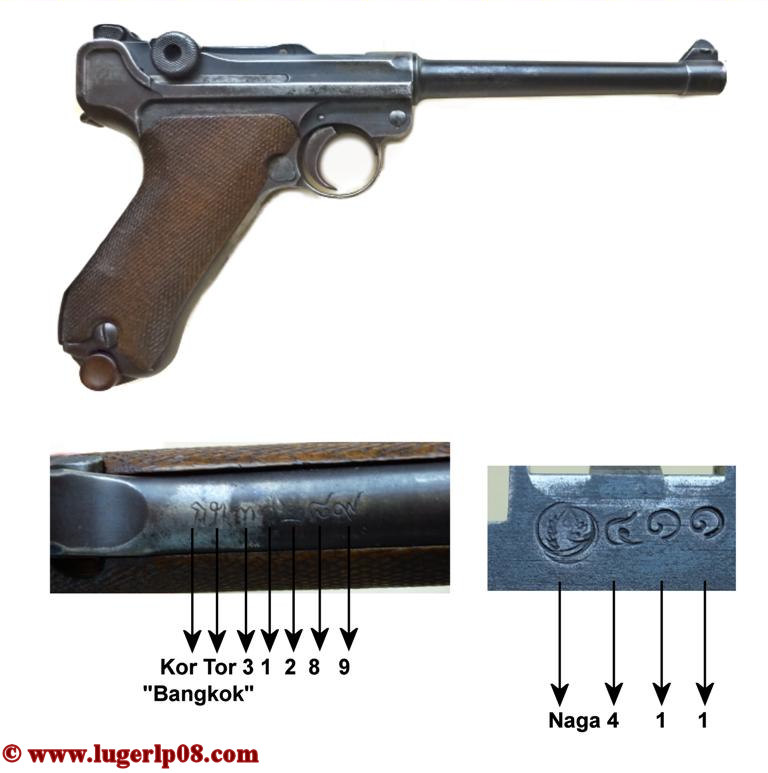

The first picture form the Görtz archive, shows a Imperial Parabellum with the Kor Tor mark but no the NAGA.
The second and third Imperial Parabellum described, have both the Kor Thor and the NAGA marks.
The Fourth and then all the Mauser Parabellum don’t have the Kor Thor mark.
