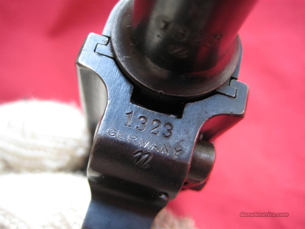

I love going to the range especially with my GLOCK 19 GLOCK 23 also because I 'm aware that if by pure chance something goes wrong wouldn't be a big issue. I agreee that if a numbered part of your LUGER breaks, you will have reduced its value by an awful lot, listen to me, do not take any risk and keep it immaculate.
Unread 08-21-2013, 06:41 PM   #16
I am totally lost.
So, was gun with n suffix made in 1920 ?? In that case, my Luger was also made in 1920 (I wrongly thought it was made around 1923 in the past).
Or, is n-series with 1920 chamber date unrelated with mine (the chamber on my instance is blank, no year),,, a separate series ??

Unread 08-21-2013, 09:37 PM   #17
Don M
Don M's Avatar
Join Date: Aug 2004
Location: Houston, TX
Posts: 1,429
Thanks: 67
Alvin, you are correct that your gun, with an "n" suffix but without a chamber date, was made in 1923 as a commercial. John's gun, with an "n" suffix and with a 1920 chamber date, was made in 1920 under a contract for military and police P08s. They are separate series. The 1920-dated n-suffix pistols are a bit of a puzzle.
