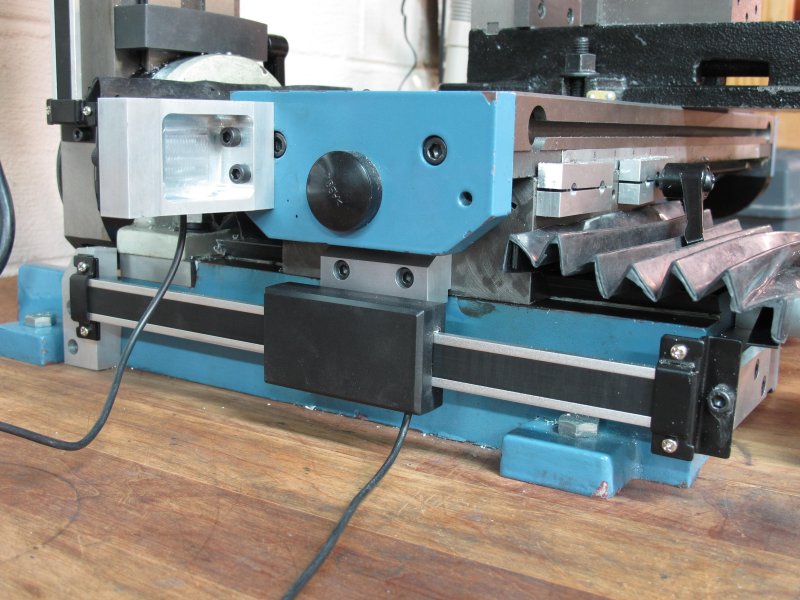

I think I'm going to upgrade mine to some kind of simple DRO. I have seen them made by modifying and attaching digital calipers, which would make it accurate and very easy to read. I added that to my mini mill a while back, and it makes life so much easier.
I really don't know enough about DRO's to tell what you're showing...
I had looked into DRO's some years ago and the ones I looked at fastened to the table and had a 'tire' that ran along the way...Didn't look too dependable or trustworthy to me...
I'm looking at several in Travers catalog and I can't tell how they measure the distance traveled except that I don't see that stupid 'tire' so I'm guessing they use some kind of linear gradient to measure with...
Even the 2-axis DRO's are expensive...
You must have looked at something pretty old, the modern ones work just like digital calipers, with a magnetic strip and a reading unit. I took a chance and bought some cheap ones (here's the 12" model: http://www.ebay.com/itm/12-Digital-R...ht_1231wt_1249), and they have worked great. It's a "universal fit" so it took a bit of thinking and tinkering to come up with good locations, brackets etc, but they make life so much easier. No more counting turns, just crank it and read the display.

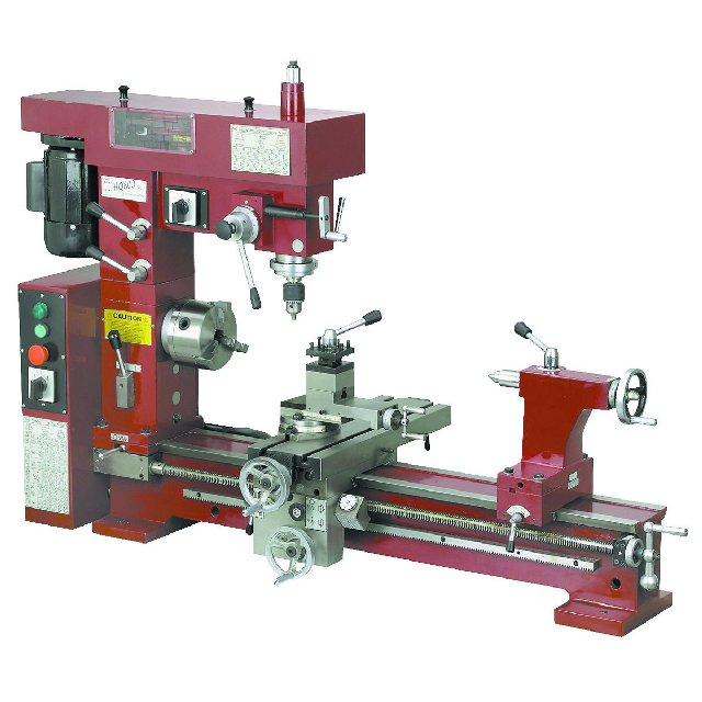

My 3in1 [pic below] has a 40" bed but only 33" of it is really usable...And the cross feed is 18" but only 7" is usable...
I'm thinking one 35" and one 12" and I'll cut them to fit...

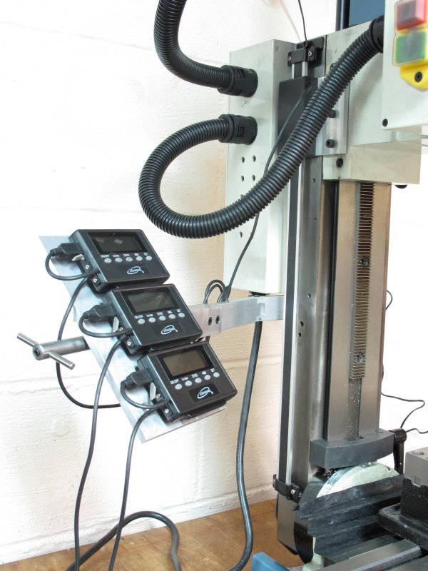

I'm wondering if the display is quick-changeable...can you use it for x axis first, then change leads and use it for y axis??? That would cut down the number of heads/displays...Or will the display show all three axes at once???
Edit: Oh, I see what you did...You have three displays on a 'gang' mount...Clever...

One good thing about these DROs is that they have separate displays. I believe Shars and others sells a similar setup but with 3 displays in one unit, but that probably means that you have to buy a whole new setup if something breaks. There's also DROs with the readouts directly on the readers (like on digital calipers), but the remote displays are much better as they can be put in a place where you can read them easily. The cross slide might be another story though, on that you may want to go with a direct readout so you don't get the cable tangled up in something. The cables may look like they would be in the way on the mill, but they're really not. And knock on wood, I havent damaged them yet, just make sure they are out of the way so they don't get pinched when you're cranking the table.

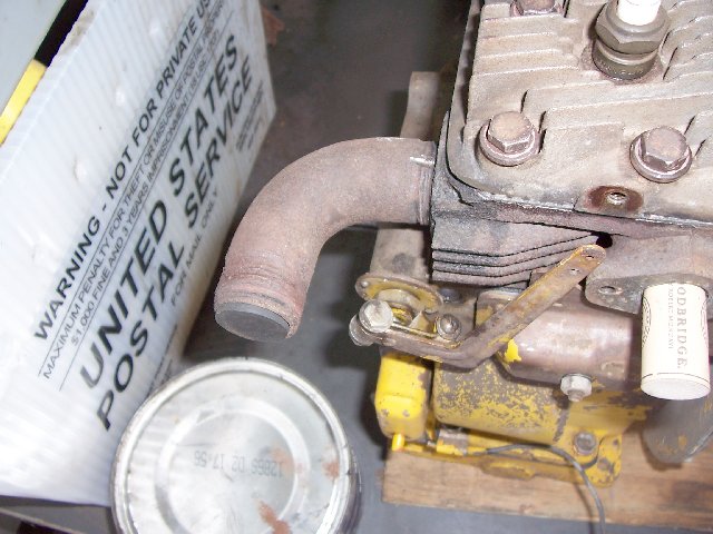

Here's one for you...I have a replacement engine for my infamous riding lawn mower; it has an exhaust pipe with a 1" male pipe thread for the muffler...The threads are all rusty, I can't get the new muffler on...It's a tight 90º bend, how do I chase the threads???
It won't unscrew without breaking the cast iron cylinder (don't ask me how I know) and there's not enough room for a conventional pipe threader...
Anyone have any ideas???
I would try a thread file ( http://tetoolsusa.com/tools/index.ph...25ce84fd19842c ). You can also use a triangular needle file, it has the correct 60 degree angle for this. It's easier than it sounds, the file will follow the thread easily and the rust will be your "layout dye" to show you when you have cut deep enough. It's a bit tedious, but I have fixed many old car parts by simply filing the threads.

I may do that...Travers does have a hexagonal 1" pipe die, but my last order just came (#2 MT reamer!) and I don't really need anything else right now...I do need to make a trip to Sears, maybe they have one...I could probably rent one of those ratcheting pipe threaders from a rent-all place...Throw the engine in the back of the Xterra...Heh..."How much to rent a 1" pipe threader for 5 minutes?"...
Take longer to fill out the paperwork than chase the threads...
