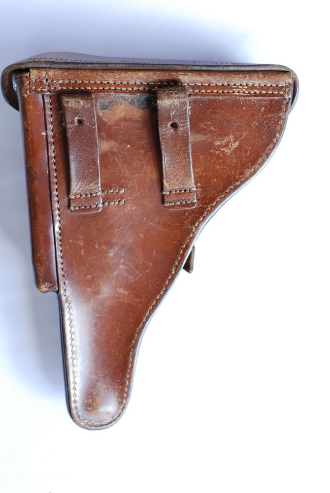

Hi Ron, After 1926 Luger holsters were constructed so that the back of the holster also formed the back of the magazine pouch. On earlier holsters it was separate. The 1942 dated holster you show should have the post 1926 construction. There are other errors too, but this is the most obvious. The first picture shows an early holster, the second a late one.
Regards, Norm

Good catch on the holster, Jerry. I missed the lack of cant to the belt loops and the spurious waffenamps.
This is what happens when you post from work!
Unread 01-11-2013, 07:11 PM   #10
Doug..you don't let work interfere with this stuff do you? HAHA!
Thanks Norm for the very clear differences in the two styles. It's all about the details.

What are the 2 holes in the belt loops for on the early holster?
Or is that a field "modification"

Gary, Of the many holsters I have observed with holes in the belt loops they could be from almost anything you could dream up. Parts taken and made from other leather straps, holes to hang it on a wall..the list is really endless. There is no official reason or common denominator to indicate any pattern I know of.
Sometimes there is only one hole in one loop..I have seen it all but don't know why except for holes from rivets.
