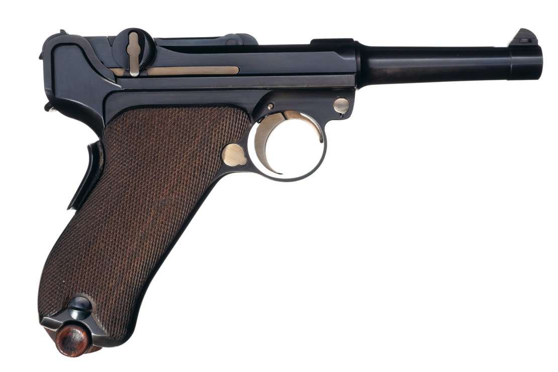

One gun seems to have taken off this year right behind the Test pieces. How many were made? Where can I fint the whole story? Eric, Esq

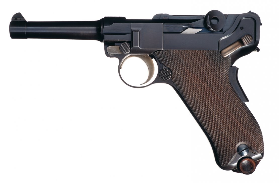

Eric, do you have a picture of the other side?

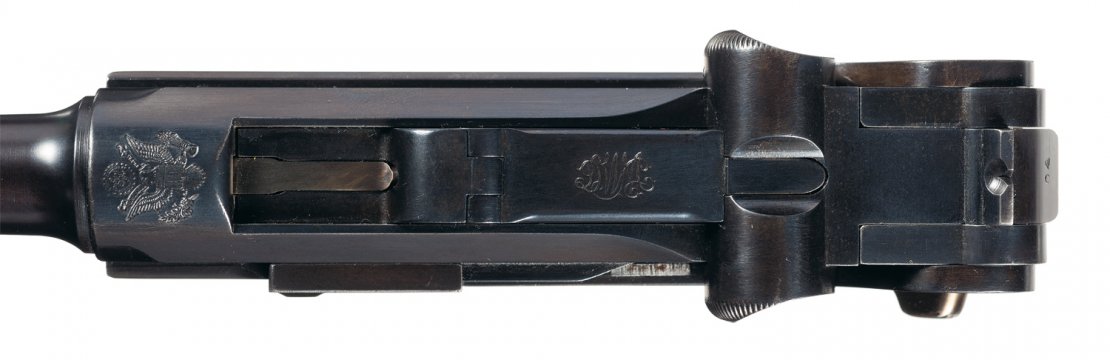

On display Rock Island Auction. My post stroke memory thinks!!

No C/B C/U proofs on the left receiver. Is the serial# in range for a Cartridge Counter? The front of the frame looks like it was sanded down. The profile just doesn't look correct.

I agree with Mike, the front of the frame looks really mis-shaped.
I know nothing about these, but that frame front sure does look 'angled'...
And as I look at that, my eyes are drawn to the 'scallops' on the front of the receiver...They sure look shorter than any other 'scallops' I've looked at...Is that a common trait among fat barrels/Test Lugers???
Yeah, the '02 scallops are a bit short. Kind of an artifact of the transition from the long frame to the short frame.
