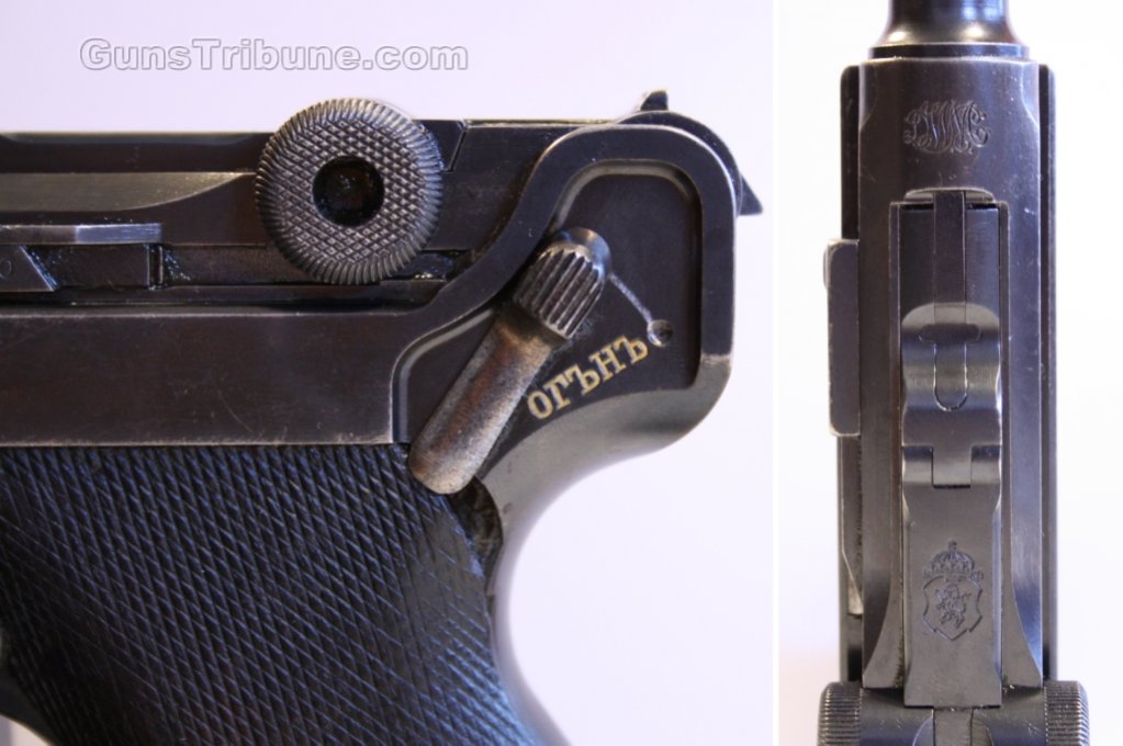

I went by one of our local gun stores this morning and they had one shooter Luger. It was heavily buffed (even the acceptance and proof stamps were virtually gone) and refinished, as well as mismatched. It had one feature that I haven't seen before--a DWM logo on the chamber, where dates are normallly found. It was slightly smaller than the logo on the toggle and was professionally done. I don't think it was engraved, as it was done as well as the toggle logo. Anyone else seen one like this?

The 1908 Bulgarian Luger has the DWM logo on the chamber, and the Bulgarian Crest on the toggle. The gun you refer to could just have a mismatched toggle, if it also has the DWM on the toggle. Did you note if the safety was Bulgarian "07bHb" instead of "Gesischert"? Did it have a sling loop on the lower back strap?
Credit GunsTribune.com for photo.

Neil, check to see if the lanyard loop is down where the stock lug would be..also a charecteristic of a Bulgarian. Too look at the extractor..German is Geladen bulgarian would be cyrillic something.
