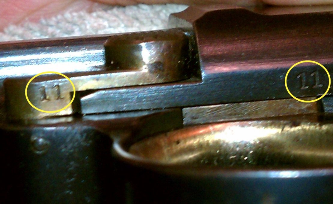

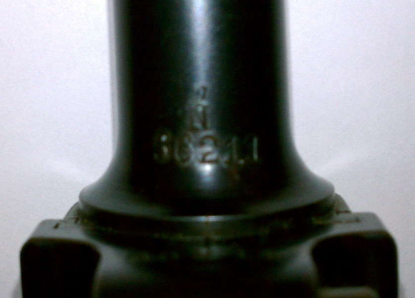

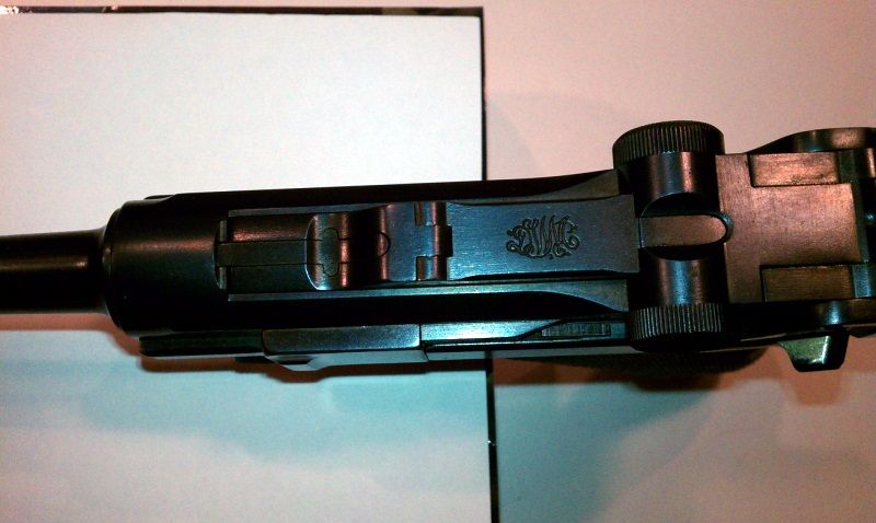

What strikes me most about this is the few markings on the pistol. The only markings on this pistol are as follows:
o The Toggle identification is DWM.
o The Serial Number is 66211 (matching) except magazine.
o Proof mark is a Crown and Letter N

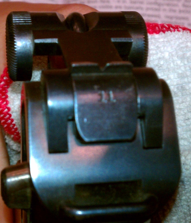

o The number 11 on the bottom of the left side of the take down lever AND bottom of the trigger side plate AND on the rear Toggle link
This appears to be a model 1906. This gun has a 4 inch barrel, chambered in 7.65 and has a grip safety.
That's about all I can tell you about it unless you have any questions I can answer.
Can anyone help me to further identify it? Or tell me how to date it? I appreciate your help.

You have a commercial contract Luger (proofed and marked for commercial sale rather than military contract sale) with serial numbers stamped in the commercial fashion made in the 1906 pattern with grip safety.
With the lighting and soft focus of your first pictures, it's hard to judge if it's refinished. Is the small toggle axle retention pin (visible on the right in your second picture) in the white or blued?
Are slightly lightened "halos" visible around the stamped serial number on the bottom of the barrel?

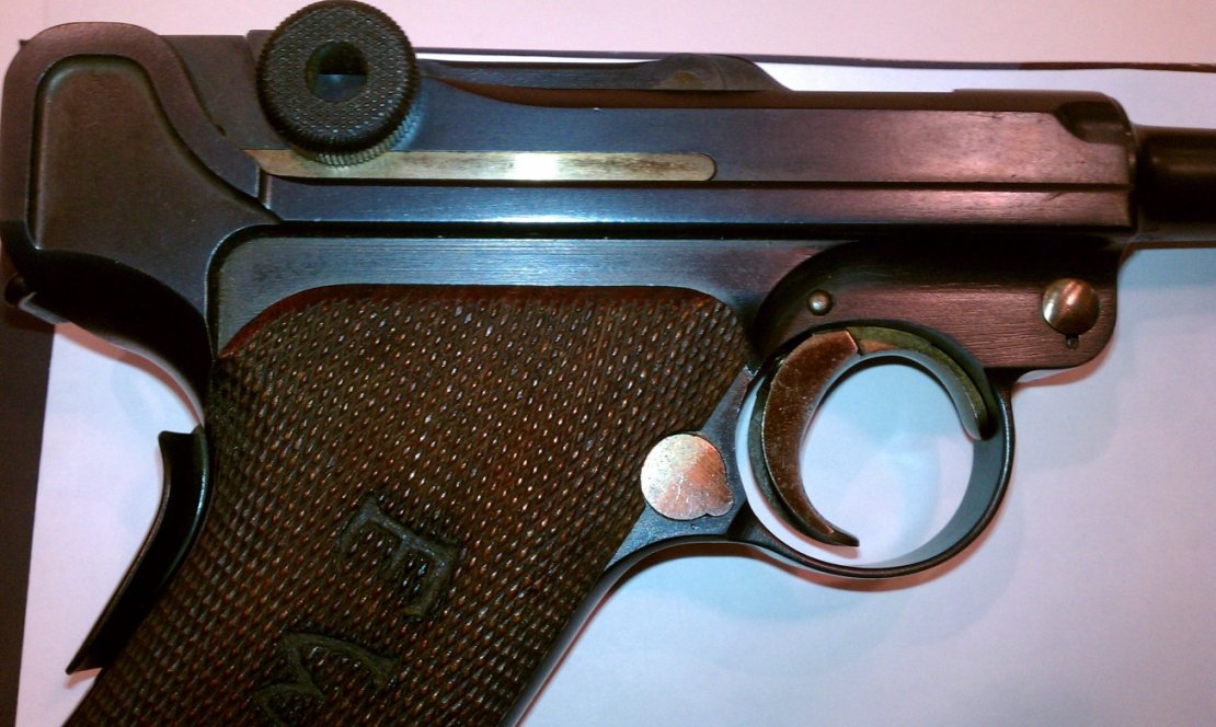

Could we see the letters that have been cut into the right grip? Is this meaningful to you (someone's initials? a company name?)?
My first impression is that this pistol may have been professionally restored.
The frame profile is that of a pistol made after 1908 (Ron Wood's type "V" from Still's "Central Powers Pistols" appendix "B"). Likely made before 1914 when contract sales were halted. Post WW-I sales started up again at s/n 73,500 (Kenyon) so it was probably made in the early 1910s.

Although I don't recall the exact thread, letters exactly like those pictured, which are burned into the grips have been discussed here before. They do have a significance but I cannot find the reference.
Unread 05-25-2012, 11:50 AM   #4
I think that this was the thread:
http://forum.lugerforum.com/showthre...&highlight=FWB
According to Dwight, the unit came into existence in March, 1919 and was disbanded in April, 1920.
"EWB" a post WW-I Bavarian Militia.

alanint, thanks for your notes on the EWB markings. We had only assumed they were a previous owners initials. I didn't think to look them up. I appreciate the heads up about them.

The toggle retention pin seems to be in the white.
I don't see any "halos" about the serial number on the bottom side of the barrel. All cuts seem to be very crisp and sharp. There is very little where on this piece, almost liiks like it was never used. No holster wear is apparent either.

I don't think its been refinished... look at the fine machining marks on the middle toggle link and the area right above the right grip...if ANY sanding or buffing at all is done before a reblue, these are rubbed away......also if you look closely, the barrel serial haloes are obvious.

I've only seen this kind of marking on military issued guns. As the family also owns an Artillery Luger I would consider as a hypothesis that the grips of both pistos had been switched in the past. Remove carefully the grips and check if there is any numbers or marks on the inner side. To add support to this idea, there are records of Artillery Lugers with such mark.
On the other hand, I learned to never say never in the collecting field: as the EWB was a militia organization it would be possible to have an originally private purchase pistol carried by one of its members and marked accordindly.
At last, but not the least, I think the gun is in original and pristine condition.

So that would just be the right grip panel ? I wouldn't have thought the left grip from an artillery would fit a grip safety gun without considerable work ?
That's correct. It would be interesting to see the inner part of both grips.
