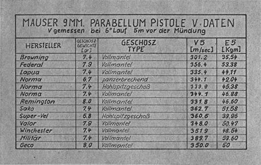

The velocity is not the main issue: overal average length, a slow burning powder, not too exotic bullet shapes and you should be good to go.
Here's an overview of velocity tests that Mauser did in the early seventies:

AH!!! "geschosz gewichte" = projectile weights!!!
Here's a helpful site - http://www.archive.org/stream/milita...mrich_djvu.txt - Military vocabulary : German-English and English-German
But back to geschosz-gewichte - is that in ounces??? What unit of weight is that??? Grams???
Unread 10-15-2010, 03:55 PM   #16
yes, bullet weight
It is the weight in grams: 8.0 Grams is approx. 124gr.

Very good! Could you correct these approximate translations? -
Vollmantel = full jacketed (?)
Panzerbrechend = armor breaking (piercing?)
Holspitzgeschoss = hollow point projectile (?)
(I know they're not correct; but the best I could do)
Unread 10-16-2010, 02:57 PM   #19
OK, I've attempted to convert Vlim's Mauser list to Yankee units...I had trouble with the 5's & 6's = i can't tell which one Mauser wrote, so I 'assumed' they were 6's...
(My apologies to all Metric & Deutsch reading peoples)
