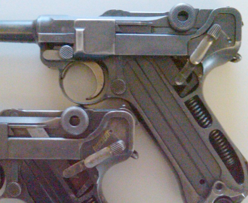

Here's a poor pic taken with my cell phone (my digital camera battery is flat ) showing the safety off (top) and on (bottom)...Good luck freeing that up...

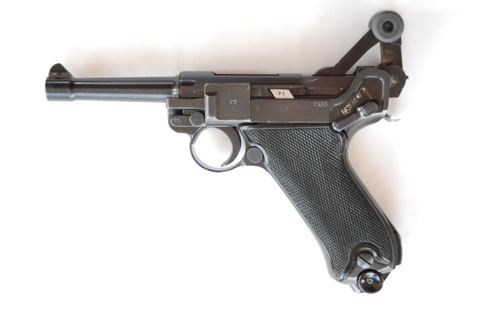

Hi Rich, This is a photo of my byf, just like the gun in question, with the safety on and the action open. Of course, if one wanted to disassemble further, the safety would have to be off, the take down lever deployed, and the trigger plate removed, as well as the magazine. This gun has a long way to go before that can be done! Regards, Norm

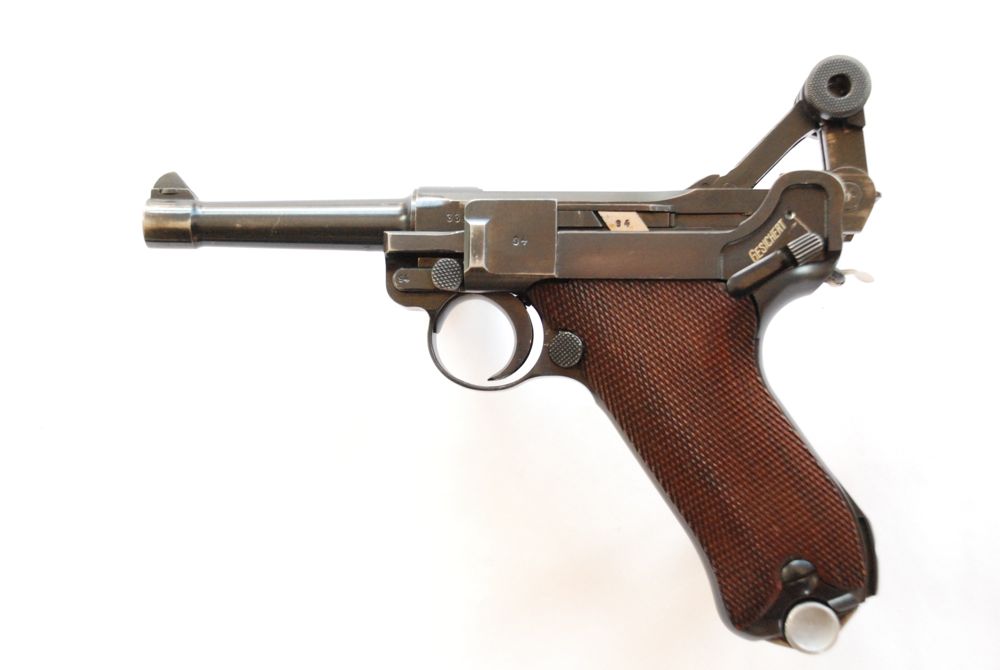

Hi Rich, me again. I can't believe you can't open the action of your 1937 S/42 when it's on safe. Here's a photo of mine. Regards, Norm
